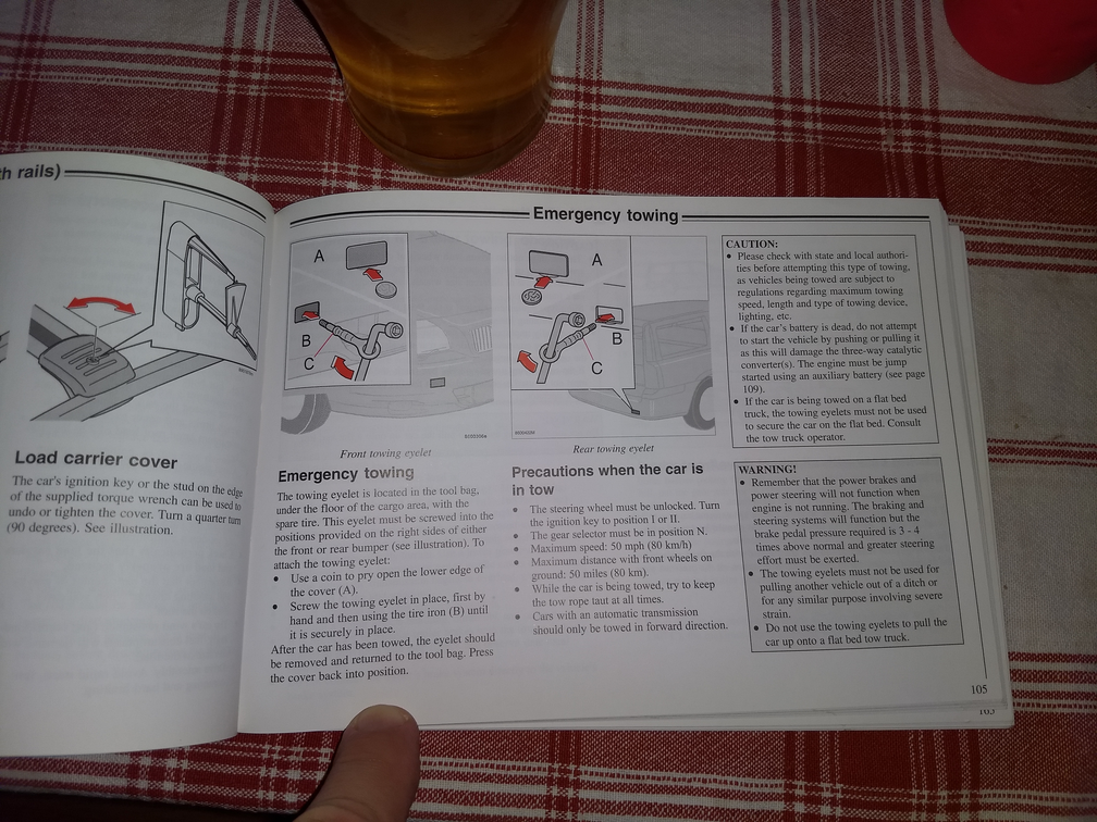

I now have my fingers crossed as I just found out they towed the car on a rope about 2km home at very low speed. Not a good idea with an automatic trans and especially with an AWD car. OOPS!
A bit late, but they now have a nice leather pouch with a 2006 S60/S60R owners handbook which I found in my 'stash'. Unfortunately 2 days too late assuming they had read it!

Even with the AWD system? Of course I no longer have the P2 handbook to see what it says here.
That though is good news.

Just found a Q&A on a Volvo AWD. It says not to tow an AWD with all wheels on the ground as you can damage the AWD system. You can tow it at a max. 45 mph with just the front wheels off the ground no further than 30 miles:
https://volvo.custhelp.com/app/answers/ ... er-vehicle

scot850 wrote: 28 Jul 2022, 16:13 Just found a Q&A on a Volvo AWD. It says not to tow an AWD with all wheels on the ground as you can damage the AWD system. You can tow it at a max. 45 mph with just the front wheels off the ground no further than 30 miles:
…or 90 mph for 15 miles incase you are in a hurry…
