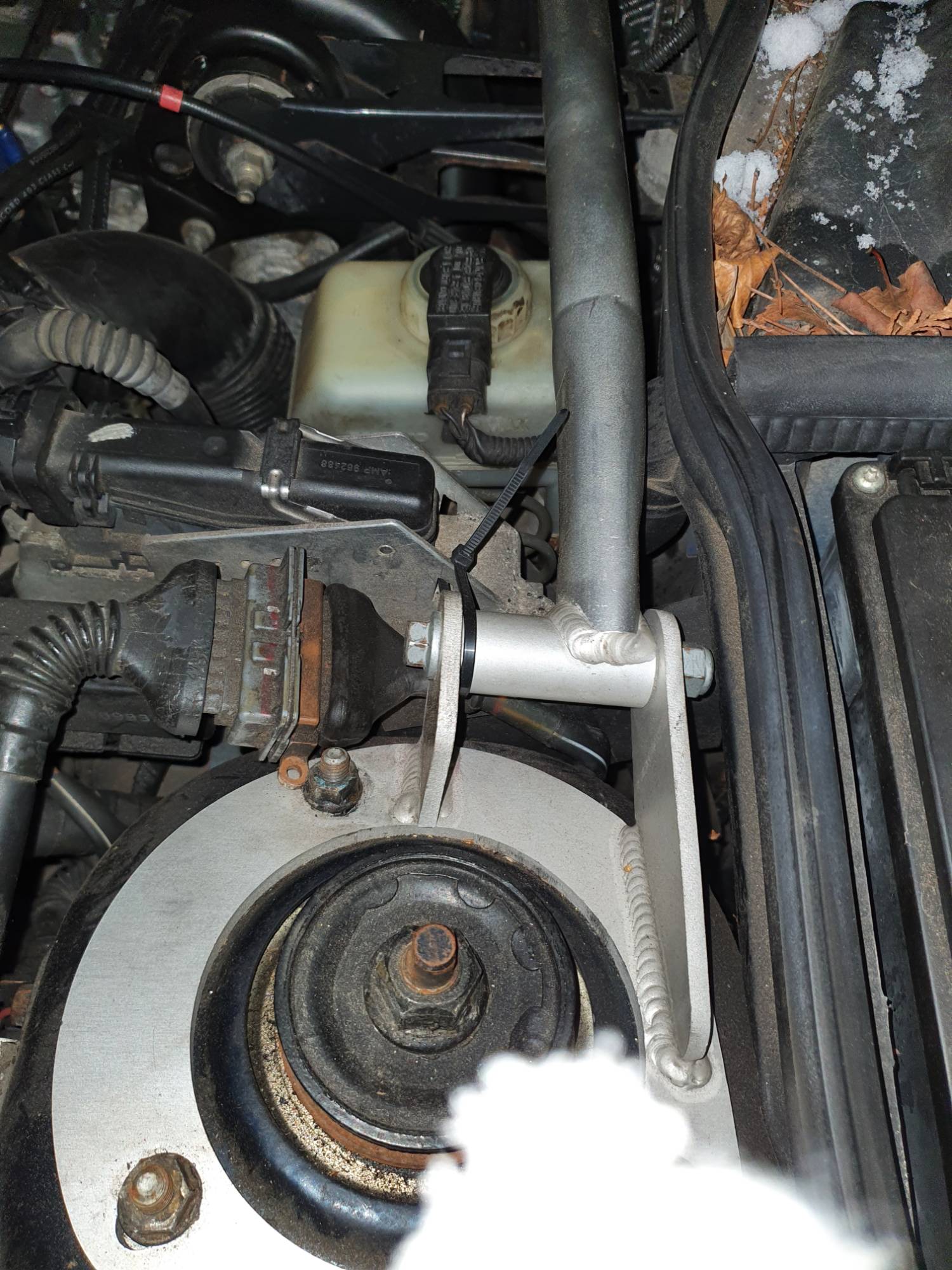

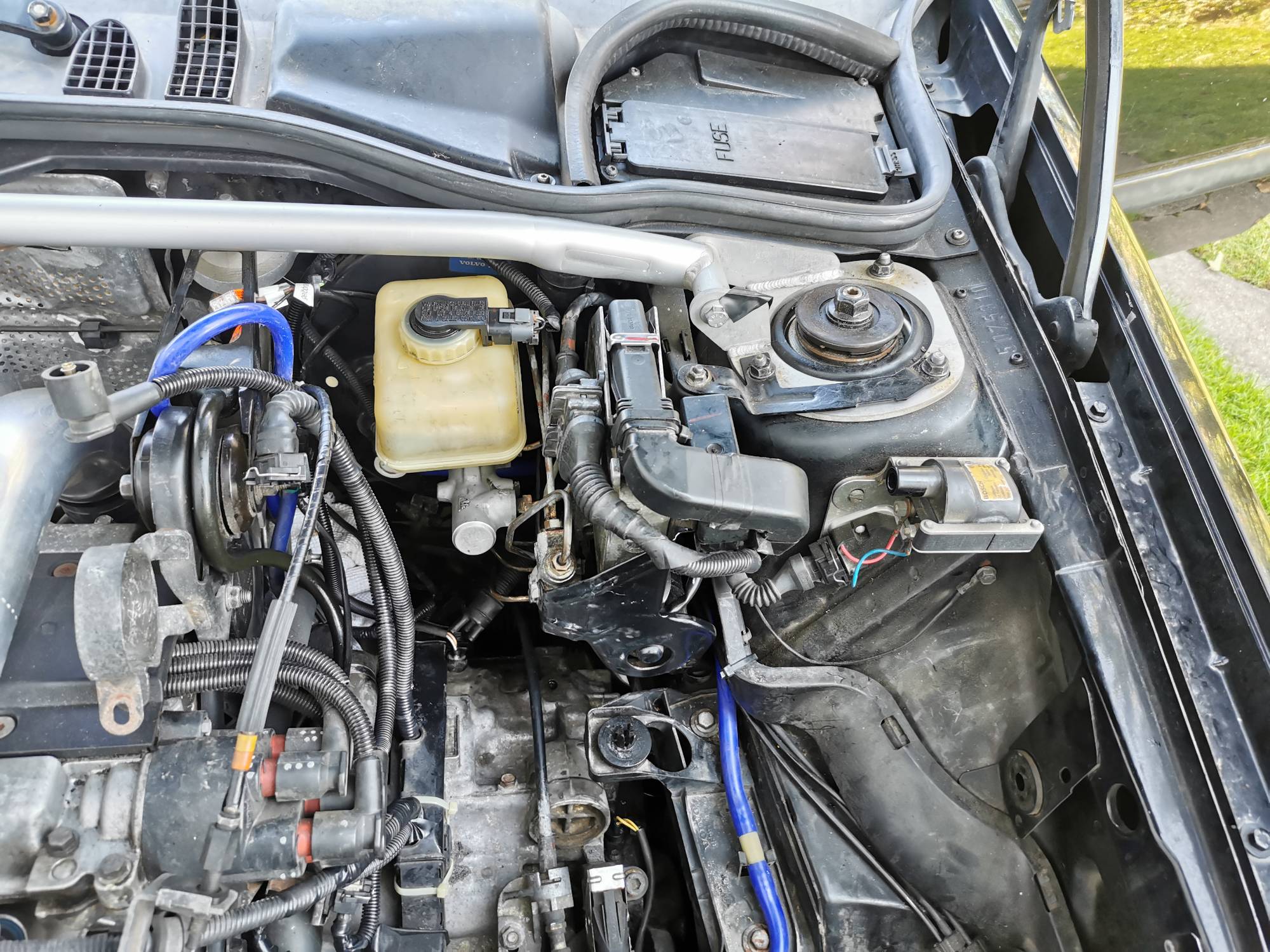

The ABS stuff looks like my '95, Here is how I did it. Also want to see what Clemens came up with
Though I am not sure if you are talking about the ABS control unit or just the connector? I had to move the connector and wire harness, but in your photo with the aftermarket bar it looks like it might not be high enough to clear the control module/computer. The volvo bar does fit over it. Don't think that you can relocate the computer easily.
download/file.php?mode=view&id=78836

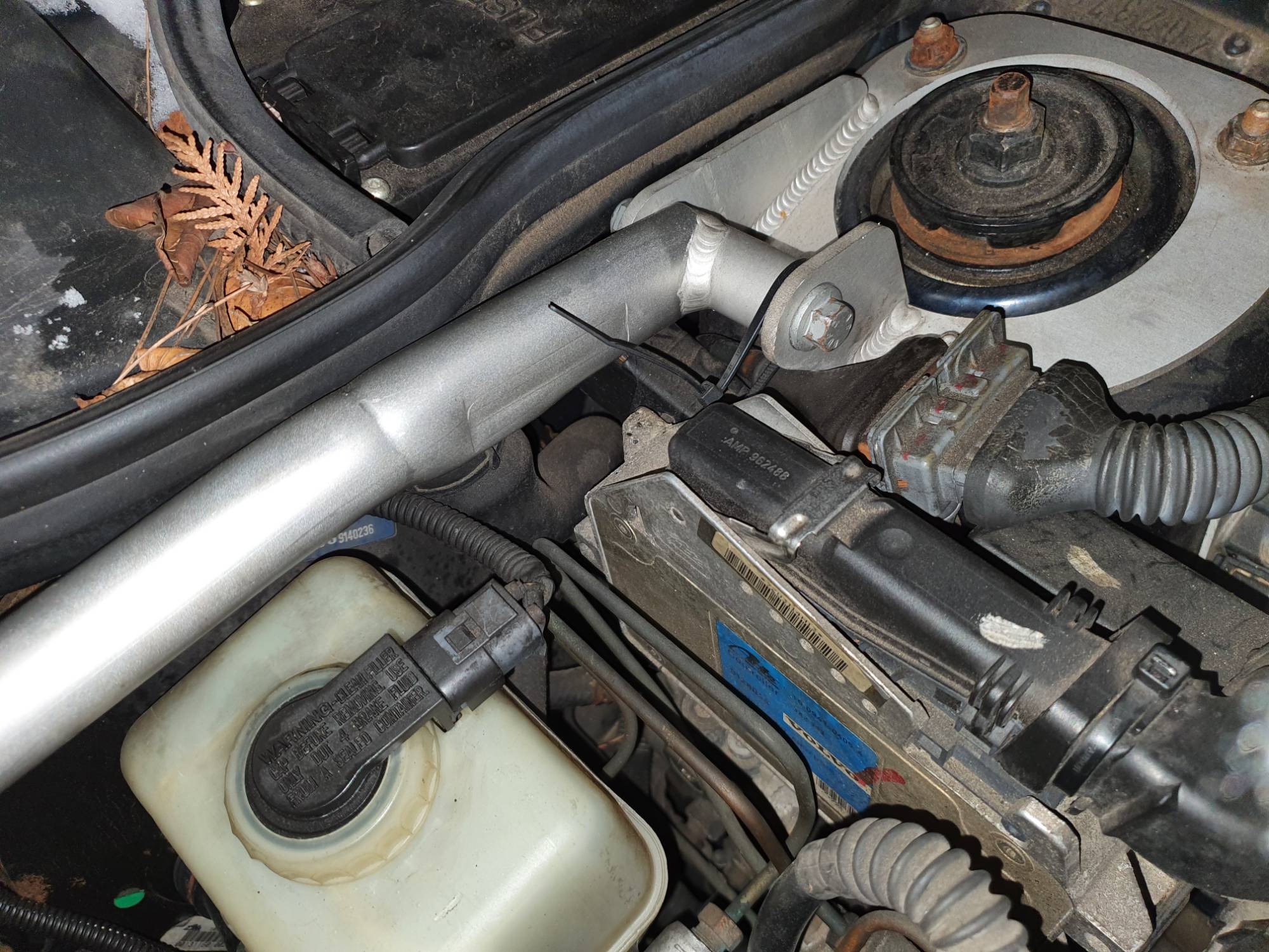

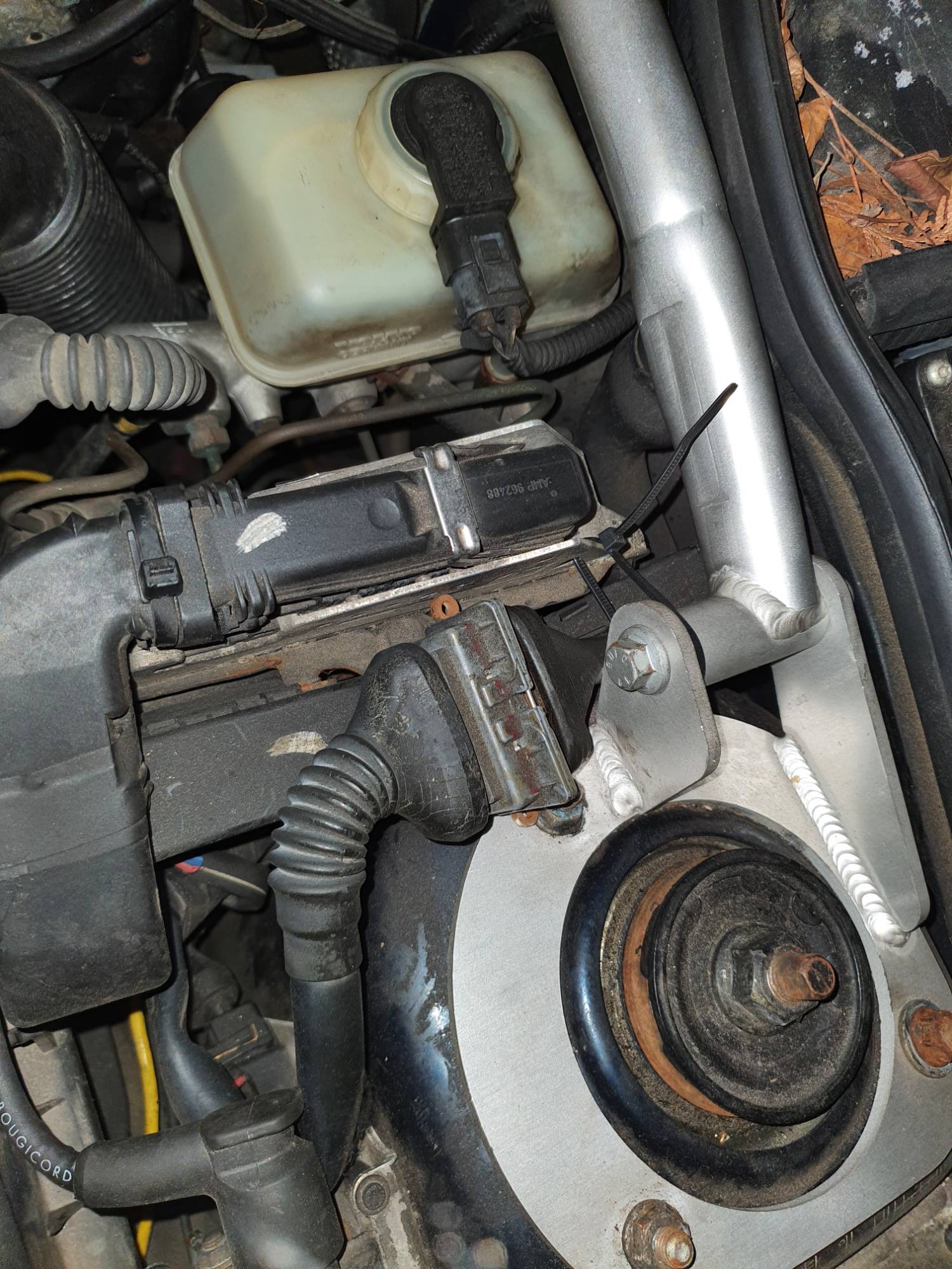

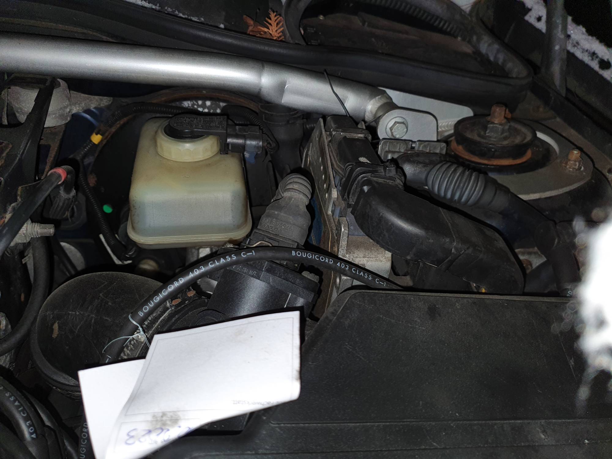

Tomorrow morning turned into tonight.

- Clemens
- Posts: 1954
- Joined: 03 Sep 2015, 12:34
- Location: Austria
- Has thanked: 498 times
- Been thanked: 228 times
The key is to remove the module upper brace and use zipties instead. One year and a few track days later everything seems to be fine

hausmeister wrote: 28 Jan 2023, 02:08 The ABS stuff looks like my '95, Here is how I did it. Also want to see what Clemens came up with
Thank you both much for sharing!! Looks like y’all both went similar routes of, well, re-routing.Clemens wrote: 28 Jan 2023, 12:34 The key is to remove the module upper brace and use zipties instead. One year and a few track days later everything seems to be fine
This makes me hopeful I can make mine work if I can get that tower pushed back over. I’m glad now that I didn’t return it, just yet.
