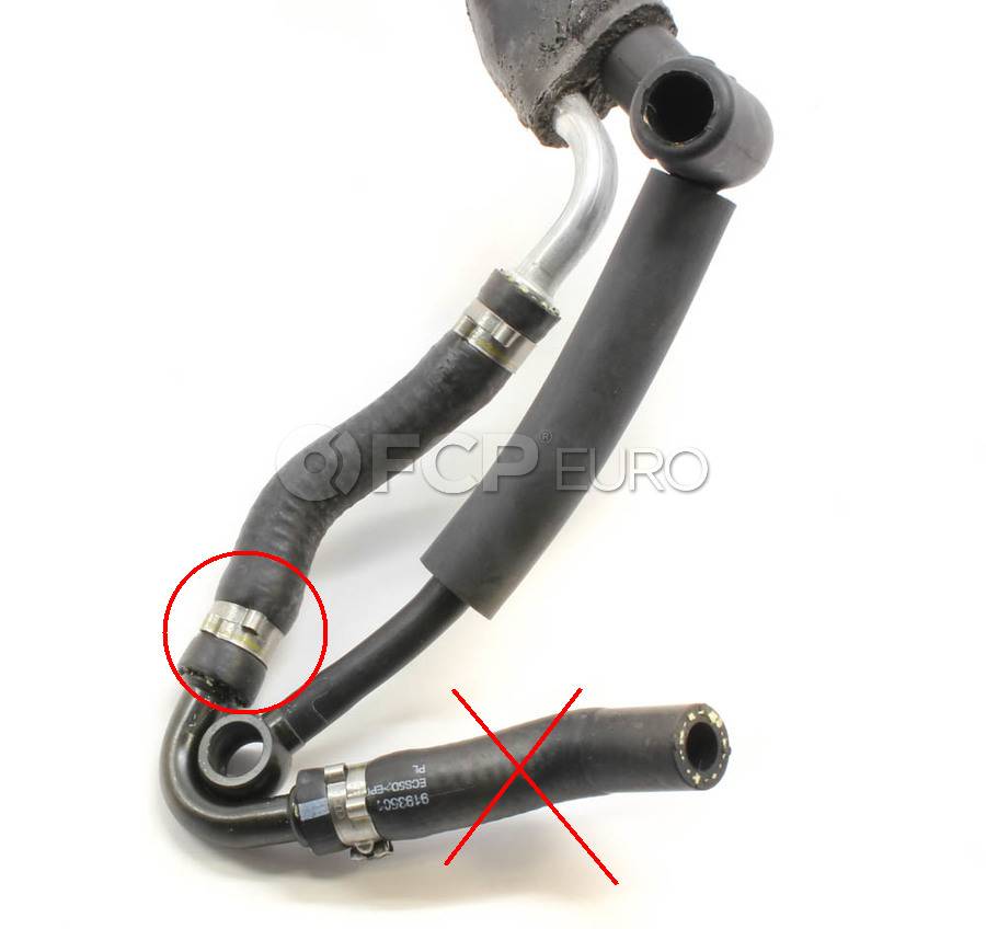

I was able to get a borescope and locate the leak - it is coming from the area of the clamp indicated by the circle in this photo:
It appears that the pressure on the hose has caused the clamp to wear through it and begin leaking. The hose came as part of an aftermarket PCV kit from IPD Volvo (not Genuine Volvo) which I've already had to replace several hoses on. I had already replaced the other hose marked with an X a year or so ago. That one I was able to do in place, but I don't think I'd be able to do this one that way. I might actually still have some hose left from the replacement I did on the X hose, and I've got plenty of Oetiker clamps. The biggest hassle would be getting access. Either the alternator has to come out to get to it from the side (and I've never been able to get the alternator out without at least taking the power steering pump out), or the intake manifold has to come out to get to it from the top. Any other ideas?
And of course there's the possibility that after fixing this, the next thing starts to leak... :evil:

I would pull the manifold amd get genuine Volvo parts there. It needs good EDPM rubber to live in that environment. My original on my T5 went 14 years /150k miles. Life is too short for crappy rubber parts

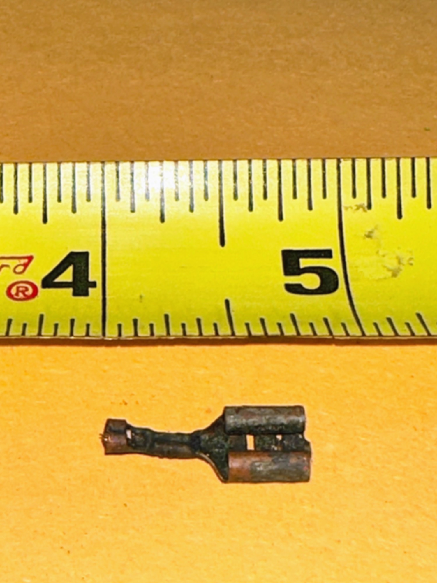

Here’s the connector for the exciter wire. The wire got sheared off right at the base and the remainders of the end of the wire are still crimped inside. It doesn’t seem like it’s possible to reuse it. Is this type of connector commonly available, and if so, where would I get it?

Those connectors are commonly available. They have them on amazon. Im not sure what size it is exactly, so maybe you can get one of those kits that have lots of them.

any parts store sells spade connectors, gold plated is best or smother with dialectric grease.
cut the wire back to good copper and crimp a shrink sleeve with new wire.
Without that connection the battery will slowly run down.

Hardware store or even a big box home store like HomeDespot or LoweQuality in the electrical section
