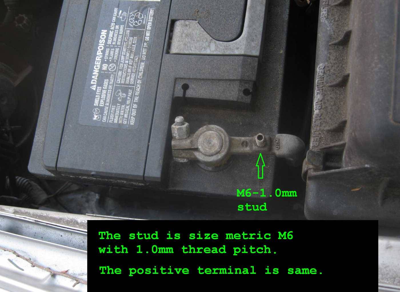

Thanks, but i am not sure what the kidney fuse box bolt is or where it is.
Before that advice i planned to bolt wires right to the lead connectors on the battery, and as i remove each one put a glove and rubber band around so neither terminal can touch anything while the battery is being removed and installed.
Did you see the bolts on my Volvo connectors for the battery? They are not the bolts you use to tighten the terminals to the battery, they are different bolts that stick up from the terminals. I used them to bolt wires from the solar panel directly to the battery terminals with only a fuse inline. I was thinking maybe that is what they are there for? They must be for something.
I'll post another pic of the battery terminals on this car.
I like your idea too though.

Here is the pic of one of the studs on the battery terminals.
Easy to bolt wire right to those studs.

Pin 16 on the OBD should work for 12Vnto battery
Use pin 4 or 5 for ground
