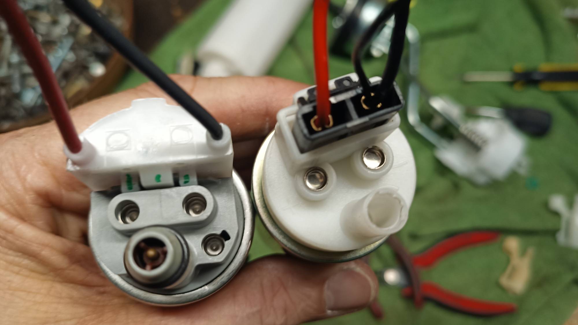

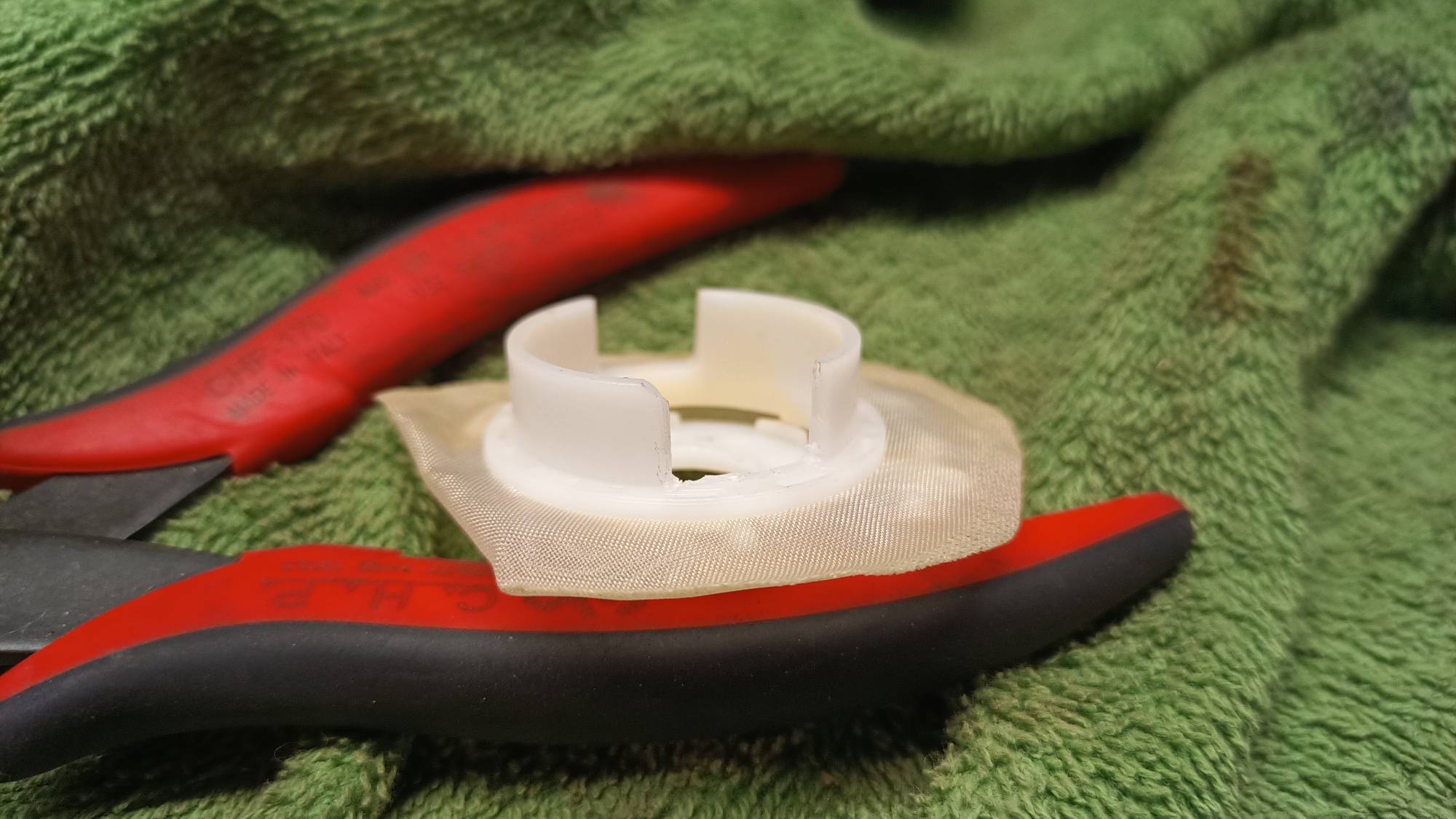

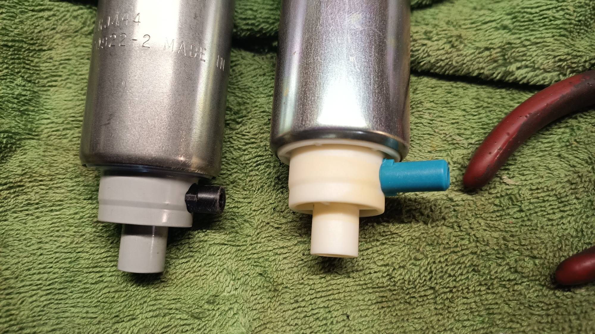

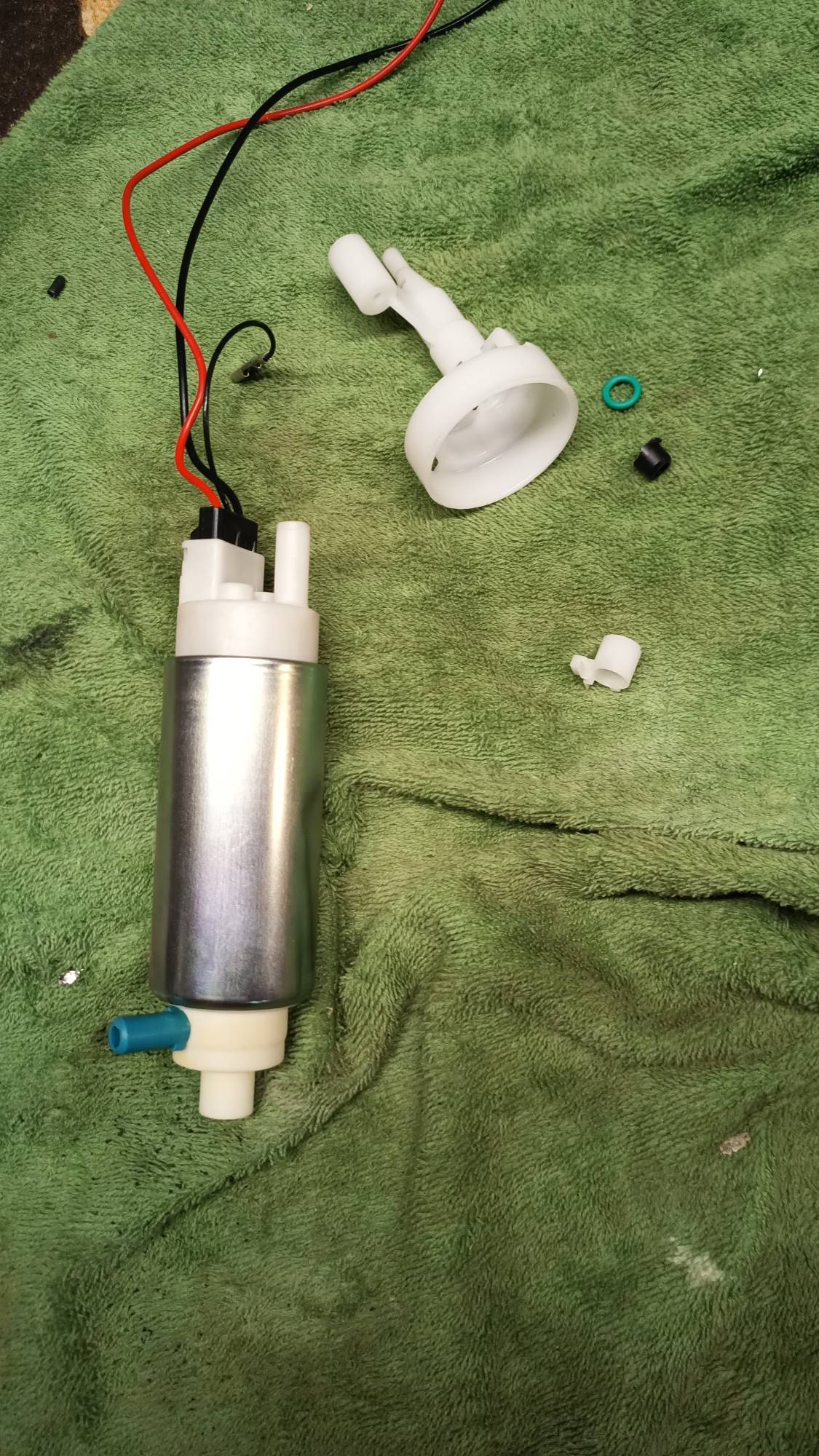

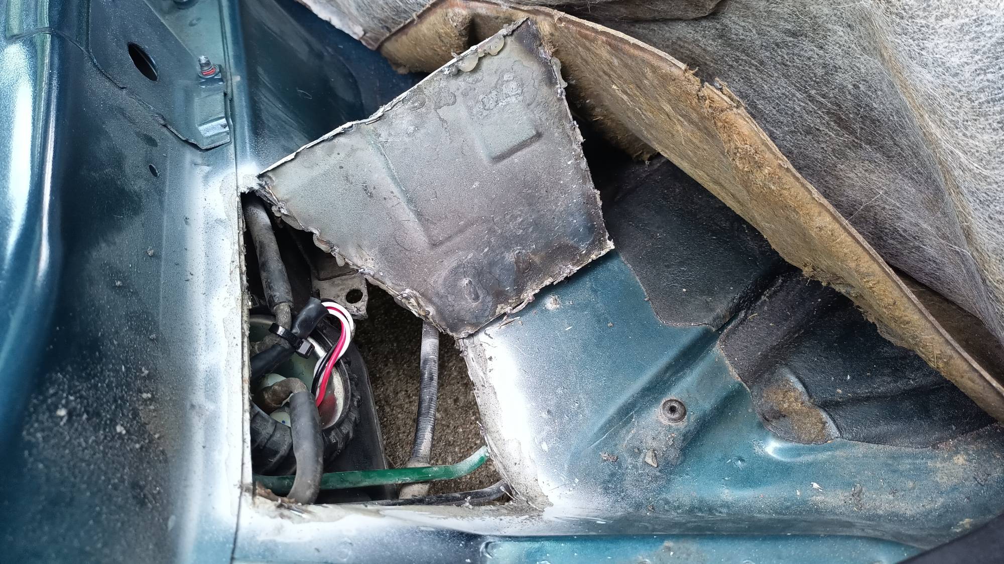

So I dug into this fuel pump thing..again. I never did check the pressure / bleed of the Pro Parts pump.
In short, to fit the new Walbro pump in the Pro Parts housing, some modifications are required.
The Hole of Shame: I had already cut this open, replaced the pump, and tacked this thing shut (sealing the rest with silicone) once. Disassembling the Pro Parts pump: Walbro pump on left. Note that the side inlet on the bottom is clocked 180deg out from the PP pump. This required cutting a slot opposite the original on the inside "sock". No big deal. Once I sat the pump in the housing, it became apparent that the bottom inlet facing the other way was a problem. I had to shorten it a bit so it wouldn't hit the side of the housing. I trimmed around 1/8" off the length. This inlet doesn't seem critical, as most fuel will come from the bottom sock. Now the fun begins. Note how much longer the Walbro pump is compared to the PP. The Walbro top assembly with the "nozzle" can be removed from the pump. I transferred the o-ring, nozzle, and split sleeve from the PP pump. Note that the PP pump has a space inbetween the two terminals. The PP nozzle fits in here. I had to trim a bit off the bottom of the nozzle to fit on the pump. (final assembly not pictured, oops) Leftover parts: Junk pump, Walbro nozzle, O-ring, sleeve, and just the tip of the bottom inlet. When placing the nozzle on the pump outlet, just make sure the sleeve doesn't push downwards. Now the unit should snap back together.
The Walbro electrical connectors were funky, so I just soldered and shrink-wrapped the wires to the inside terminals.
Upon re-assembly and first test, I thought the pump wasn't working, but it turns out the Walbro pump is whisper quiet and the tired ol' 5-cylinder fired right up.
The downside: the pump is so quiet that now I can hear all the other disconcerting noises the car makes. What was that grinding noise?!

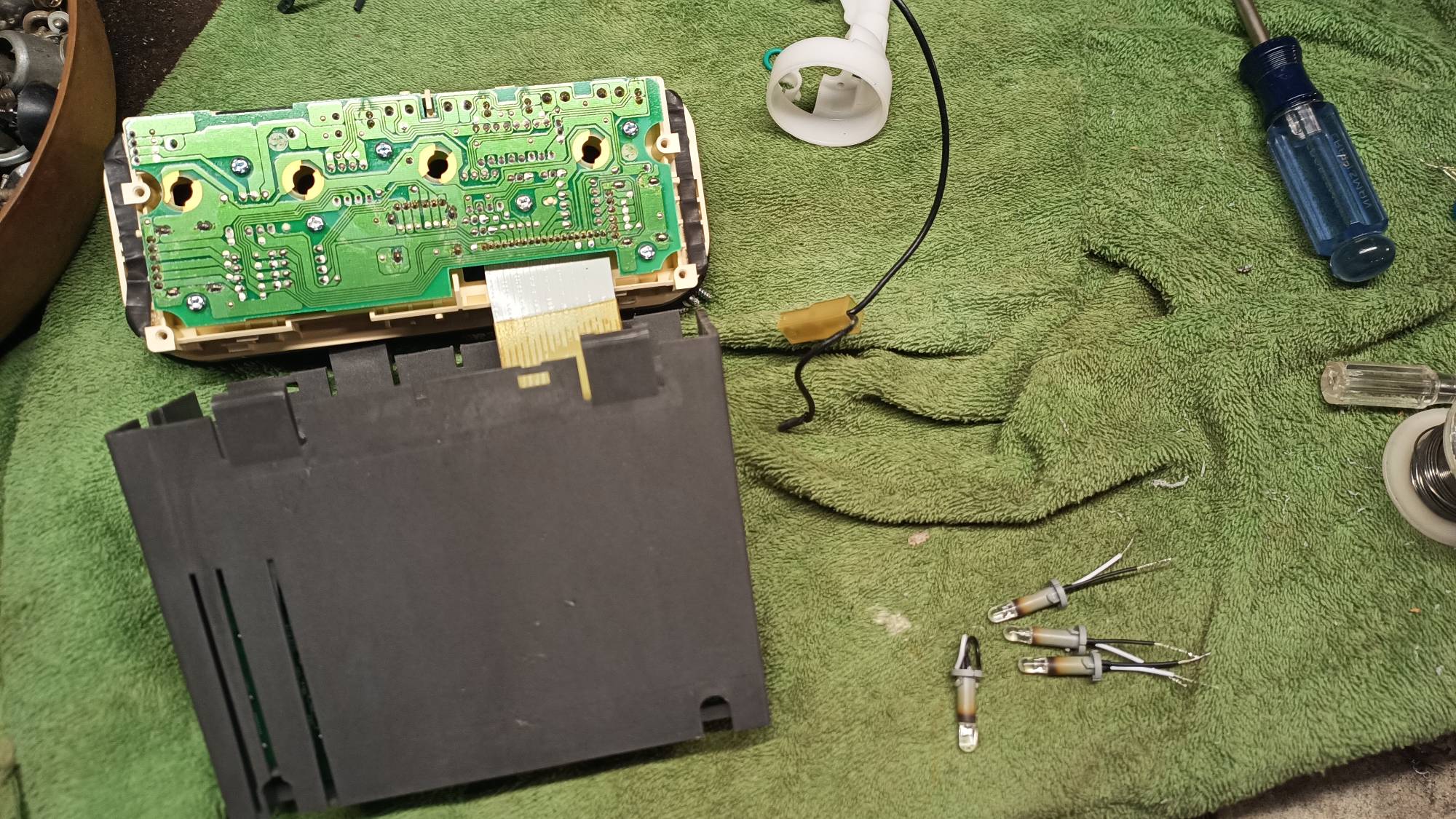

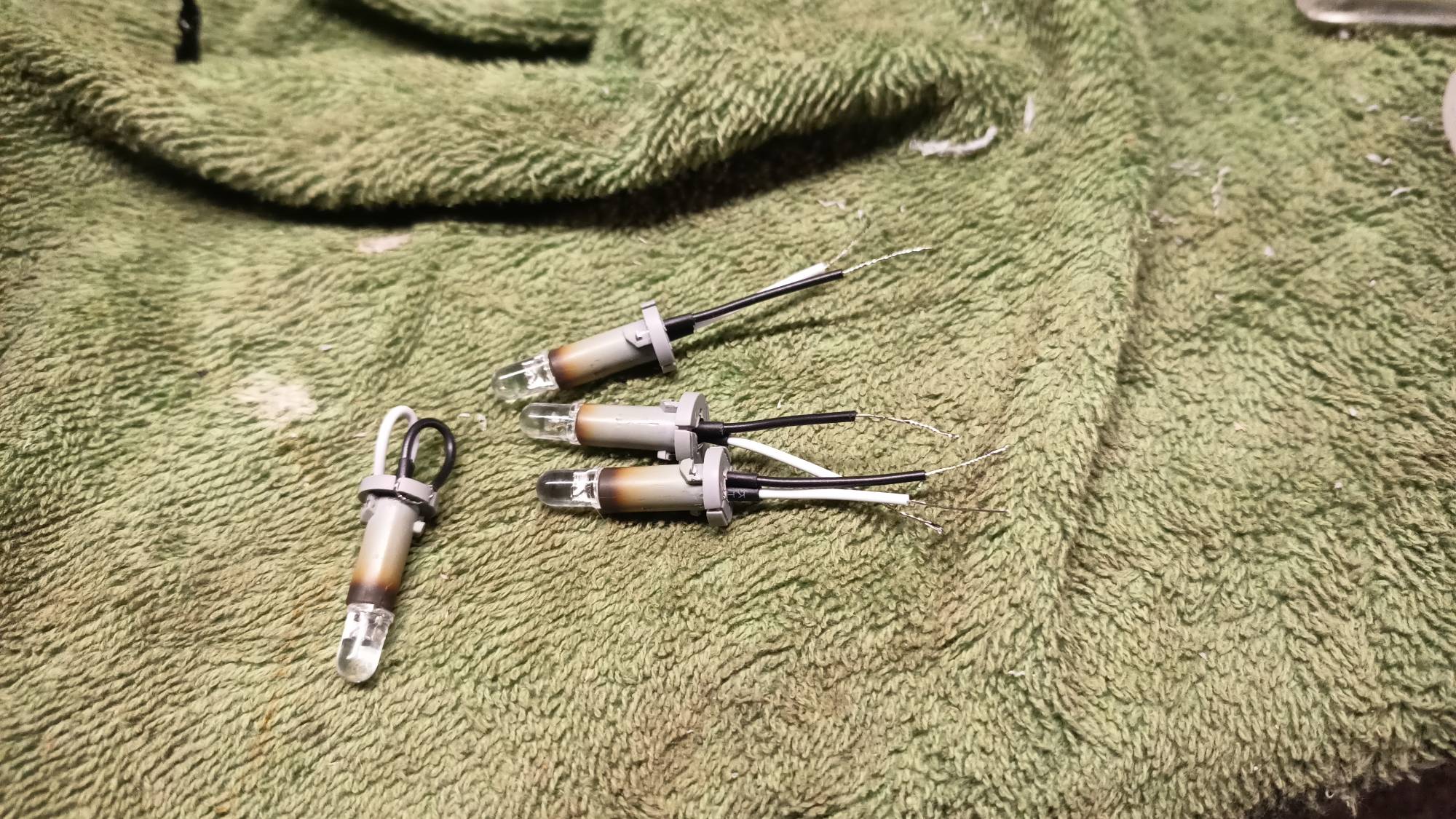

Bonus content:
LED conversion for the climate controls: The are cool white with a built-in resistor for 12V operation. I drilled the center of the bulb holders out to pass the wires though, stripped & tinned the wires and wrapped them around the holder in the slots for the original wires. They're nice and bright, and dim nicely with the controls.
Next up is the same deal for the shift indicator light.
