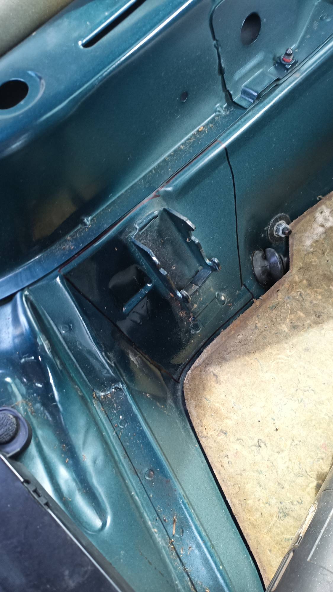

I hacked a hole to put in the new fuel pump.

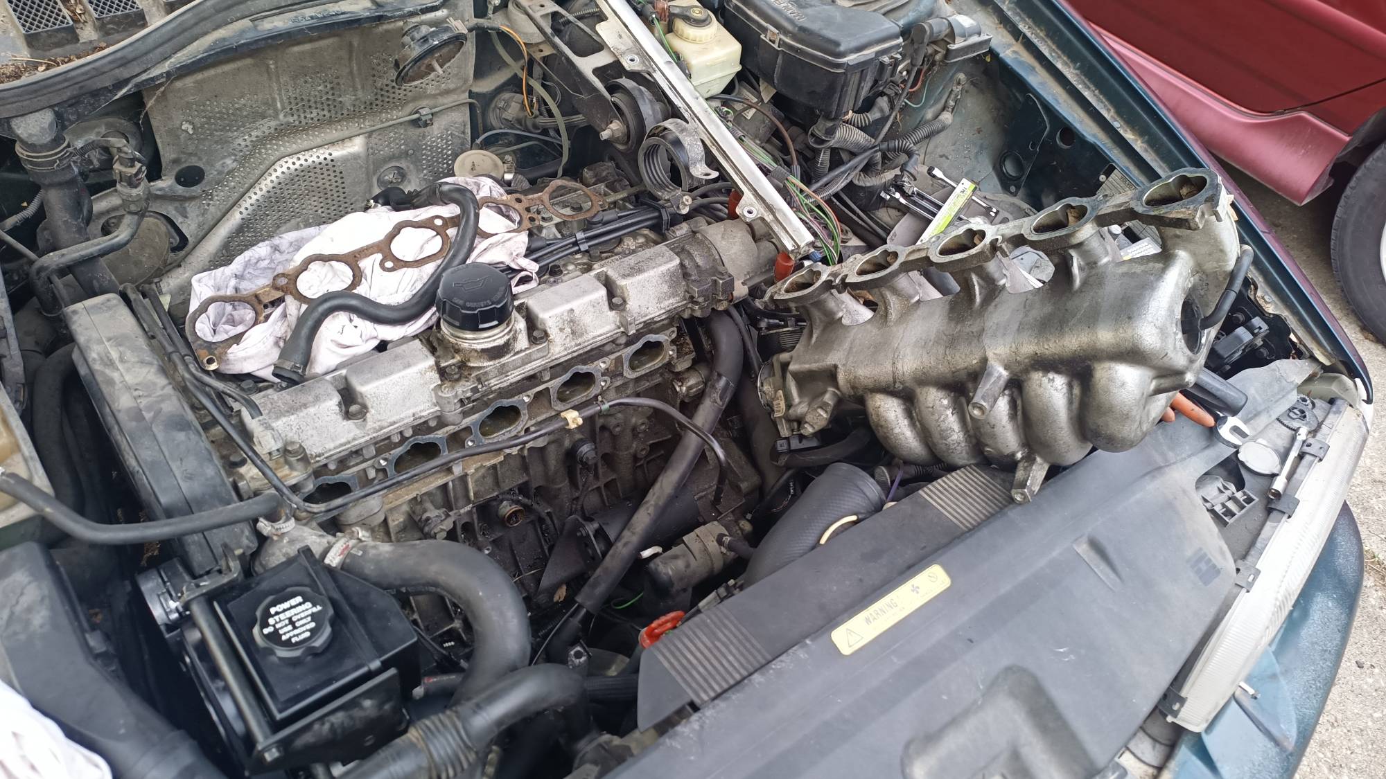

It was smoking badly so I did the ol' PCV service.
A now familiar sight for my neighbors.

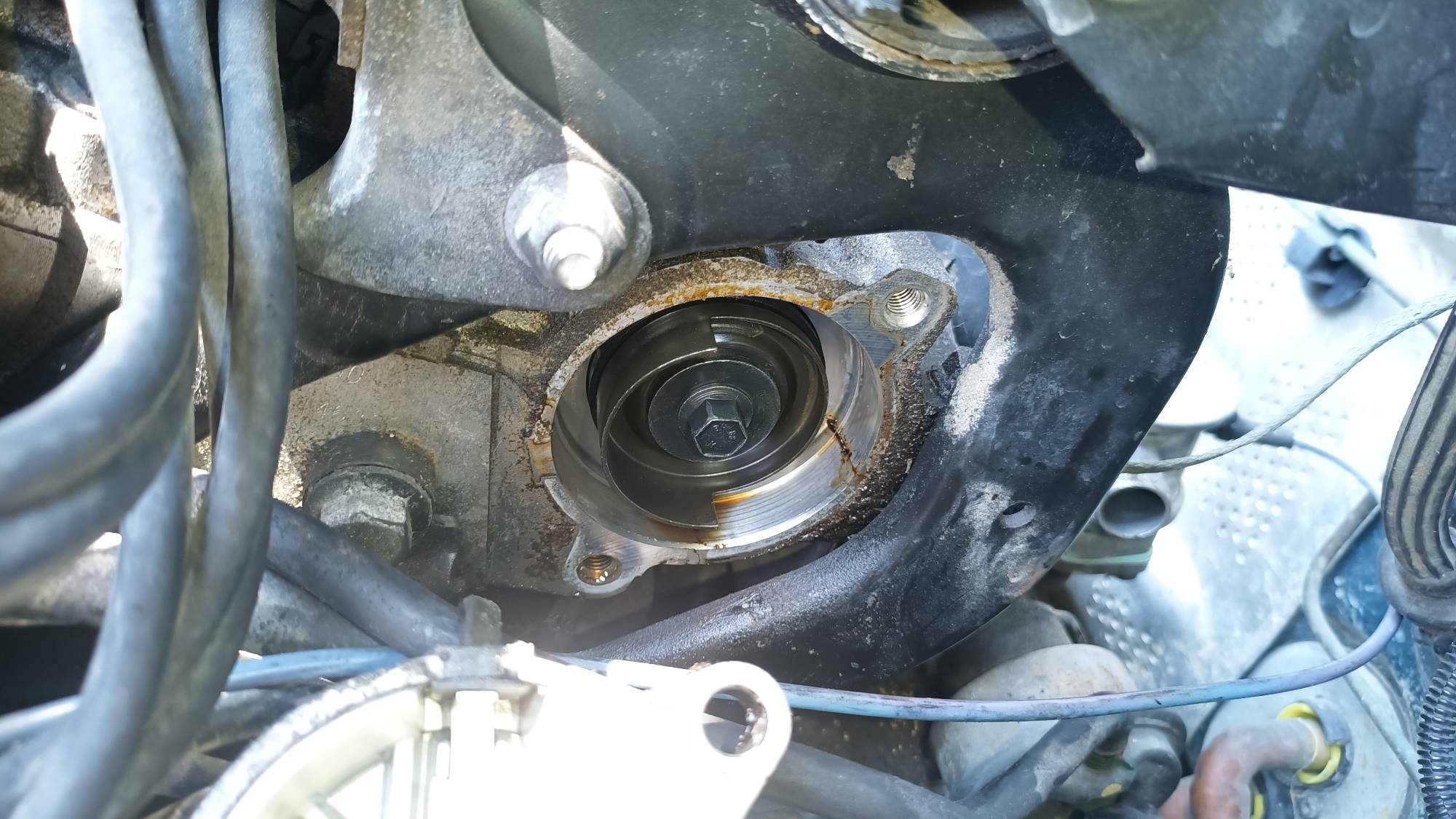

Got the power steering pump replaced, along with new a new tensioner.

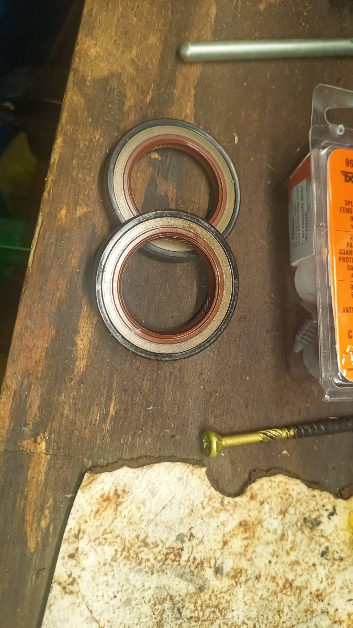

Put a few miles on it, and it started belching oil everywhere. These were the culprit:
They were so rotten they basically had already uninstalled themselves.

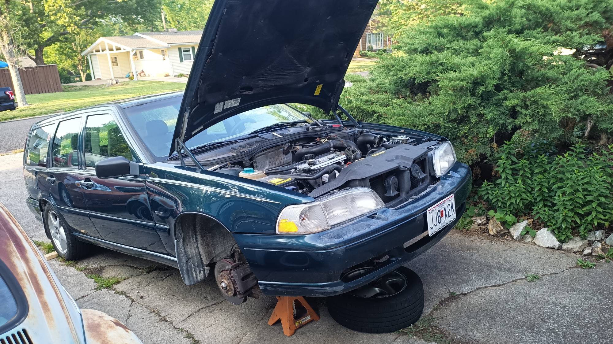

Both parking brake cables are broken. The brakes were making a horrible noise, so I "deleted" the parking brakes for now. Fixed!
As it sits right now. I got some new shoes, and traded wheels with a friend:
