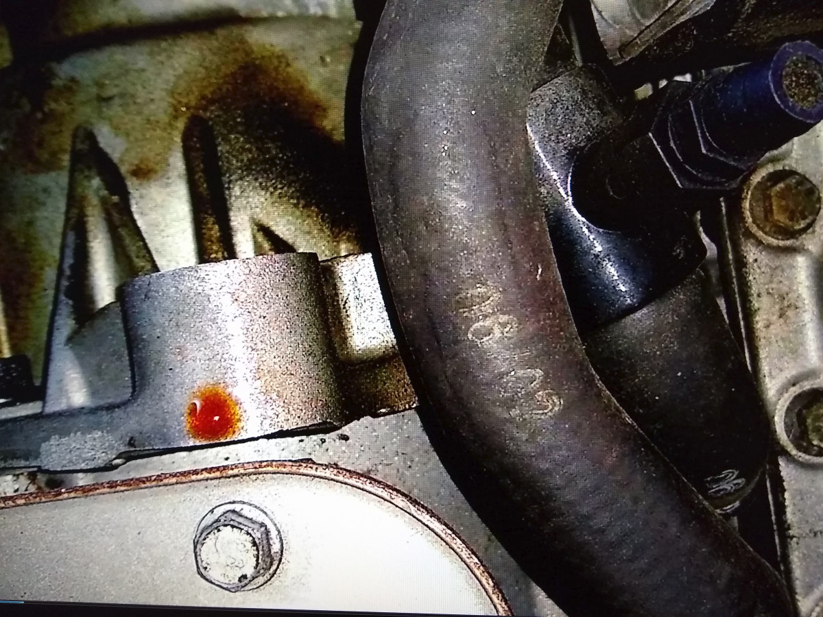

Try the ATP AT-205 if you think the leak is from a rubberized type of seal. After pouring the entire bottle in the 03 S80 T6 transmission I realized there was no drip the following oil change. That drip always migrates down the underside of the car during driving and never leaves a drop in the driveway so tend to forget about it.
That seal in the After photo seams be have been rejuvenated a bit. Is for the engine also.
ATP Automotive AT-205 Re-Seal Stops Leaks, 8 Ounce Bottle
https://www.amazon.com/ATP-AT-205-Re-Se ... VW1LM?th=1
03 S80 T6 Mystery Leak Transmission AT205 Fix Before.png (1.82 MiB) Viewed 104 times
03 S80 T6 Mystery Leak Transmission AT205 Fix After.png (1.72 MiB) Viewed 104 times
