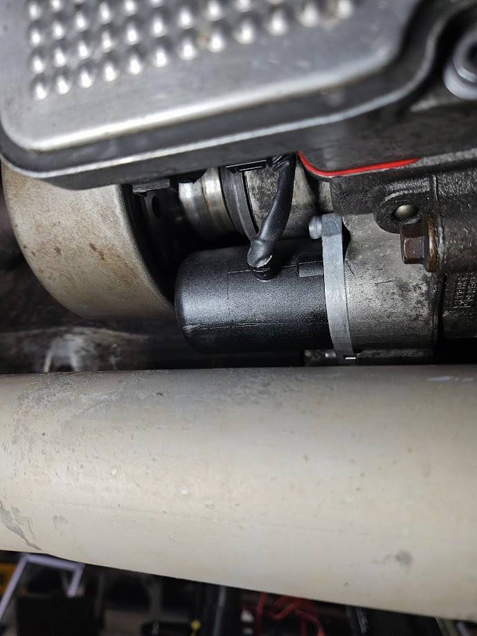

To me it looks like someone ran a long bolt through one of flange's holes and damaged the pump.XC70Rider wrote: 25 Jan 2024, 09:07 It does look that way. It might of got damaged when I removed the flange nut with an air impact gun. I didn't secure the flange while loosening the nut.

When I first installed the flange I replaced the seal behind it. I didn't insert it fully so oil was leaking. With limited time back then I took it to an Indy Shop to replace that seal again. That was nearly 5 years ago. I'm surprised it lasted this long.vtl wrote: 25 Jan 2024, 09:08To me it looks like someone ran a long bolt through one of flange's holes and damaged the pump.XC70Rider wrote: 25 Jan 2024, 09:07 It does look that way. It might of got damaged when I removed the flange nut with an air impact gun. I didn't secure the flange while loosening the nut.

Two things I do not want to see in life: a neighbor's dog pooping on my lawn, where my own kids and their friends play, and a clueless indy wrecking my car.XC70Rider wrote: 25 Jan 2024, 09:24 When I first installed the flange I replaced the seal behind it. I didn't insert it fully so oil was leaking. With limited time back then I took it to an Indy Shop to replace that seal again. That was nearly 5 years ago. I'm surprised it lasted this long.

It doesn’t look like a recent damage event to the pump as evidenced by the oily dirt around it. It looks like someone was trying to pry the flange off and using the pump as leverage.

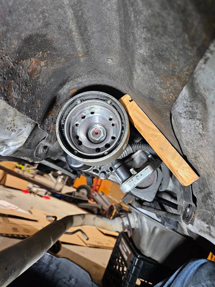

With it being on top of the casing they most likely put something through the flange hole while loosening the nut. Glad I no longer live near that Indy Shop.Blacklab467 wrote: 25 Jan 2024, 09:41 It doesn’t look like a recent damage event to the pump as evidenced by the oily dirt around it. It looks like someone was trying to pry the flange off and using the pump as leverage.
When I tighten the flange bolt I'll put a piece a wood on top of it to secure it.
UPDATE: Using a 3/4" piece of scrap wood did the job. Just made sure it was set firmly so it wouldn't go flying around and damage the DEM.
