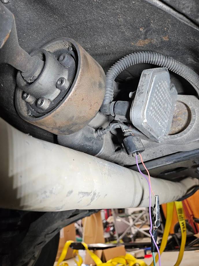

The Haldex AOC oil pump finally died at 184,300 miles. I could feel the slower acceleration and hill climbing so I scanned her this afternoon and got code DEM-0006. I raised her up and applied 12V directly to the pump and got nothing.
I have changed the oil three times, replaced the filter twice, and cleaned the pump but they still don't last forever. I just ordered the Borg Warner oil pump, Volvo Haldex fluid, and Volvo AOC filter kit from FCPEURO. When the parts arrive I'll post some pictures and give results.
I replaced the CV joints on the driveshaft and installed a new AOC flange 5 years ago. Dropping the exhaust, removing the driveshaft and removing the flange, pump & filter won't be a struggle.
I do have a rebuilt kit for the oil pump. I'll try to throw on the new brushes and bearings then keep it for a backup.
oil pump 12V test.jpg (108.23 KiB) Viewed 3723 times
