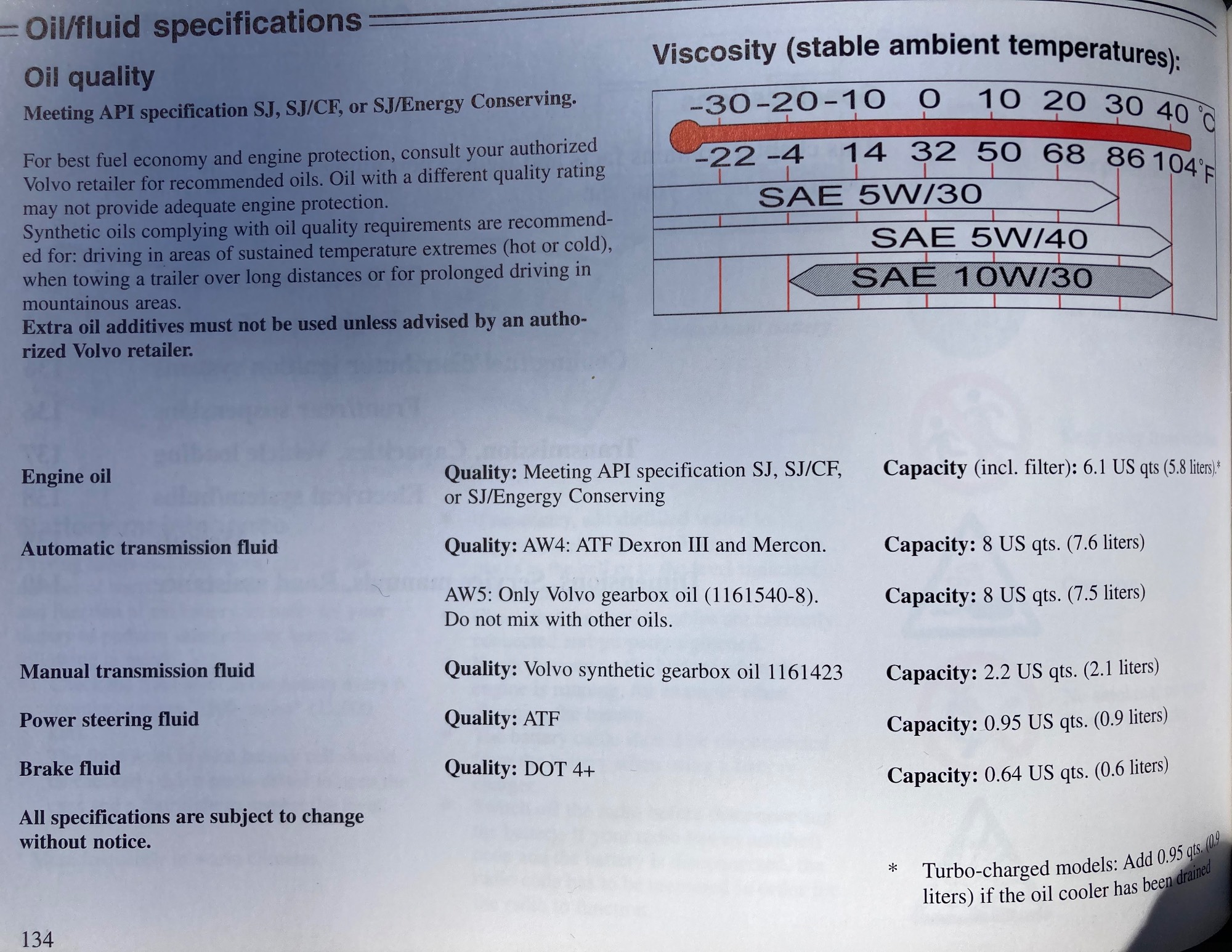

Not according to Volvo. 99, 00 P80 says “ATF” and does not require Pentosin. I believe the P2 manuals say the same, but I don’t have one handy to verify that. If anything, this would imply DexIII (or even Mercon) as that is what is recommended for the AT.V50M66 wrote: 06 Jul 2024, 12:58 Wow, lots of bad advice in this thread.
-98 uses Dexron III/Mercon ATF.
99+ uses either Pentosin CHF11S or CHF202.
This change is pump dependent, not rack dependent. You can use either fluid with either a SMI or TRW replacement rack so long as your fluid selection matches the pump
Look, Pentosin is a hydraulic fluid. It’s not mother’s milk, ambrosia, or any special kryptonite-infused magic fluid. There are mutliple fluids that do the same exact thing - and usually better. Pentosin does nothing special with regard to the pump or rack action that other fluids cannot accomplish - and again usually at much lower cost and superior performance.
To take advantage of the latest chemistry, I use an ester-oil based PSF (Lubegard PSF) or I used DexIII and fortify it with an ester additive. Very easy.
2000 MY manual:
