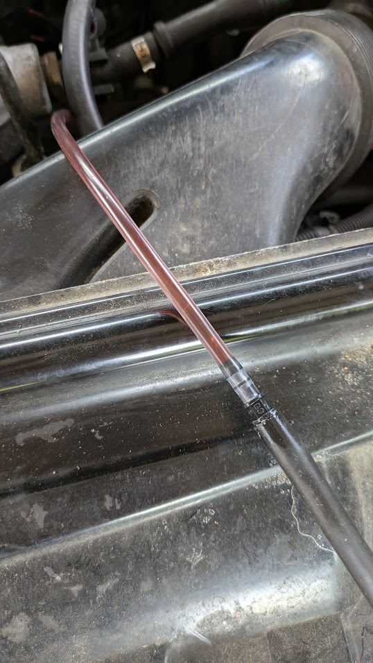

Not sure who needs to read this or who might find this useful, but I have used a pump such as the one in the image to drain and fill oil to the precise requirement via the dip stick. Well mine was 200ml not 500cc but nevertheless.
The reason it works is because there is a rubber part on the bendable hose that makes a perfect airtight seal around the dipstick tube allowing the negative pressure in the pump to draw old oil in.

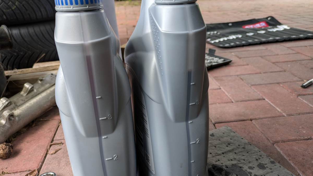

We did the first drain and refill on Friday on a transmission that has ~300k on it and had fluid changes before, but the ATF was quite dark already and it didn't always shift nicely. No codes or other issues though.
The old ATF: We drained about 3.9L of ATF and filled it up with Ravenol ATF T-IV Fluid, as it was praised in a German Volvo forum to work as good as the original ATF if not better.
And in fact, the shifts got much smoother already. We'll do the next cycle soon and I'll report back.

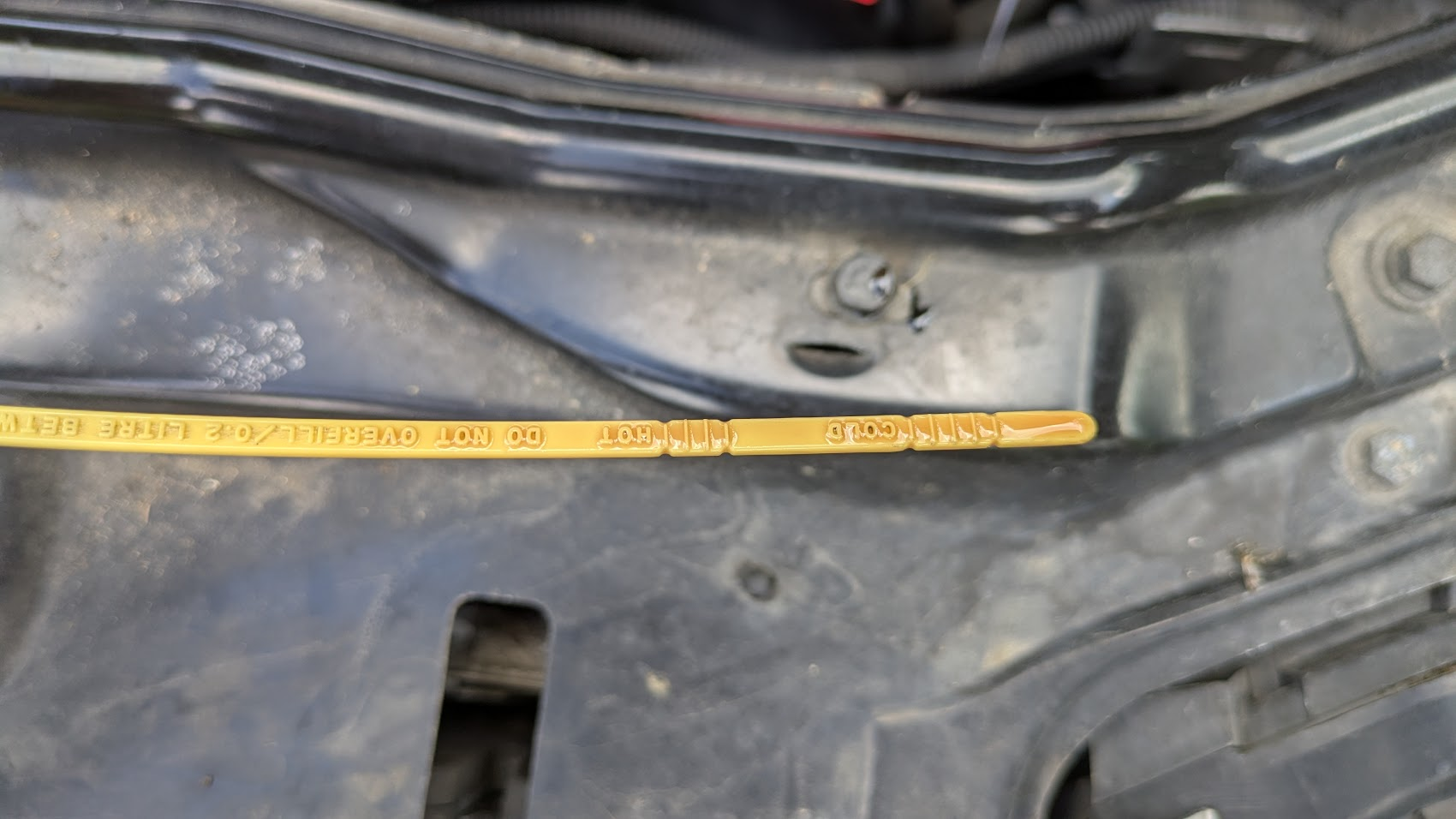

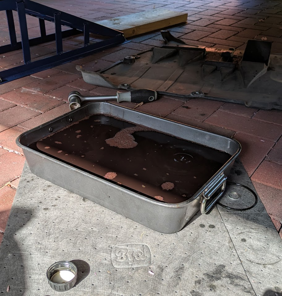

The car drove abour ~1600km now after the first drain and refill and we did the second round.
After the second drain, the fluid was still rather dark: The gearbox ended up to be overfilled because I added 4L when ~3.8L came out (and that twice). Furthermore it had to be overfilled to begin with, because I sucked 800ml out and it was still a bit past the MAX line. For the time being, it will stay a bit overfilled. We still have some oil for a third round, so I'll just fill in less next time.
The shifting did improve a bit more after the second drain&fill and we resetted the oil change mileage counter in the TCM. That did not really seem to have an influence, but we decided not to delete the adaptation values. It shifts nicely, so there is probably no need to.
All in all, the results are very good and I can recommend doing this method and the Ravenol T-IV ATF Fluid too. Of course we still have to see for long term results, but the gearbox now shifts nicer than it has the last years.
