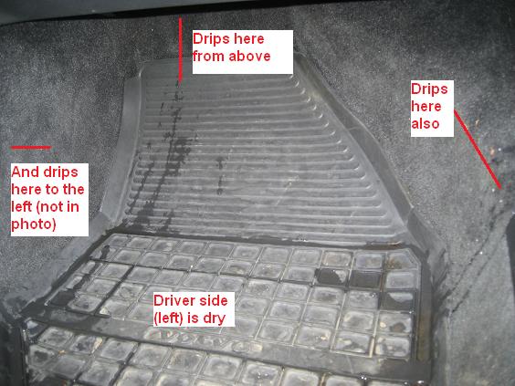

Thanks. I'm attaching a more detailed, annotated picture for reference. I'm not looking forward to this repair . . . . The heater core looks doable for me, I'm not sure I'm up to the whole evaporator procedure given that it requires removing the whole dash, but it might be a decent winter break project with my son. We have a garage, but it's not heated.

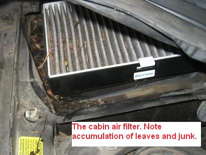

Just for information, here are two annotated photos that also demonstrate why you should not park your 850 under trees.
This problem has been building a while, but the car only sees a couple thousand miles a year at this point in its life.
Should my coolant be low? Wouldn't that be another indicator?

In light of your new pictures: If you have not peeled back the carpet and looked for either a blockage at the evaporator drain pipe or a damaged pipe I would do that first. It is conceivable that the pipe is split/ disconnected and you may have a blockage too boot causing the water to drain on either side of the occupants feet.
I certainly am not trying to over rule the superior knowledge of JRL and Ozark but it is well worth the look if you have not done that. There is also the possibility of water leaking out of the fan housing/passage, I had a soft black "gum" plugging a hole.I do not know if this is a default fitting or some prior work was done and they drilled through the passage from the blower motor to the evaporator. You might also get water running more quickly down the right side of the passenger interior when you make a left turn.....the passenger would be your best bet to view it.

V70r 2007 86K bought oct 2010
Jez, you guys know how to scare a guy. We are talking no ac going on. For starters where is this cabin filter. Told by macanic condenser has pin hole. Wants $700 to replace. Was going to recharge my self but saw this post and thought I would check out the evap first. Got to start somewhere. Thanks for the post. Oldcrow

The cabin filter is accessed from under the hood - it's on the passenger side under the large black plastic cover which surrounds the wiper blades. You can undo 3 of the 5 Torx screws that hold it in place and it pops up enough to install the filter and the bracket. It may be a good idea to remove the wiper arms and remove the cover completely so you can cleanout the entire area. It fills up with gunk over the years which can only lead to rust or a funky smell in the cabin!
