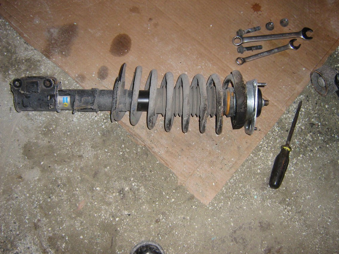

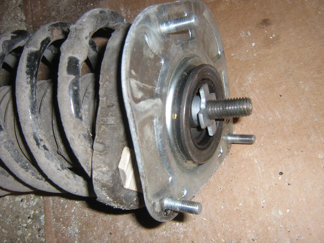

holler1
Posts: 756
Joined: 25 June 2008
Year and Model:
Location: West Virginia
Post by holler1 »
Trying to stop suspension popping, I removed the passenger side strut today. Here are some pictures. The first one is the entire strut as it came out; second is a closeup on the top; third is the top after loosening the top nut; last is closeup of top after removing the top nut. The last two show that the spring seat is twisted relative to the shaft. I think it means the metal shaft in the spring seat is loose from the outer part of the seat. I have to get a spring compressor to take it apart and make sure this is what is going on. I haven't ordered new seats yet but am planning to get IPD HDs. Any other thoughts? I'm not sure what the spring should look like. It's not symmetrical but I don't know if it's out of spec.

MadeInJapan
Posts: 13434
Joined: 31 March 2005
Year and Model: '98 S70 T5 '07S40T5
Location: Knoxville, TN American but born in Japan
Has thanked: 17 times
Been thanked: 35 times
Post by MadeInJapan »
it certainly does look twisted (which it shouldn't be). I guess you're really not going to know until you get it out and check it for integrity, but I suspect that the twisting is the result of it being busted.

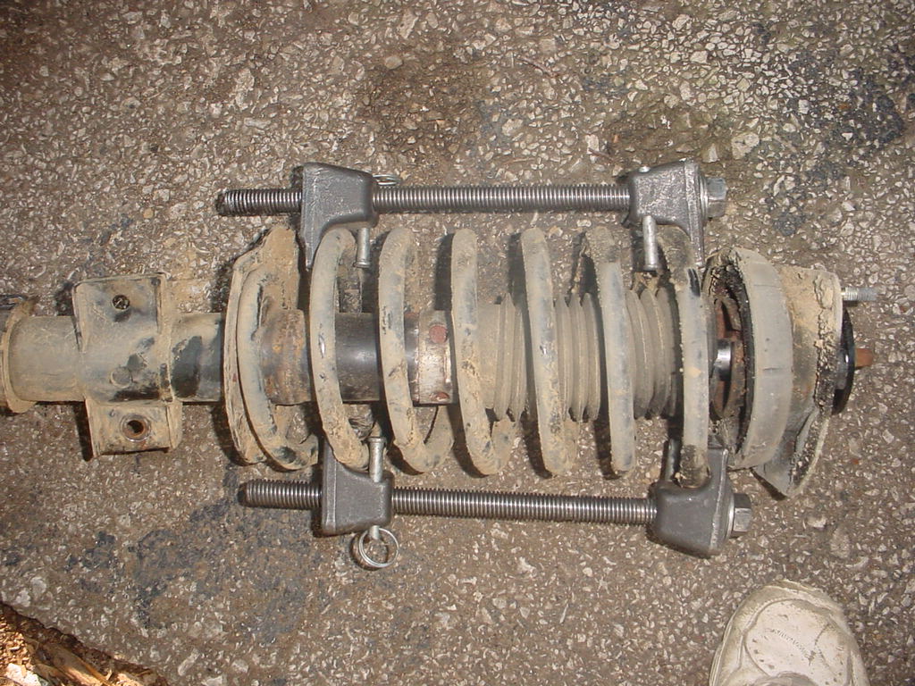

Ozark Lee
Posts: 14798
Joined: 7 September 2006
Year and Model: Many Volvos
Location: USA Midwest
Been thanked: 75 times
Post by Ozark Lee »
It doesn't look correct at all. Make sure that the ends of the springs are seated at the end stops on the strut and on the spring seat. Could it be that the spring is upside down?
Here is a picture of mine as I just put it into the spring compressor - note the symmetry.
...Lee

holler1
Posts: 756
Year and Model:
Post by holler1 »
Lee,
The springs are seated within 1/4 inch of the stops at bottom and top. When I installed they were closer. Although I agree mine looks very asymmetrical, especially the ones with the top nut off, your photo is taken from a different angle than mine. Mine is from the front of the car, yours is 90 degrees away from that. The bottom spring mount on the strut is very asymmetrical by design and juts out to the outboard side of the car, so the spring has to bend some to go from there and line up on the spring seat (which is also asymmetrical). Your picture is taken from an angle that doesn't show the asymmetry of the bottom mount. I don't believe I put the spring in upside down, and I recall being careful about that, but I suppose it's possible. Do you know of a way to check?
Thanks for the comment. I know you've done a lot of suspension work so I value your opinion.
Larry

holler1
Posts: 756
Year and Model:
Post by holler1 »
Lee,
Here is one I took from almost the same angle as yours when I installed the struts.
