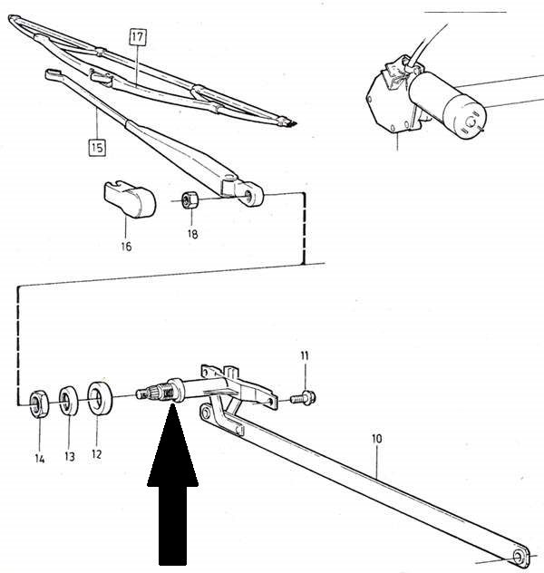

Thanks Renn for a great writeup. Just did mine today. I will stress the importance of removing the wiper shaft using a vice (not a hammer as much as possible) because the shaft is aluminum and the threads will crush if pounded out.

Hey guys, glad to see the write-up is being put to good use. That wiper fix held up for the 2yrs following that I owned the car, and I'd bet it's still going strong!
abscate, I agree with your comments - the energy cost of mfg is huge, and is not taken into account by many 'green' folks. Spending a few $$ to keep the old girl on the road can be very green, so long as the emissions gear is all up to snuff. As fuel costs go up, though, I dream of those European diesels. It'd be even more rewarding to nurse the old girl along if she rewarded us with 35+ mpg!

Glad to see people getting use of this diy. I just did the same repair on my latest Volvo, a V70. The wipers now swing with authority once again, just in time for the spring rainy season! If the tools are at hand, it's a 45 minute job. Just make sure to take note (or picture!) of the mechanism position before disassembling so it goes together the same way.

I rebuilt wiper mechanism last night and...wow...what a difference
I should do that 2 years ago when first symptoms appeared,but it wasnt't that bad until last few months.
The little shaft at driver's side was siezed badly and i hardly separated it from the housing.
It hardly moved with a LOT of force applied.I wonder how the fuse and wiper motor didn't fail.
Passenger's side was ok,but since i allready was in that area i removed,cleaned and greased it too.
I put enormous amount of grease in the shaft hole and on the shaft itself just in case.

Hi everyone,
Appreciate this thread is old but I was wondering if anyone could help with with a question please ?
I really need to get the windscreen wipers sorted in order for my car to get through it's MOT. I have tried to follow the steps renns has kindly posted, but I am struggling with #7.
Is the 'retaining nut and washer' under the plastic boot which covers the base of the spindle? If I am interpreting the image correctly, I'm assuming that references no.14, but on my car there seems to be no obvious 'nut' I can remove. It's the same on both spindles so I don't think it has somehow gone missing over the years.. How are 13 and 12 removed as they are round and I can't get a spanner on them.
Without being sure on this step, I don't feel it it is possible to progress the repair.
Many thanks.
Many thanks.
