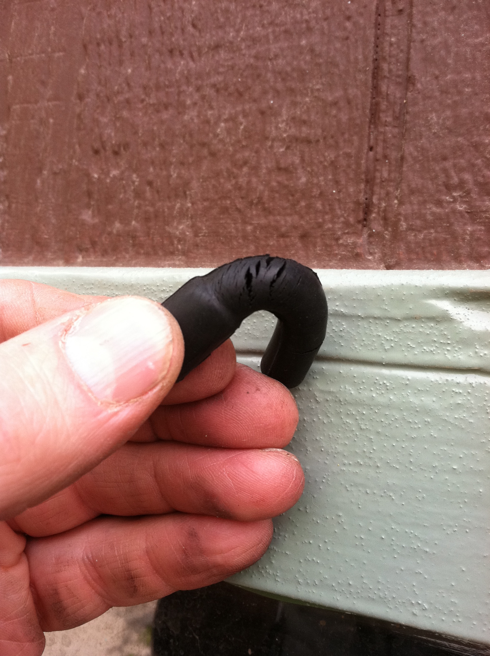

My cruise was working then it wasn't. Used the advice from a couple of folks here and checked the simplest thing first. There it was. Vacuum elbow was just under and slightly in front of battery tray. Just reach in and replace. Cruise works again!
