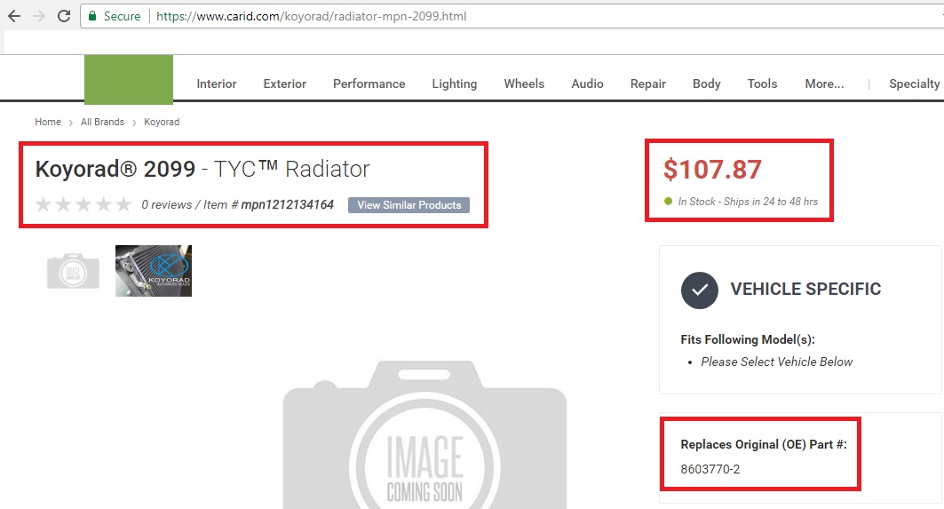

Browsing the internet, I came across TYC Radiator (TYC is a Taiwanese company) but the TYC rad is made by Koyo, which is a Japanese company. The model for ? 1994-1997 850, and 1998 S70/V70 with auto and turbo is 2099.
Has anyone here used Koyorad 2099?

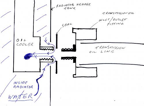

Just came across Valeo radiator issue in Mercedes forum!
- I have EXTERNAL leak: from radiator to the outside world.
- These Mercedes people have INTERNAL leak: coolant enters the transmission, causing trans failure!
This guy brian000 in Mercedes forum posted nice diagram of the typical Valeo radiator design. The only thing that separates ATF (or engine oil) and the coolant is the sealant (what is it: Teflon versus ___?) that is used in the fitting that screws into the cooler unit.
http://www.benzworld.org/forums/c209-a2 ... l-fix.html
I am reposting the diagram drawn by the Mercedes forum:

- Posts: 11912
- Joined: 25 Jul 2009, 14:03
- Has thanked: 311 times
- Been thanked: 817 times
Another reason to do routine trans fluid changes!
That other post by mecheng you bumped up says "no o-ring, no thread sealant, probably tapered threads" about the cooler port. So probably the same for these Volvo rads. I think the parts car has a Valeo and it is old enough I would never re-use it, I will try to take a look at it this weekend if no one else gets you the info first.
