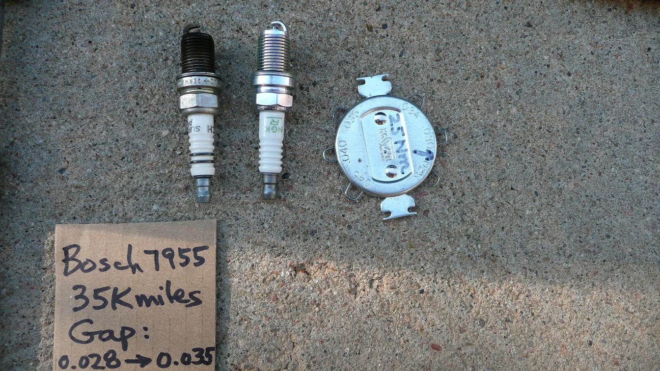

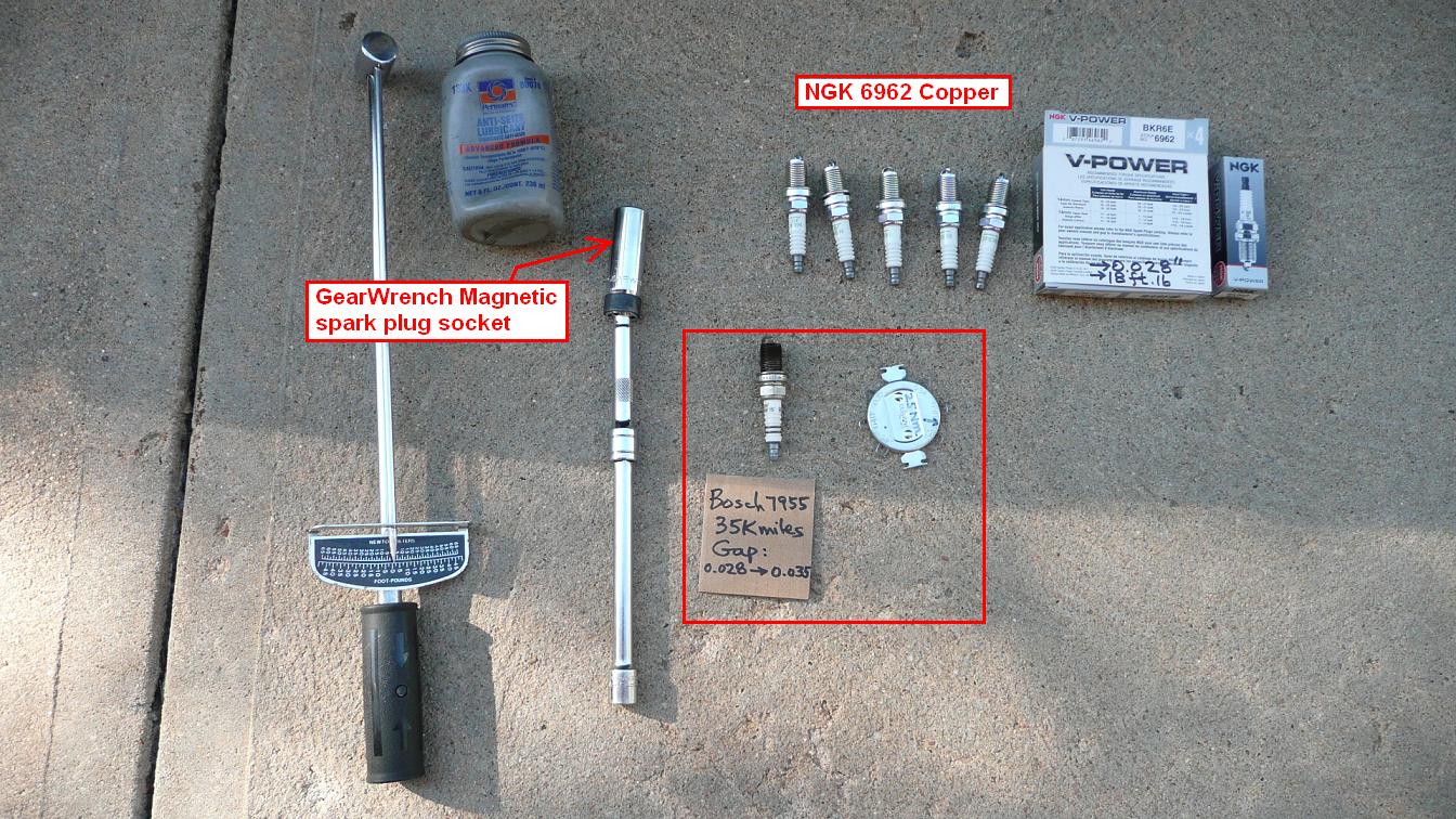

Just a little update on NGK...
Just helped a friend replacing spark plugs on his 1998 S70 GLT with 180K miles.
- Old plugs are Bosch 7955 with 35K miles on them, the gap has gone from 0.028" ---> 0.035". Not too bad for 35K miles.
- Local store does not have Bosch 7955, so he bought NGK 6962 for $2.50/each, which I think is as good as Bosh 7955.
