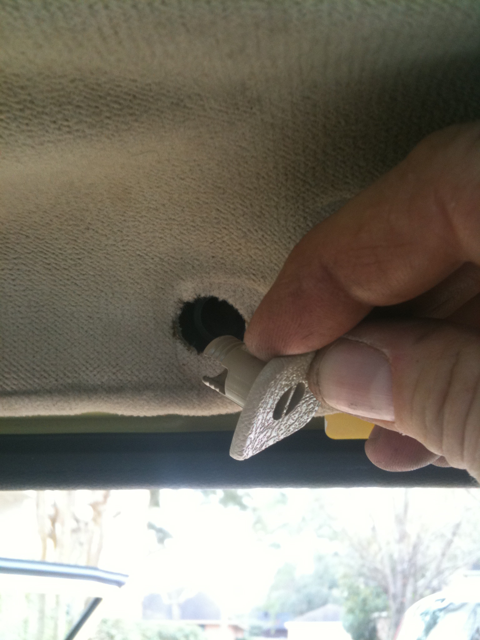

Here are some of the pictures I was talking about. I hope it helps you get an understanding of how they come out.
This one is behind the center post
Behind center post
Behind center post
Holds up headliner
holds up headliner on sides
Just pulls out
Just pull out red tab
Do not pry this one out, it slides one direction and comes out
My broken tab

Wagons are not bad, sedans add a lot more contortions for you and the headliner.
The visor hangers are not obvious but easily removed when you pry the insert out that locks into the square opening in roof.

Removing the roof trim without breaking anything was my big challenge. I consulted a detail shop about the yellow clips that I didn't know were there until after I'd tried. I found that where I could slide pieces to release them rather than pry them straight off, the clips didn't break.
At the junk yard I practiced removing the sunroof rim trim. I couldn't get them to release the way Rob describes, so I used a plastic trim removal tool from Harbor Freight that has a 2" wide "blade", sort of like a sheetrock knife. Located the locking points along the back edge, inserted the blade edge of the tool at those points and tapped the handle of the tool with a short piece of 2 x 4. They popped off along that edge and then I could pull the others loose. That piece is resilient but as many have discovered they will break if you bend them too much.
With the seats folded flat in my 854, I was able to move the liner out and back in without creasing it. You do have bend it in kind of an arc, but it's designed to give so it won't crease as long as you bend it sharply.
I found that on my 850 it's impossible to unplug the visor wires. They seem to be glued in, so I had to cut them. It's best to cut them about half way down the pillar, so you have room to work on the splices. Use 18-22 gauge butt splice connectors for those.
