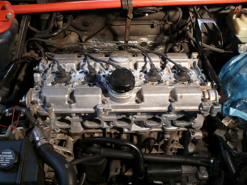

Next round of pics. Pulled a late nighter from 7-12 last night. Cam seals & timing tonight.

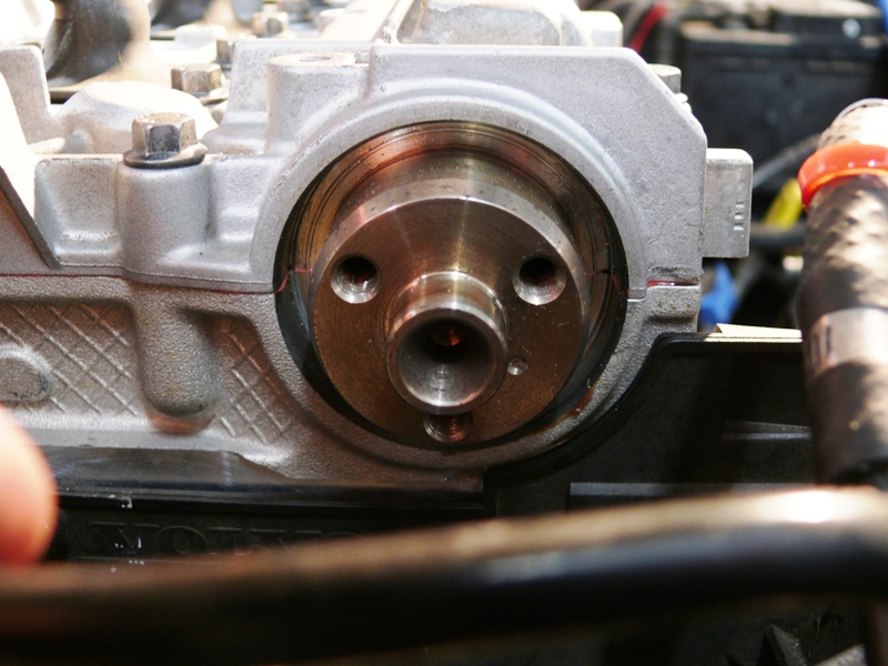

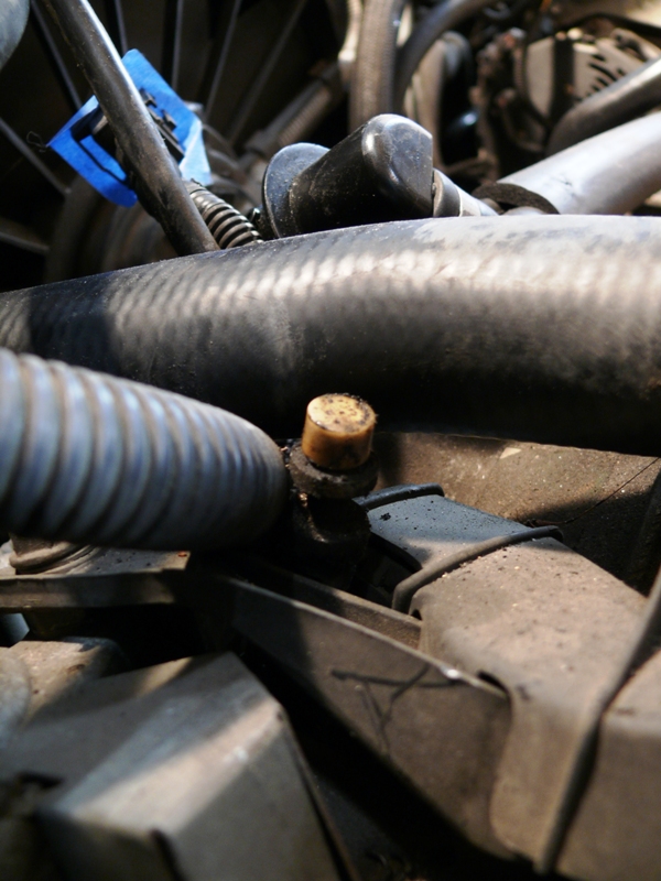

Anybody know what this is? It's located on top of the trans. between the PNP switch and the torque arm mount. It looks like some sort of nipple with a cap. The whole thing seemed rather loose and not in good condition.
