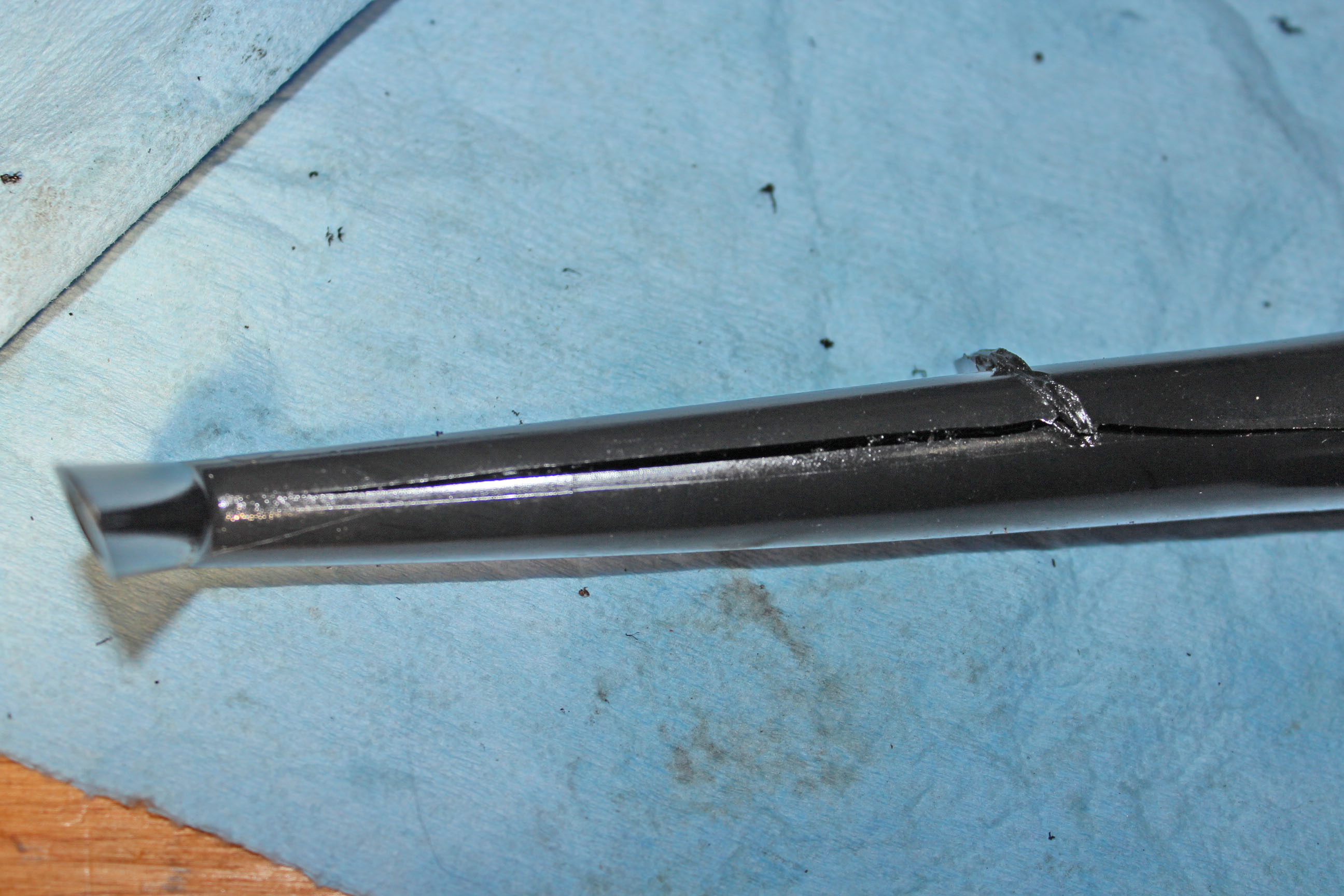

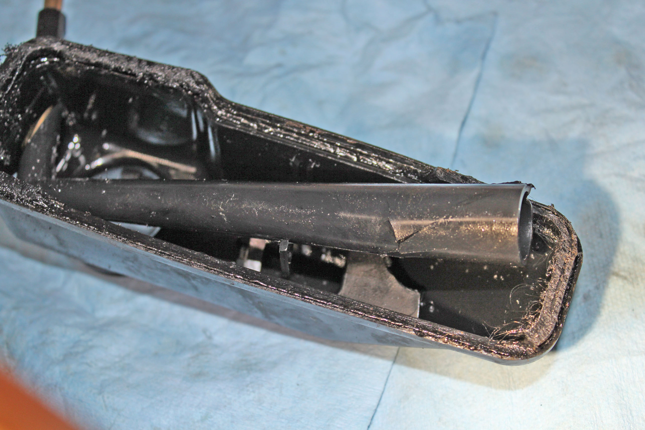

Check the PS fluid while the engine is running for air bubbles, if the fluid is aerated the PS pump will make noise. If your car has the older design PS reservoir there's an internal tube that cracks and aerates the fluid.
Older design reservoir with return line on top.
Internal tube that cracks

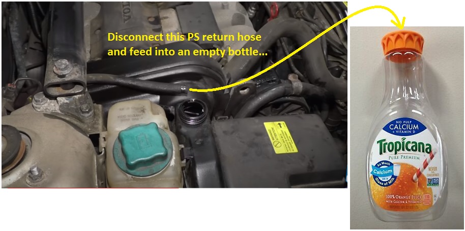

- My 2004 V70 with 122K: the PS reservoir was replaced with Genuine Volvo reservoir in 2019.
So the reservoir is basically new.
- From watching youtube and reading some threads (using the Steering Rack as the pump), changing PS Fluid is EXTREMELY easy! No need to do the whole thing as in the youtube posted above (by A1Auto): they used the technique with engine running for 2 sec, this is very stressful and if you let the reservoir run dry, you risk damaging the PS Pump.
Here are my EASY EASY tricks for solo person:
- My 2004 V70 takes Pentosin CHF202 aka 11S, about $15 at FCPEuro.
About $25/1L at Napa, but they had it on sales down to $22.
I was short on time so I donated $22 to Napa lol...
- No need to run engine. Leave engine OFF.
- The only hose you need to disconnect is the PS return hose (the small hose that goes on the top of the reservoir), and feed it into an empty bottle. Factory is Oetiker, look up online how to remove an Oetiker clamp: basically spread it a bit using a small pair of pliers. Replaced with regular clamp.
- I had a Tropicana 1.5L orange bottle that I rinsed an dried it.
Clear bottle allows you to see what is coming out.
- Turn the SW R and L, between 11 o'clock and 1 o'clock. You will see old fluid running out.
You basically use the steering rack as a pump. After 3-4 times rocking the SW back and forth, the reservoir is dry.
Fill it with new Pentosin fluid. And repeat until GREEN fluid coming out.
- No need to worry about PS Pump running dry bc once you pour new fluid in, it fills the PS Pump very quickly.
If you have a helper then tell that person to watch the reservoir and keep it 1/2 full all the time.
- Reconnect the return hose, tighten the clamp snug and done. Make sure the reservoir is a bit more than half filled.
- Run the engine and turn SW full R and full L a few times to bleed the system.
- Turn engine OFF and check PS Fluid level.
PS: The old factory fluid is yellowish. New fluid is GREEN but from my experience with BMWs, after a while the Green color from Pentosin slowly goes away and you are back to yellow fluid.
The PS Pump whining noise is much improved now with new Pentosin fluid...
- Now that I discover how easy it is to replace PS Fluid, you can use the same technique for any other cars, from BMWs, to Toyotas to Hondas etc.
Forgot to take real-time photo, but here is the idea, place the Tropicana bottle on top of the engine, tape it so it does not fall sideways. Feed the return hose into the bottle. Easy!
