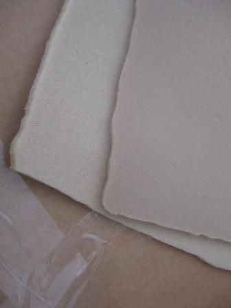

Something else probably different - I bought two yards of headliner from Miami Corp, color code MH1912, which is listed as 3/16" foam backed, in 'Buckskin' color. When I measured my original material I came up with 5mm, which is neither of the typically available 1/8" or 1/4". The 3/16" measures close enough to 5mm that I think it is actually 5mm. The color match is pretty good for my interior code 3950. Not exact, but pretty good. They have a great selection of colors. I did not recover the sunroof.

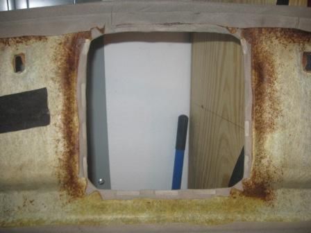

Using a small trim paint roller seems to be the best way to apply the headliner into the corners/curves. I put the clean board out on a piece of plywood on two sawhorses, laid out the material on top, and then folded it at the mid point so that I could apply the adhesive to one half of the clean board while rolling out the new material. After I finished the back half, I folded the fabric the other way and did the front half. All trimming was after the foam bonded, and I took some pictures of the old board to remind myself how much overlap the factory used in different places. The first photo below is the old board.

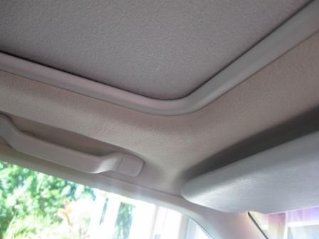

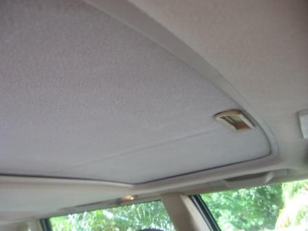

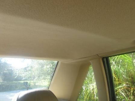

The others are interior shots taken today. It's been there since July, and it looks like the adhesive and foam are not going to fail anytime soon.
