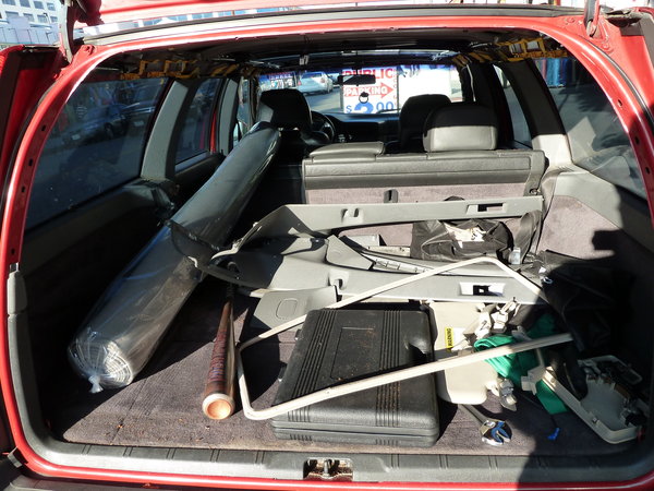

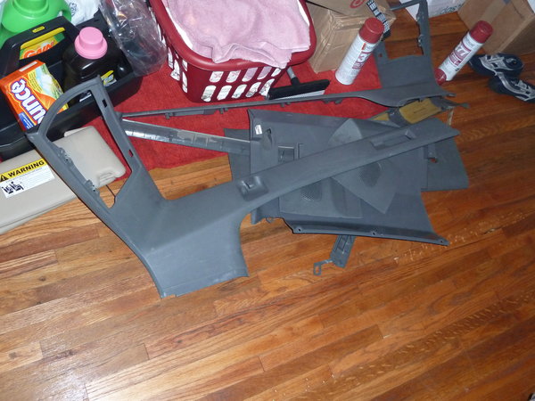

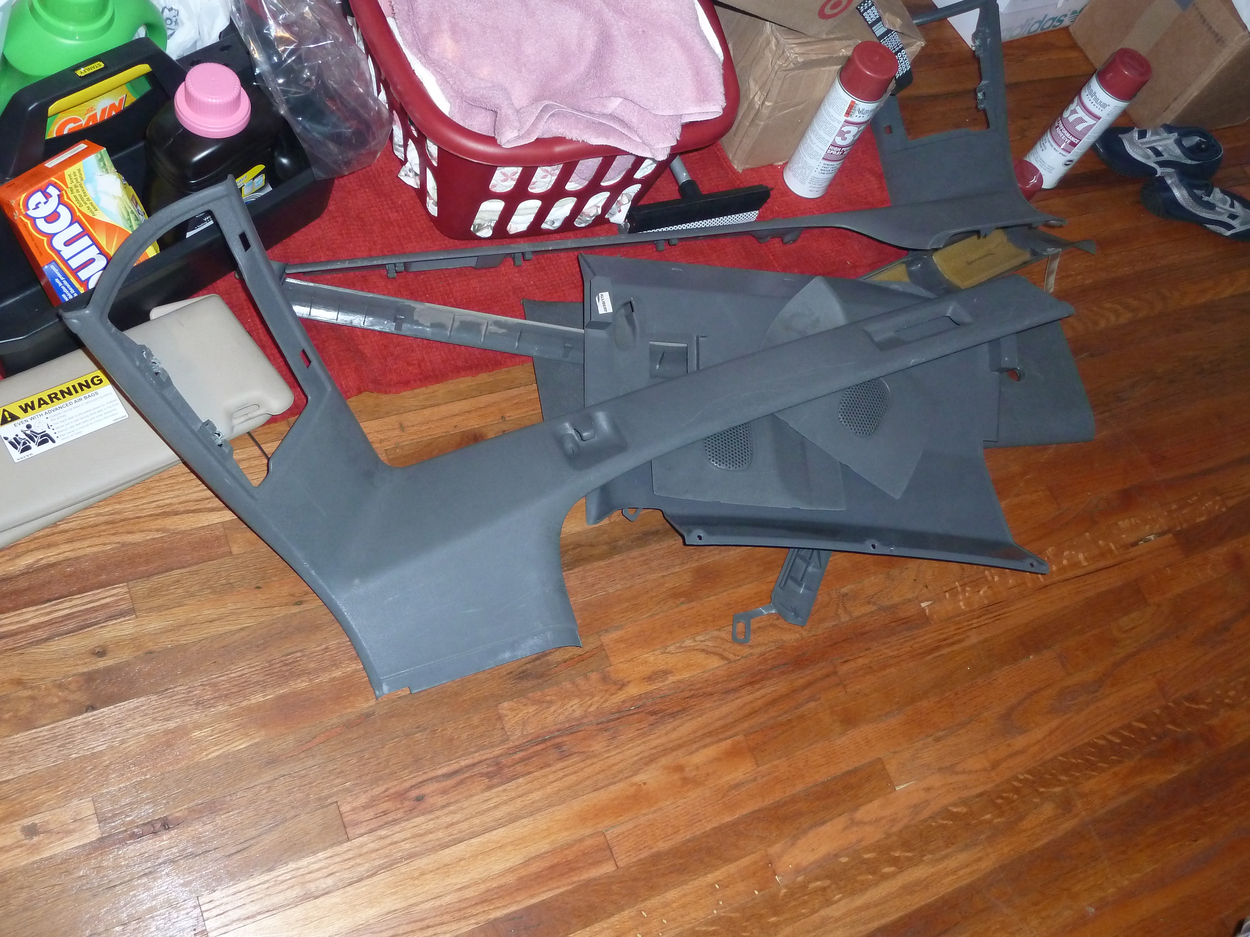

I have replaced headlining before so I figure this won't be hard, its not but patience is a must. I broke a few clips from the plastic panels, typical really. Aged clips and not knowing the correct angle to remove the panels didn't help. Be careful.

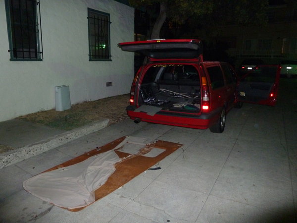

So after you unclip all the trim panels, grab handles, and courtesy light and removing the sunroof trim the whole board should be ready to be dropped down and pulled out the rear of the wagon.

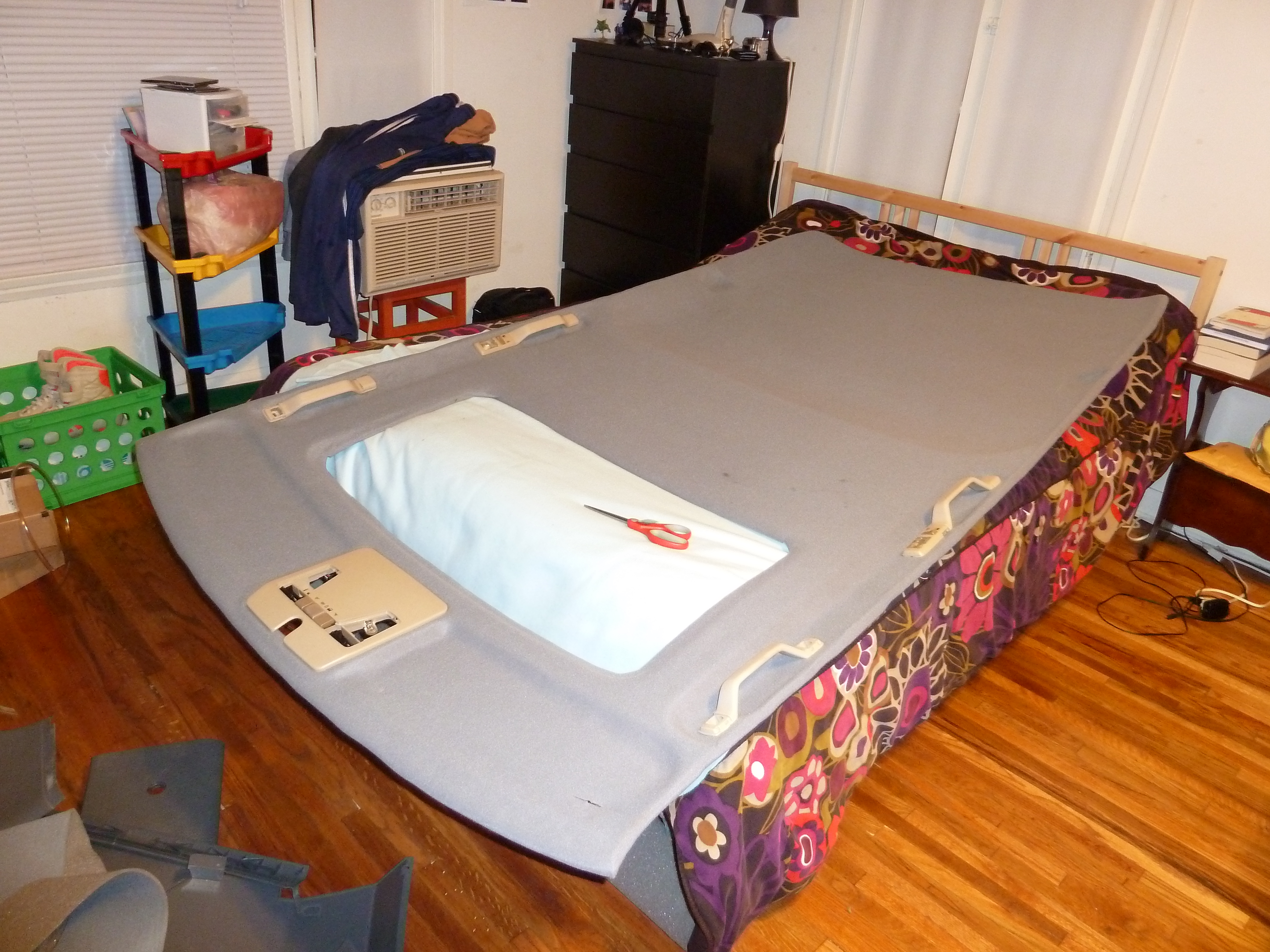

Panel removed.
Panel removed.

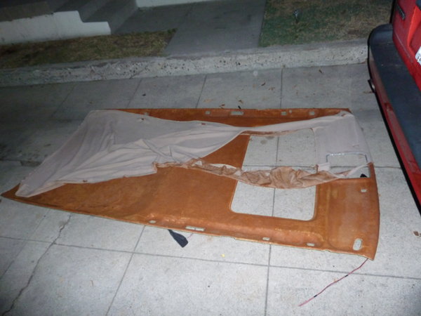

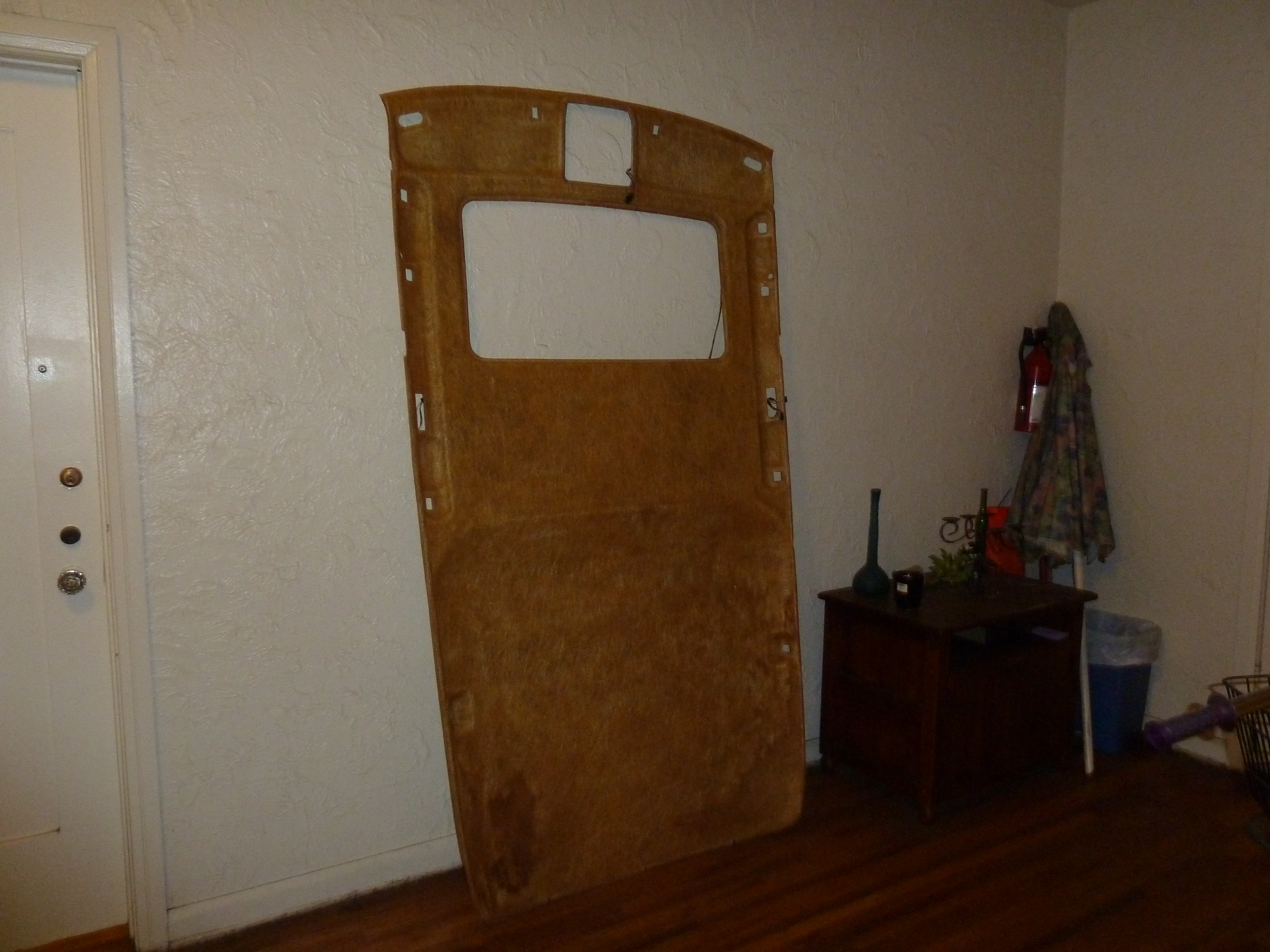

Once that is done you you need to pull the old cloth off and remove all the old foam as some of it will be caked on. I used 80 grit and 120 grit to work it all off, this took me a day as I was in no rush and I was thorougher.
panel clean up
panel clean up

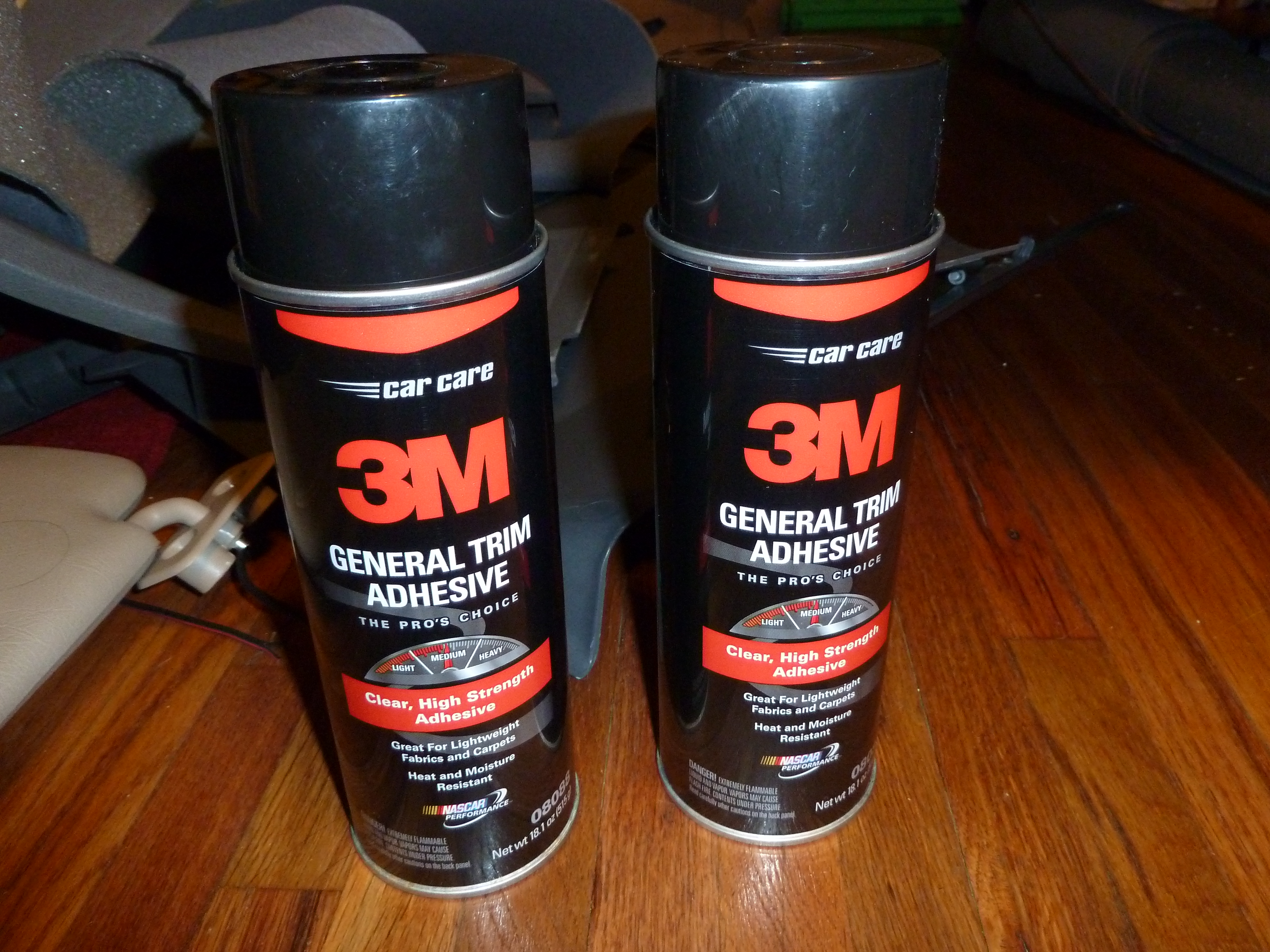

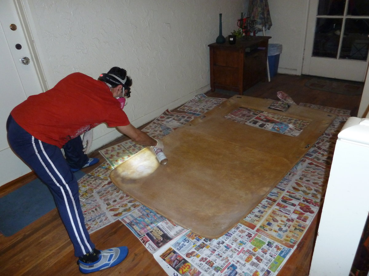

I then applied the 3M medium spray adhesive which is perfect for foam backed cloth. Do not use the heavy duty 3M as its designed for plastic or leather. It will soak the foam and bind the cloth down. I got the 3M from PepBoys for $17 a can. I had hoped 1 would do the whole board but no such luck. I had to buy another for the sunroof board. I was not going to skimp on glue here. To apply the glue you spray it from say a foot away and allow the adhesive to tac over, in other words make sure its not wet and once you put the foam down you CANNOT pull it up. You will rip the foam off the cloth. Care is required here, make sure the fabric has a small amount of tension in it. DO NOT stand or lean on the foam whilst its drying. It will leave an impression that won't come out. You don't need a size 12 foot print on your roof right :lol:
Spray on primer or glue.
When spraying the 3M adhesive do it in a well ventilated area and wear a proper mark with vapour filters. Its a good idea to cover the ground with paper to protect it from over spray. Also wear some old horrible clothes and shoes because once it gets glue on them its never coming off. Gloves are highly recommended as well. Make sure you have good lighting so you can see what has and has not been sprayed with glue.
3m spray adhesive, medium duty. $17 each.

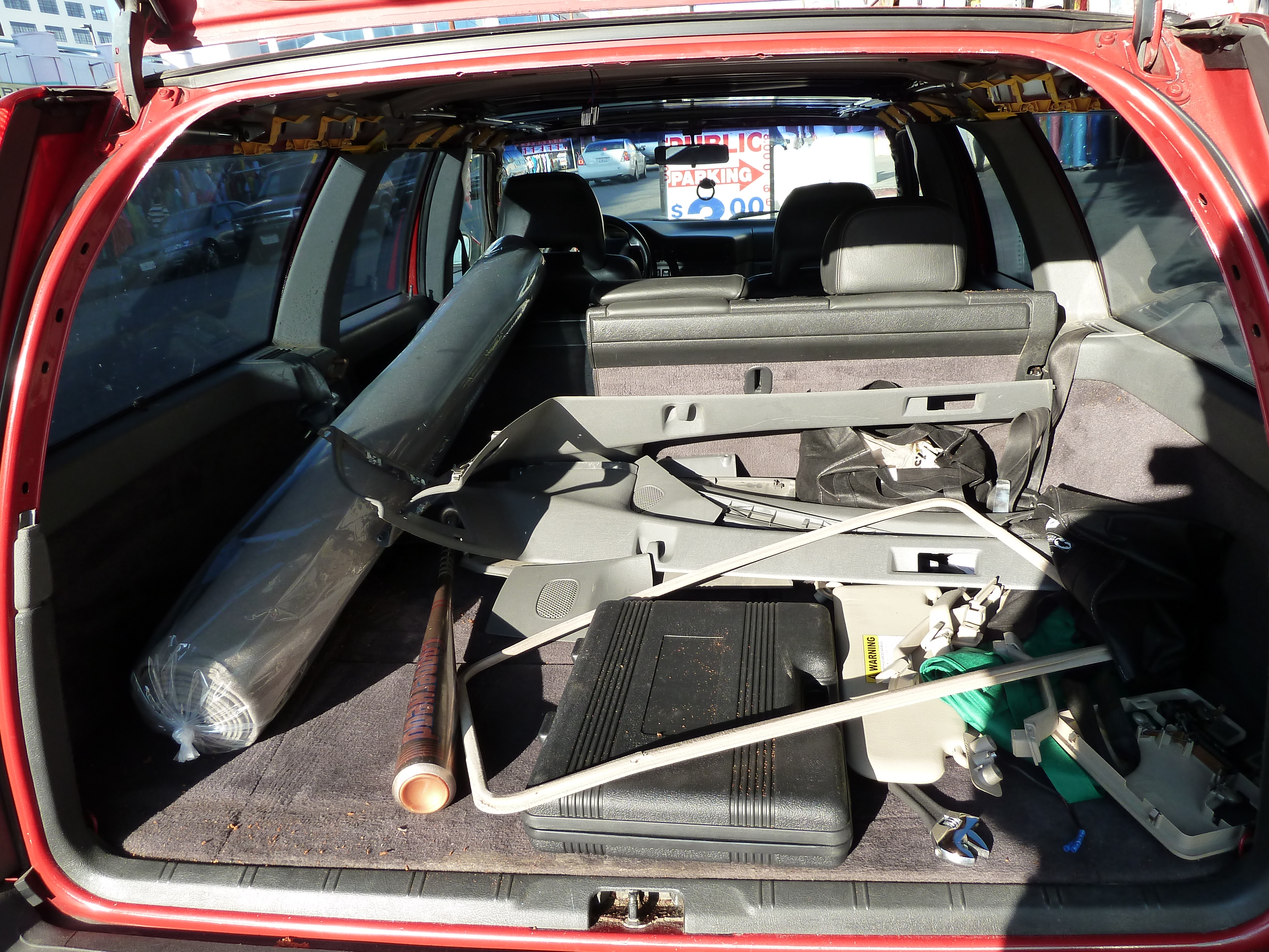

The headliner was purchased from a store in down town LA from a place called Micheal Lavine. $10 a yard I bought 4 yards. You need 3 yards for the main board and another yard for the sunroof.
Grey headlining foam $40 four yards

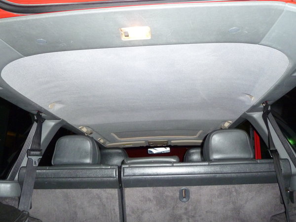

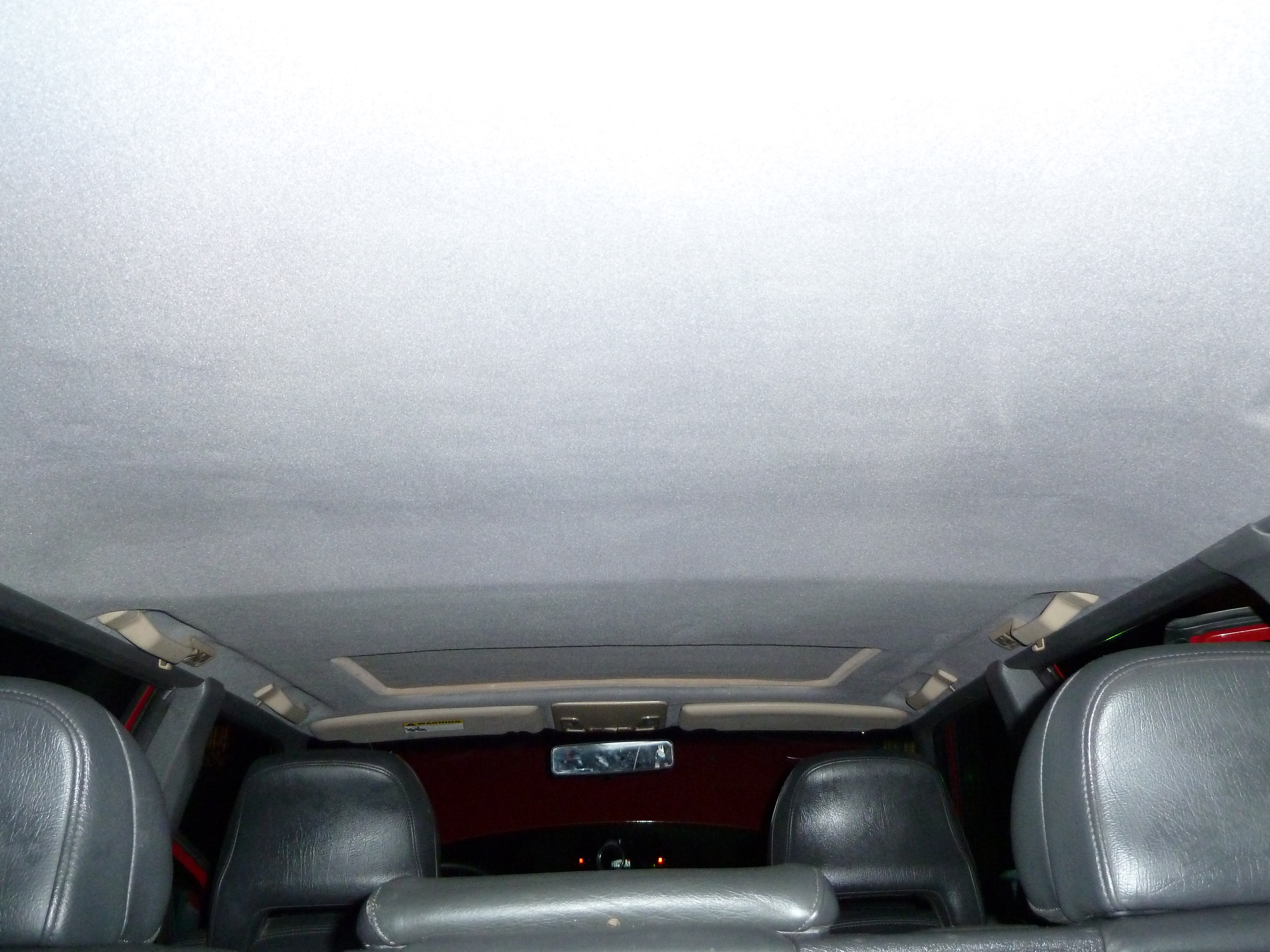

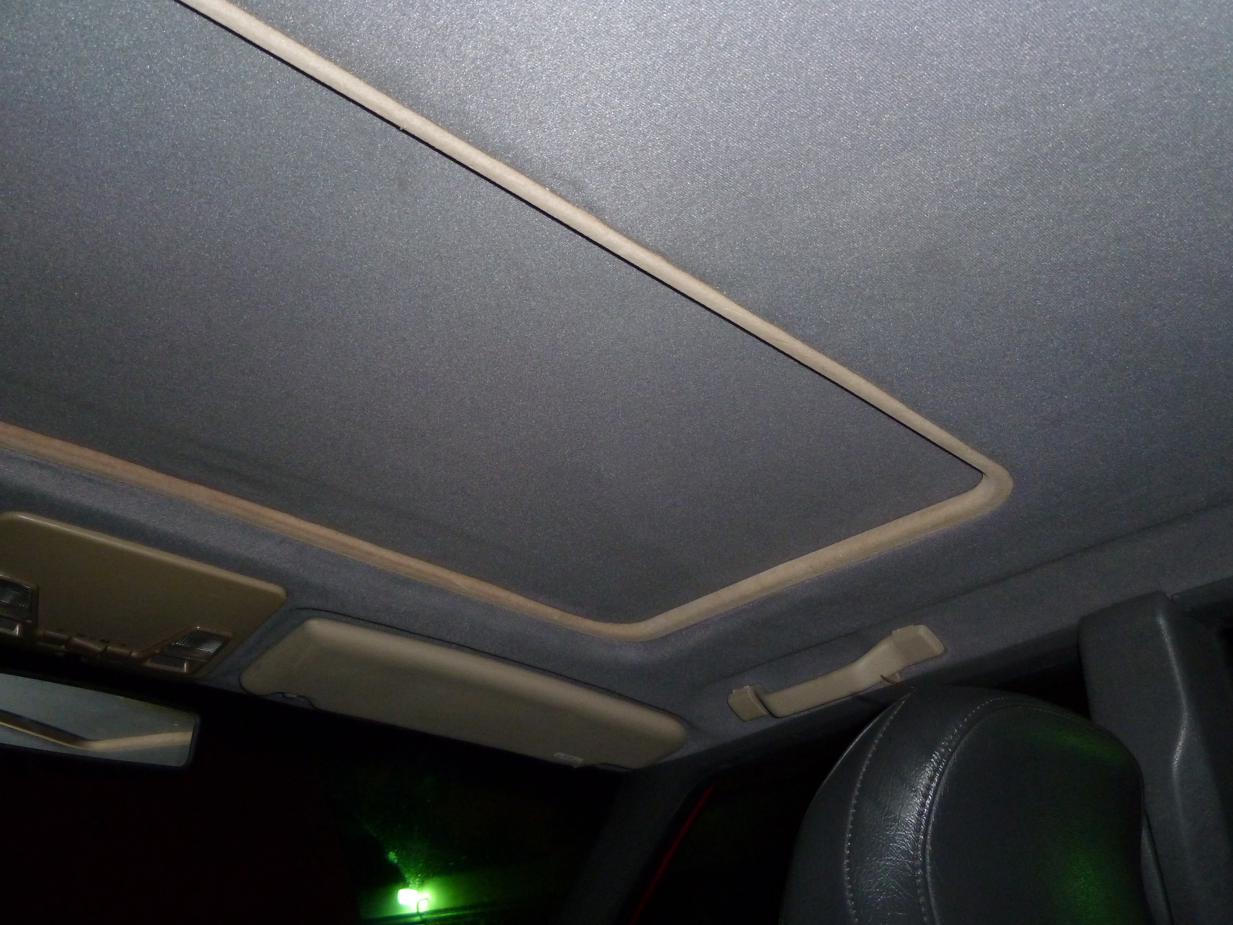

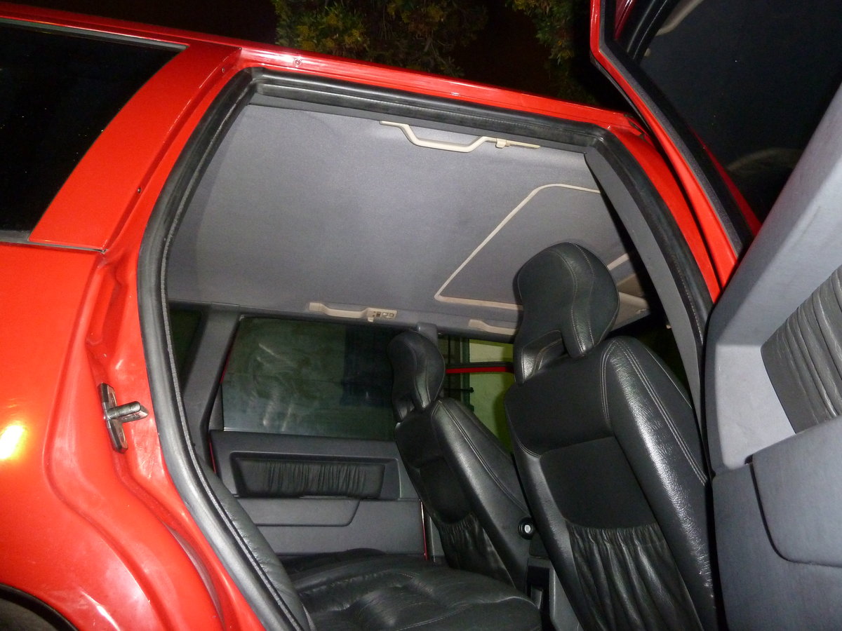

The sun roof board comes out with easy by pressing the two clips from above but putting it back in was a nightmare! I dropped the whole sunroof assembly as I could not figure method to reinstall it. I'm still not sure how I did it to be honest. :shock: If you go to a textile store you can buy any print you like such as Tiger, fake Snake, Sheep or what ever floats your boat :wink:
I know the cream handles look off but it will do for now. I'm not sure Volvo did grey ones? Well I hope this makes sense and has helped someone else. Like I said its not a hard job at all. it just takes time.
refit
refit
side view
side view
side view inside
side view inside
end
end
trim excess cloth
trim excess cloth

Digging in my wife's Mac book I found a few more pictures and 2 of the hideous old headlining. This is exactly how it looked when I removed it. imagine that hanging down now :lol:
removal
removal
foam lining
foam lining
Disgusting
Disgusting
Raggy baggy nasty head liner.

Here's how mine turned out:
As for the colour: mine's pitch black, and I fitted the dark-grey pillar covers from a V70 as well as T5-R seats (had dark grey leather before) - feels very comfy. Didn't like the bright interior before at all, somehow the car felt "cheaper" with it because it always remembered me of that dull light grey plastic from the usual minivans.
