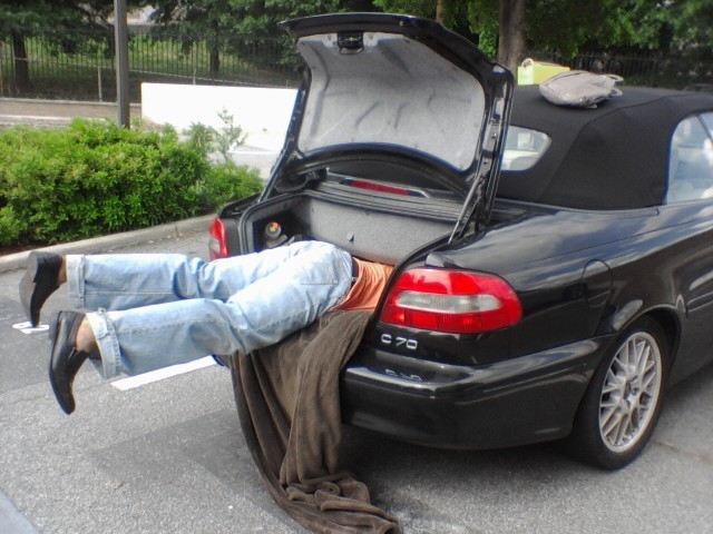

so we've got the new pump (bought used from VoluParts, an awesome shop in Atlanta) and after lot of work, Marc got the two lines undone and the horrible black ring off. all is ready to come out BUT the electrical is connected behind a panel, behind another electrical piece in the back of the trunk and we're having a hard time getting it undone. Anybody have a visual of what's back there so we can avoid breaking anything by undoing blindly? Or is there an option to just cut the wir
es and reconnect them some how to the new pump? gr....
funny pics below (ok gotta admit, it's only funny when you're not the one contorted in the trunk with fumes in your face...not fun at all)
