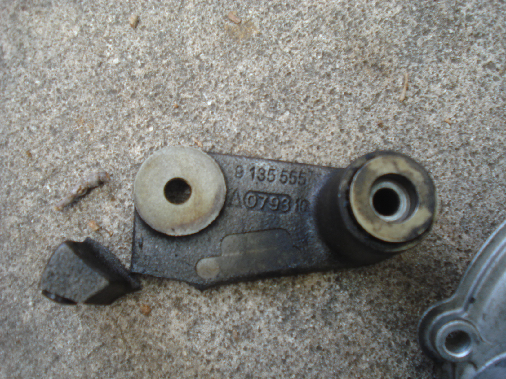

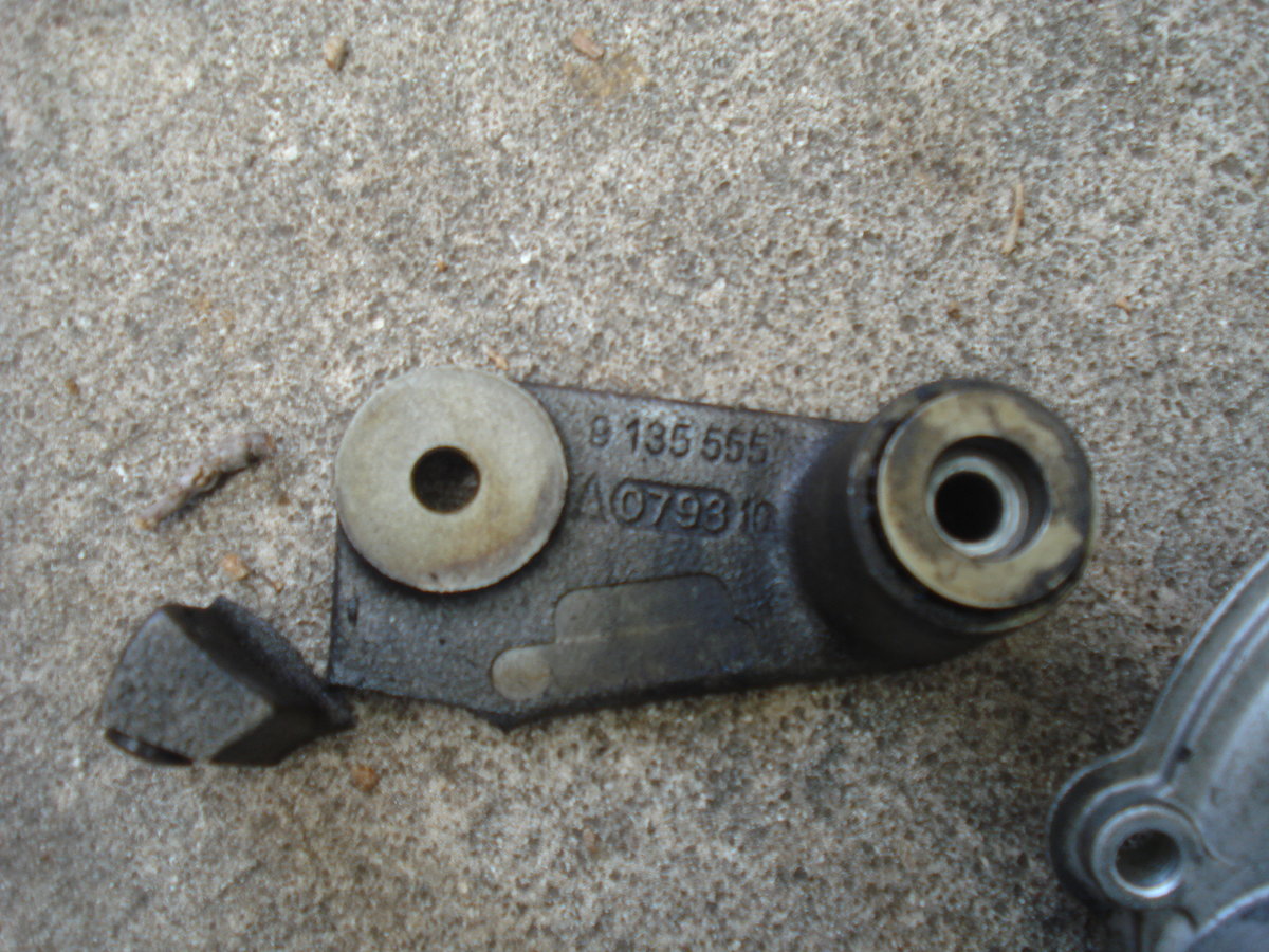

Thanks for quick reply. No it didn't shear all of the way off. The clearance for the shaft between the gear and the impeller (sp?) opened some as the water pump damaged. So when I took it off there is a significant damage to it. I have the belt off now and the water pump off. Mike

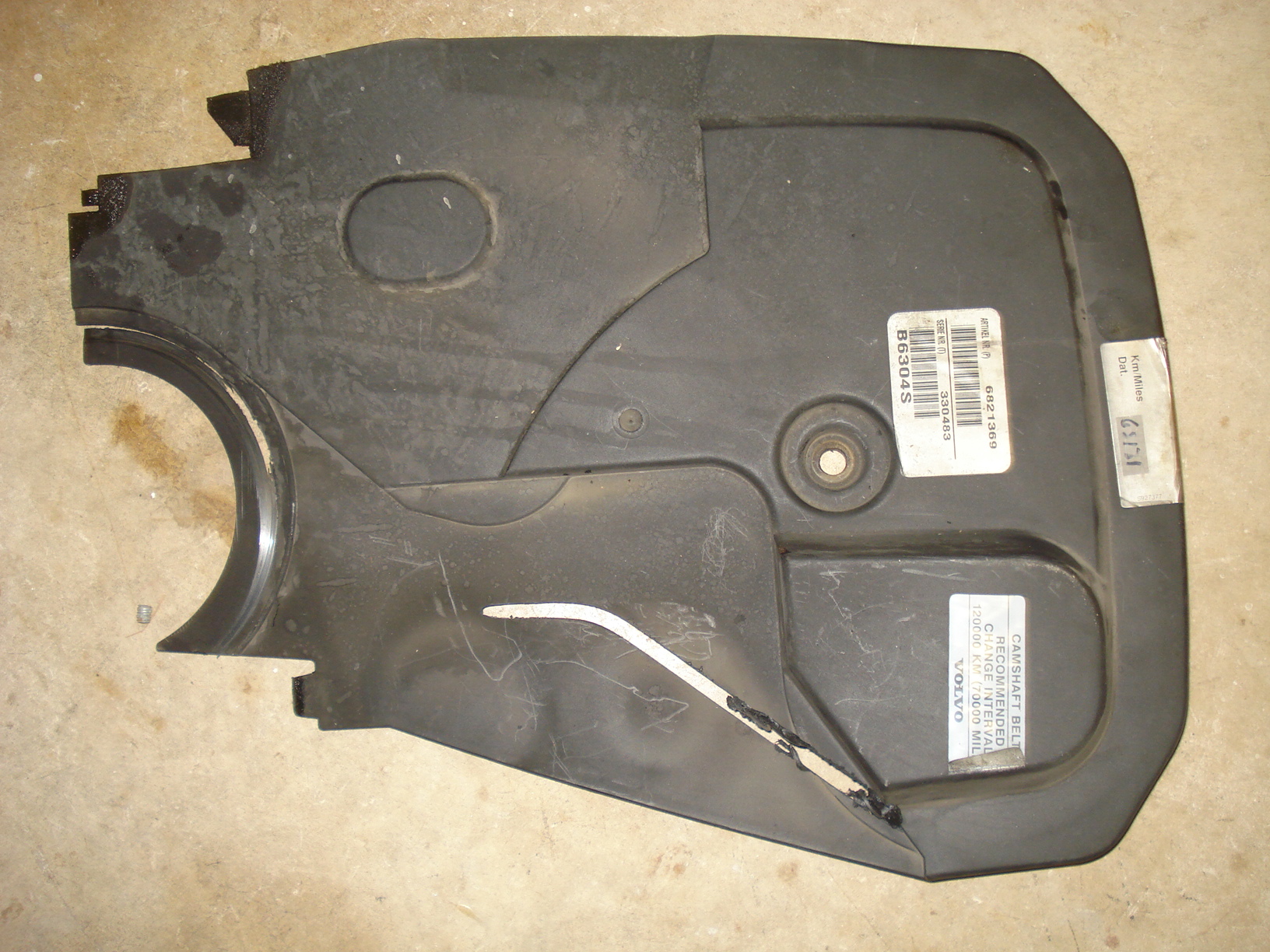

Cannot tell. I went forward and removed two belts for the tensioner then removed the tensioner. I then took off the belt. It came off but it was tight. I have some concerns about whether it might have caused damage and then the retiming of it. I posted a few photos. I am also sure of any damage that may have been done as my daughter tried to restart it and then called me when it wouldn't start up. I am still working on how to actually post the photos as an attachment. After getting the tensioner off and the belt off it was apparent that some damage was caused to the front external pieces. I am in stage of putting it back together and got very concerned. If photos got attached you will see them. Mike
