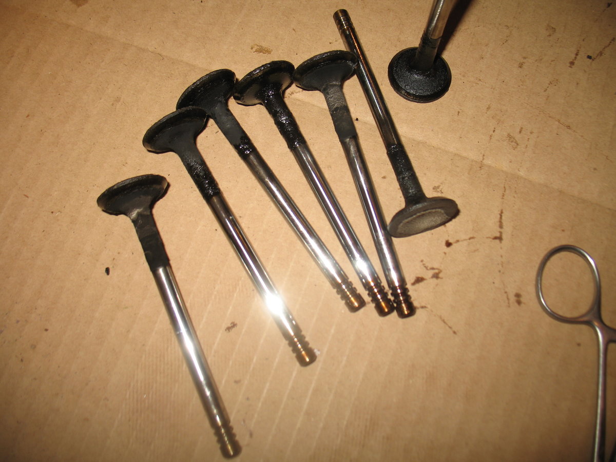

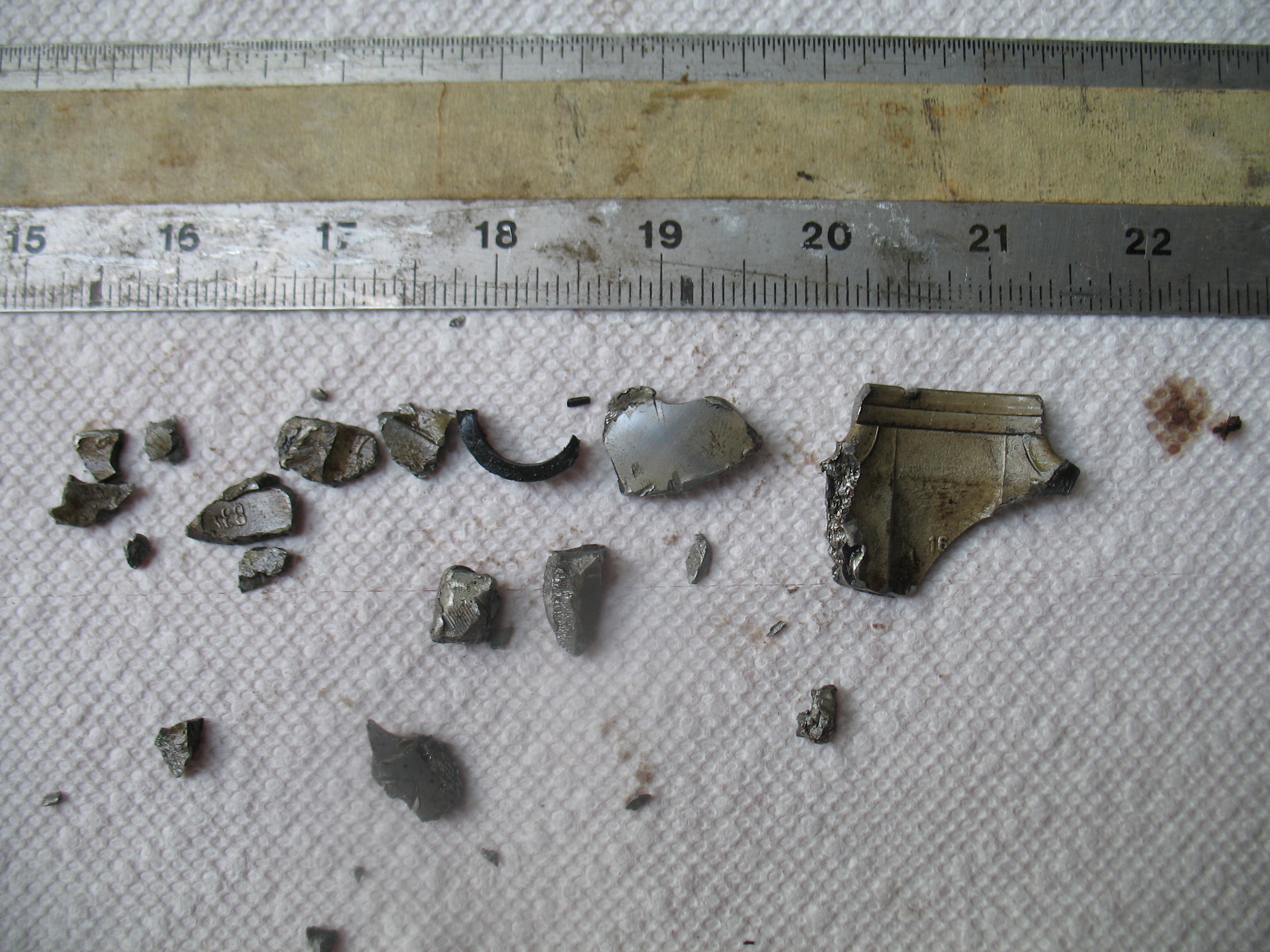

Quick update; it's much worse than I thought, which what I thought was that the oil sump seals were toast (like all the other seals I'm finding) and they needed replacement. So I pulled the pan and saw this:

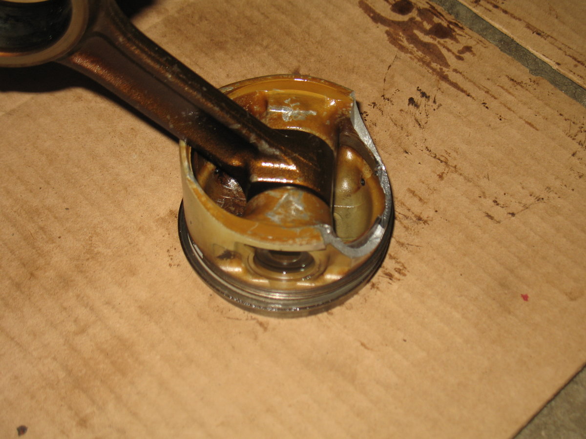

So we cracked the head and found the cause:
Not sure how it was broken in such an interesting way - I still had 'normal' numbers in a compression test, so I didn't think it was a piston. Thinking about it, with normal compression numbers and ZERO scarring on the cylinder walls, I wonder if this really was causing the noise. Well, soon I'll be replaceing the piston - probably all five since I'm in there - get the thing put back together and probably get another quarter million miles out of her.

Another interesting observation is that the bits in the pan look lke they've been mashed, hammered and tumbled for some time. No serious jagged edges, they're kinda all rounded off which tells me they were bouncing around in there for a bit but the engine kept performing very well - minus the damn noise, of course. I almost want to send the piston to Volvo and say THANKS for building something so tollerant of abuse, but I have a feeling they wouldn't send it back to be my paperweight.
