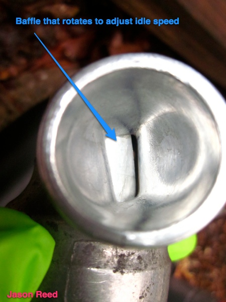

Post by polskamafia mjl »
Can someone explain what rotates on the IAC? JReed mentions twisting the IAC in your hand and making sure the plate rotates freely. I have a spare IAC and I don't see any possible way of twisting it and getting anything to spin. :?
jreed
Posts: 1665
Joined: 08 Mar 2009, 05:43
Location: RTP, North Carolina
Has thanked: 384 times
Been thanked: 221 times
Post by jreed »
Good question! If you twist the body of the IAC briskly in your hand, the internal baffle plate will rotate as well. When the passages are nice and clean, the plate will rotate easily without sticking or hanging up.
Internal baffle of IAC valve.  Twist IAC in your hand and the baffle will rotate (if clean).
Volvo 855 IAC valve showing baffle.jpg (89.66 KiB) Viewed 2670 times
Thanks! That makes perfect sense now.
