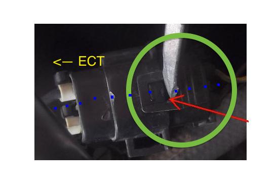

Yeah, that's kinda where I feel I am. I might just solder the wires together and call it good. I'm a little hesitant to cut the end off of the ECT that I just dropped $73 on though. :\ I'll probably hit the pull-a-part nearby, looks like they just got a '98 V70 in a week or so ago.
Just for reference, this is the broke part (ignore the red line, I stole the image from the beginning of the thread).

Oh, no, that was just an illustration. It crumbled. The wires pulled out from the back of the harness, etc., so it's totally unusable.

I'm at work and the car is at home. Just imagine the wires coming from the car into the harness connector, sans the connector. So it's essentially just wires. I was having trouble removing the old ECT connector. After everything broke, I noticed some green corrosion in one of the connectors, so I assume the old ECT corroded to the harness and that was the cause of the break.

This corrosion and failure is very common. Junkyard is an easy solution, as you suggested. The same connector is used in other places, I think the foglights are the same?
