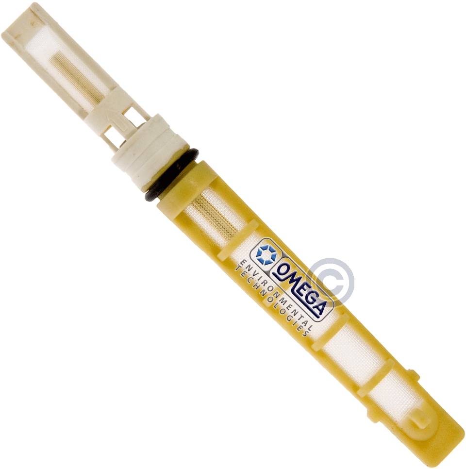

OK doing some more reading. No need to pull another vacuum on the system. Each side is connected via the orifice tube.
That small copper tube connects both sides of the system. When a system with an orifice tube design is shut off both sides equalize in pressure. This is also why a system with an orifice tube has an accumulator - to serve as a place for refrigerant to pool and expand to the vapor state before sending it to the compressor.
In a system with an expansion valve (not ours), a receiver is used. It is placed after the compressor and before the expansion valve. The receiver contains liquid refrigerant and serves as a means to supply the expansion valve with liquid refrigerant continuously. No accumulator is used because the expansion valve closes off the high and low side of the system preventing liquid refrigerant from migrating from the high to low pressure side.
I'm going to add more refrigerant to fully charge the system and see where that gets me.
