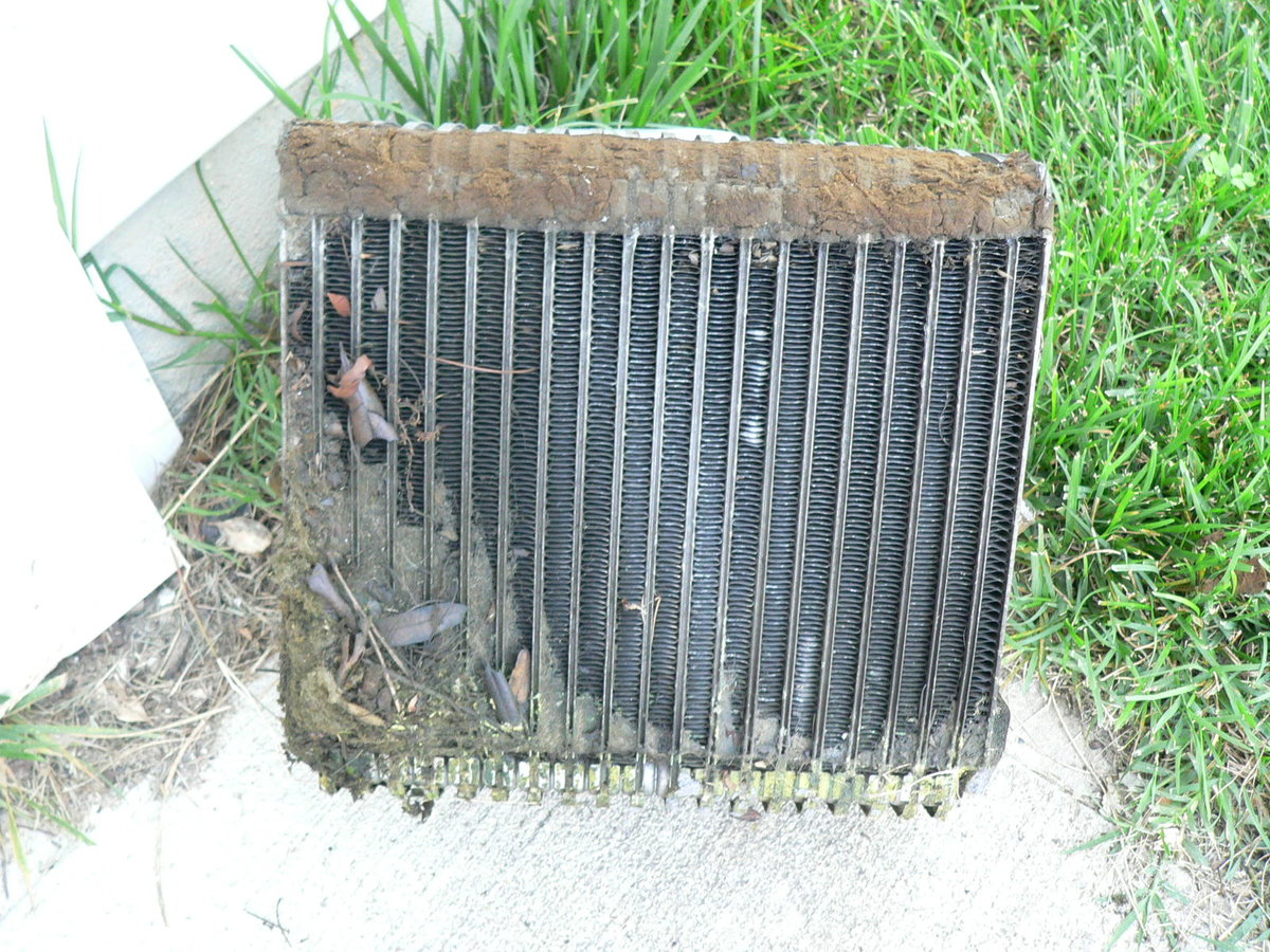

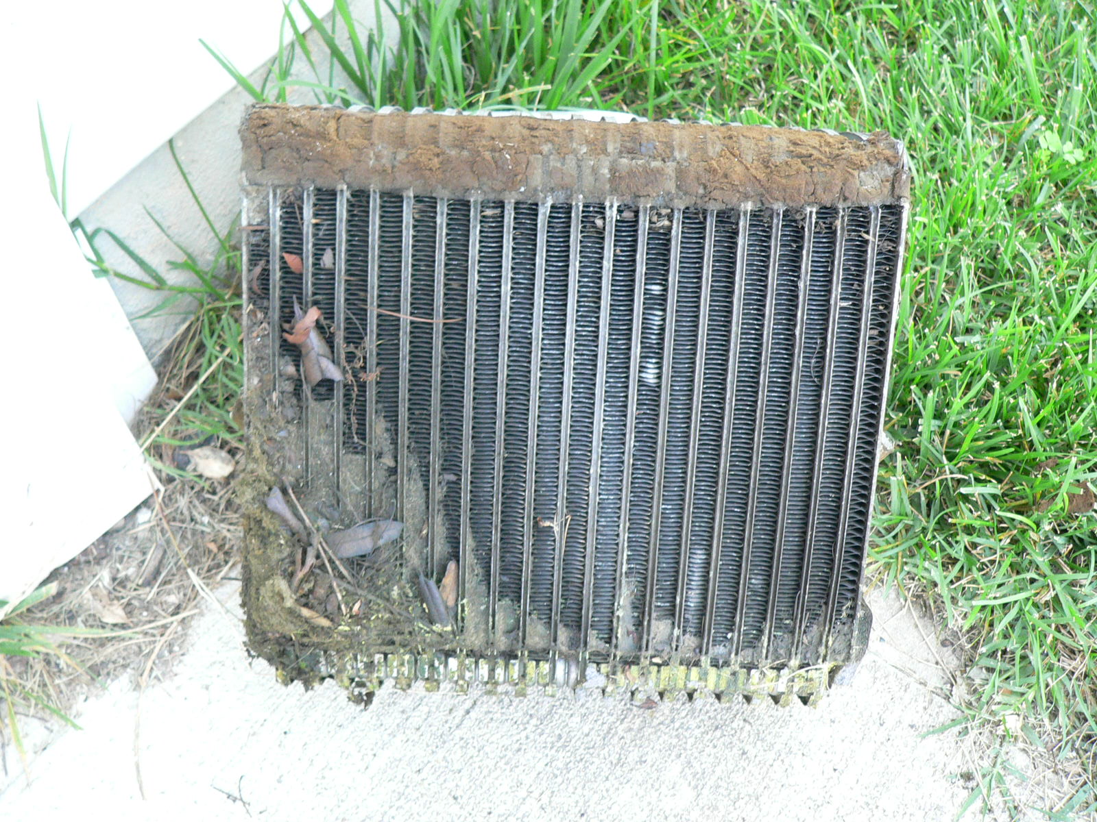

P.S. Here is my evaporator...smells MUCH better now!!
Volvo 850 evaporator leak

Congrats on your successful repair, and send me good kharma points. Charging my AC is up either this weekend or next..
That's a nasty looking evap core....looks like Jimmy Hoffa might be stuck in there too..
