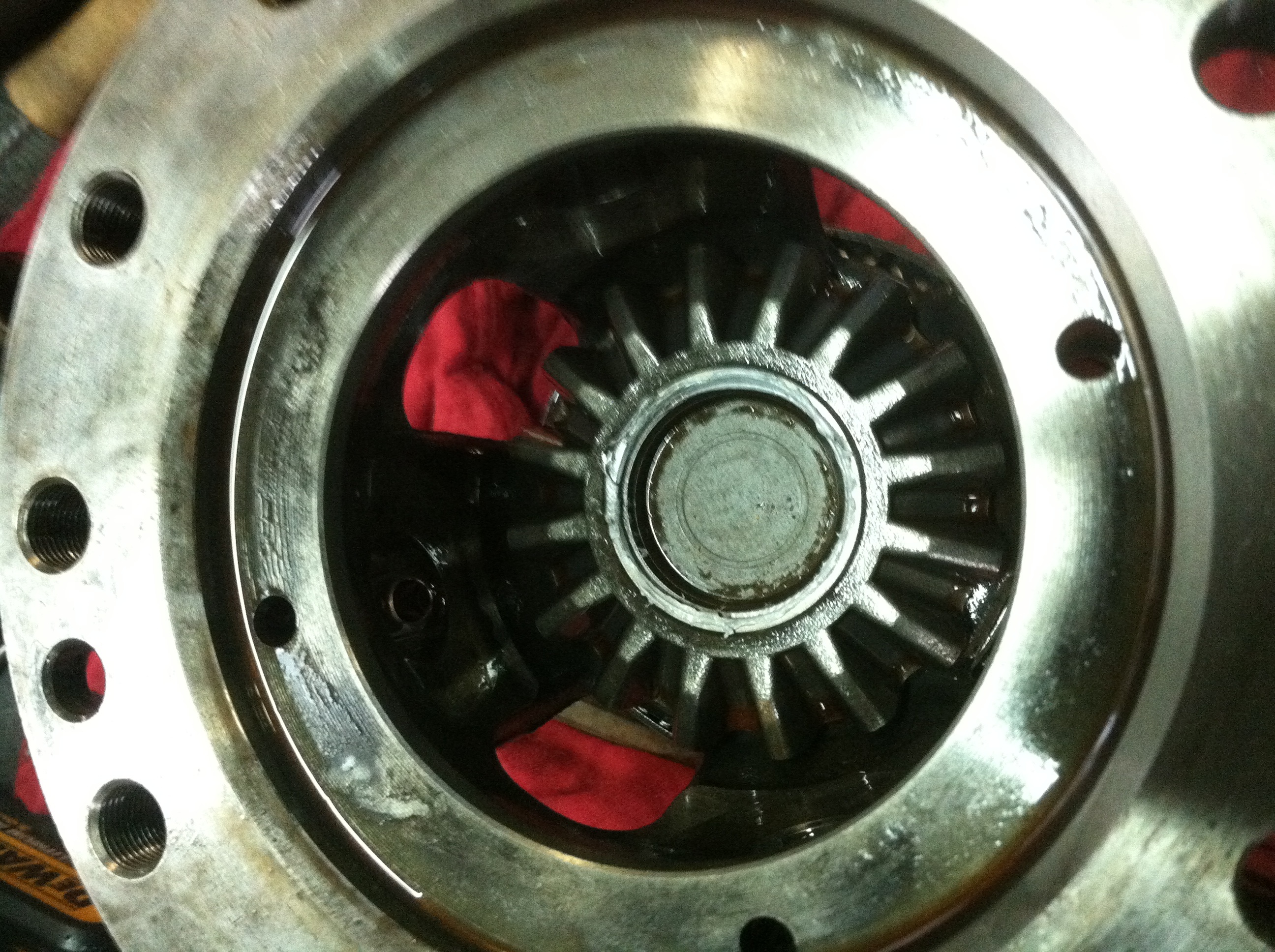

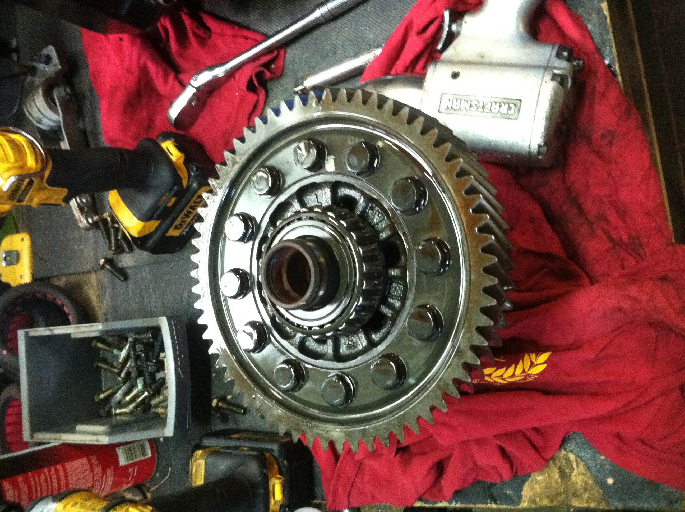

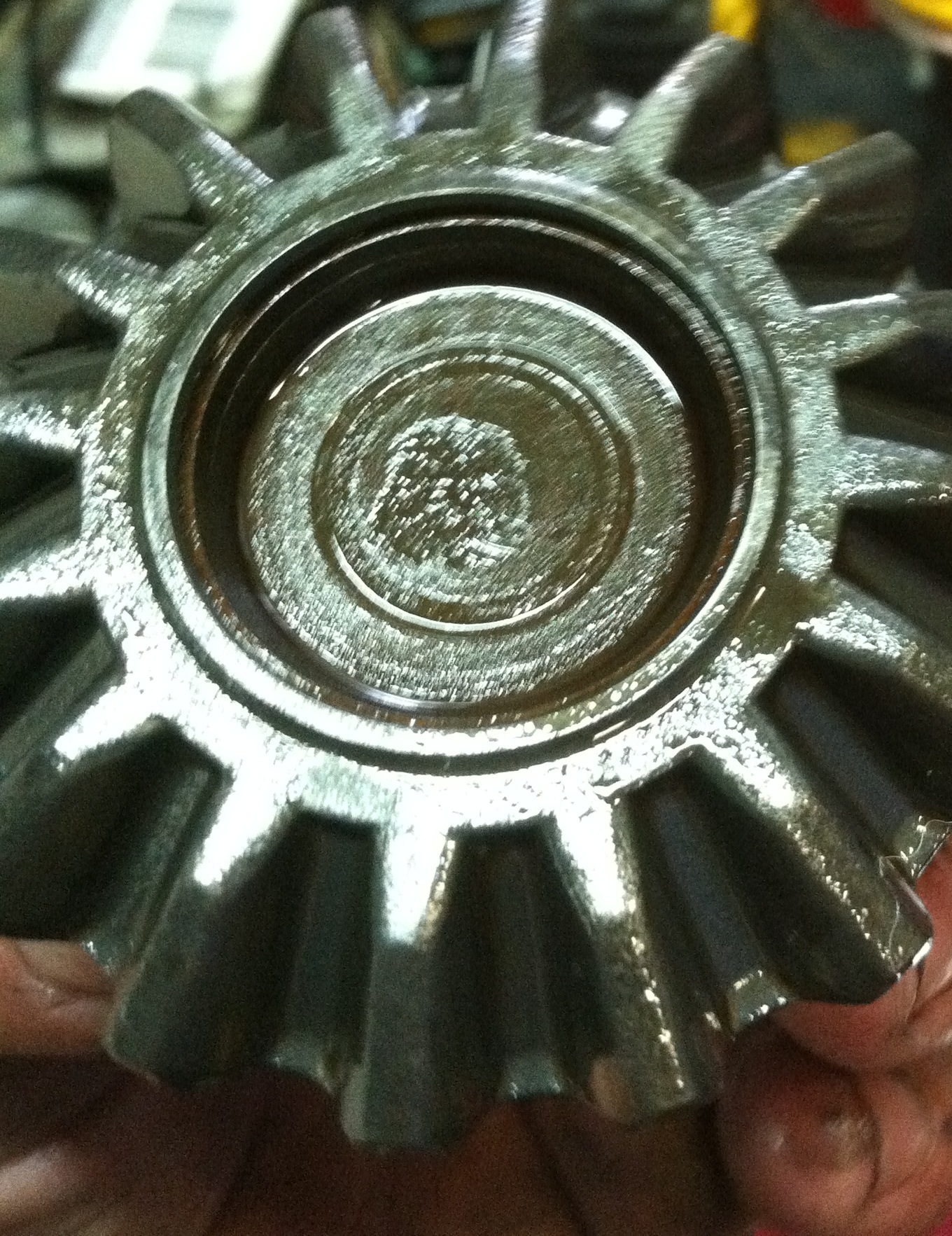

Good work.billybobo wrote:All fixed. Cracked the case and took the diff apart and reset the sealing cup on the inner side of the axle shaft.
Thank you for the photos.
In your comment above...
is diff = angle gear ?
what part is "sealing cup on inner side of axle shaft"?
does it appear on the two diagrams posted july 12?
