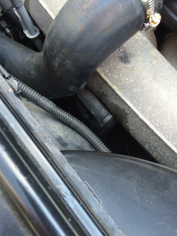

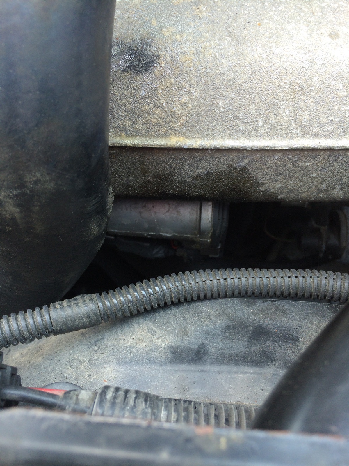

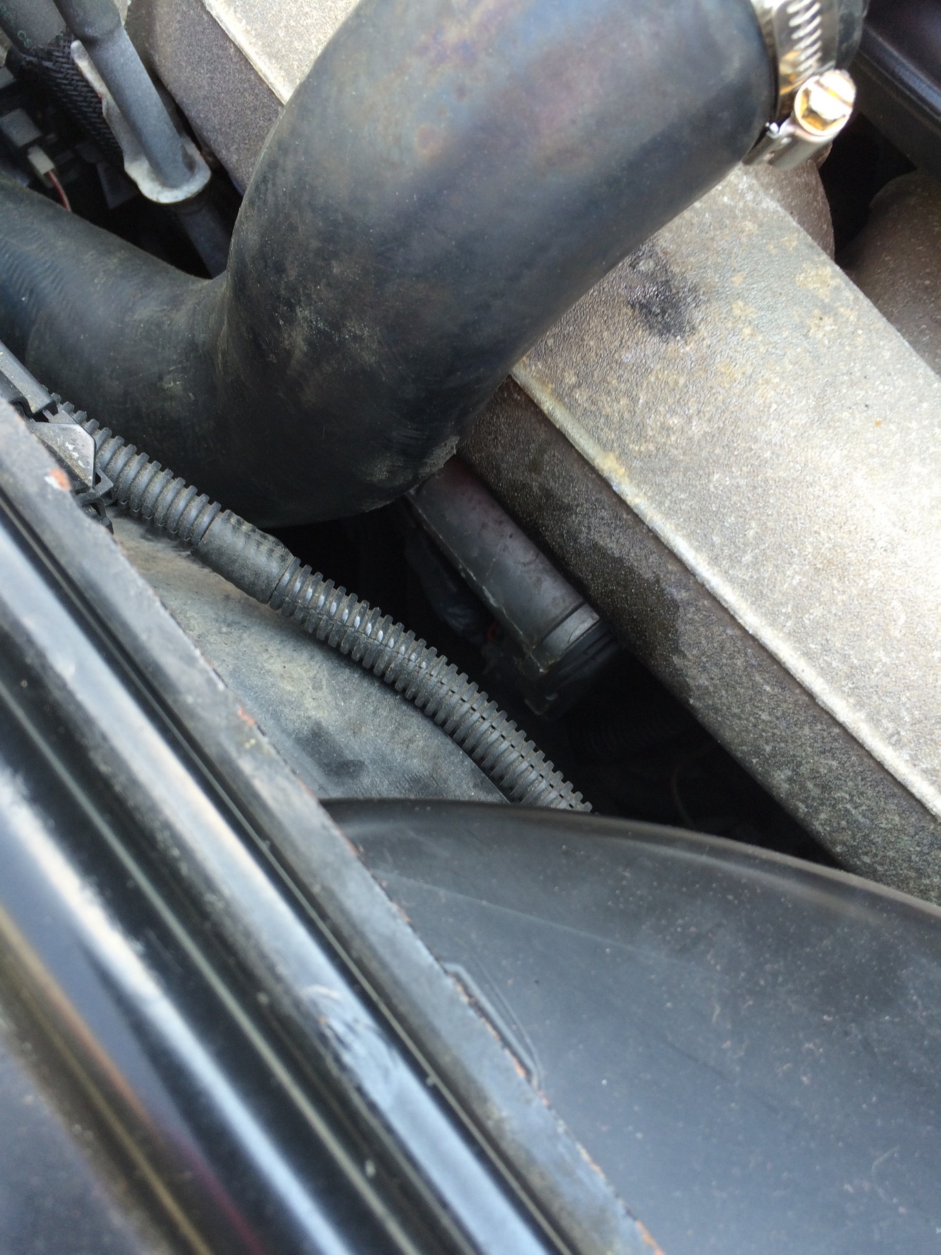

The picture would help immensely. In fact you're in the wrong forum because this forum was devised specifically for the Magnetti Marelli units.
I think it's a Bosch unit for the 2002 S80 turbo. These were also shared with later S40s. The units themselves are extremely reliable and not prone to the board errors of the Magnetti units because the logic (thinking) part is done by the car's engine computer well away from the extreme heat of the engine leaving only a flap motor and angle sensors on the unit.

Ok, I will send picture .
Recall Volvo describing unit as round. Said should be square. Said from later model, maybe s40.
Said it was not a throttle body but throttle something. Don't recall exact term.
