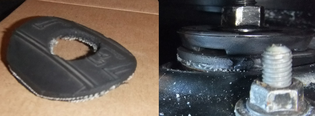

I zipped an email to CS at the webstore where I got the spring seats (and new struts). They seem confident this large clearance between the top washer/mount bearing is the way it is supposed to be. I respectfully disagree. This is not the OE design (read bottom para).
See pic, bottom. Used rubber from sidewall off an old tire (quality rubber, nylon reinforced, should last). Installed between mount bearing and top nut (cross shaped one), hence the hole in the middle. Clunky-Thumpy over bumps/RR tracks/potholes GONE. Handling/tracking over said obstacles DRAMATICALLY IMPROVED.
I got an alignment while I was in Chicago last week. It tracked excellent on smooth road (before and after the alignment). However the instability and noise over bumps/holes remained. Went over it again with a comb. Couldn't find anything wrong then I remembered not being terribly confident about the top end when I put it back together a week or so back. Was thinking at the time "it doesn't seem right to have loose play up there, maybe on the car spring tension will keep it tight". Well, yes (if you're sitting still)...but no.

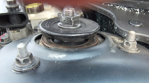

All Volvo OE parts except strut mount from Lemforder, which is OEM. No signs of rubbing wear on upper edge of mount, i.e. mount cap and mount do not meet. Are you using old sagged springs, which can't do their job anymore?
Also how this tiny gap can worsen handling of the car? Toe angles already jump back and forth like crazy when suspension works to the full depth. Camber change on rebound is unmeasurable.

Mine looks same as yours, vtl. The ride on my 850 is far better than V70XC. Handling over uneven road, manhole, and bumps V70XC does wobbles way to much than our 850.vtl wrote: All Volvo OE parts except strut mount from Lemforder, which is OEM. No signs of rubbing wear on upper edge of mount, i.e. mount cap and mount do not meet. Are you using old sagged springs, which can't do their job anymore?
I feel OP is insightful here. I will explore more this too. The gap is star nut.

I have P2 V70 with new suspension and exactly same gap. It handles way better than XC70. Reason? It's obvious: lower ground clearance.xHeart wrote:Mine looks same as yours, vtl. The ride on my 850 is far better than V70XC. Handling over uneven road, manhole, and bumps V70XC does wobbles way to much than our 850.
Both cars don't have any noise in suspension and handles great over road imperfections. I take XC70 to a slight offroad for my mountain bike exercises, it handles predictably.

They ALL have the gap, this is normal

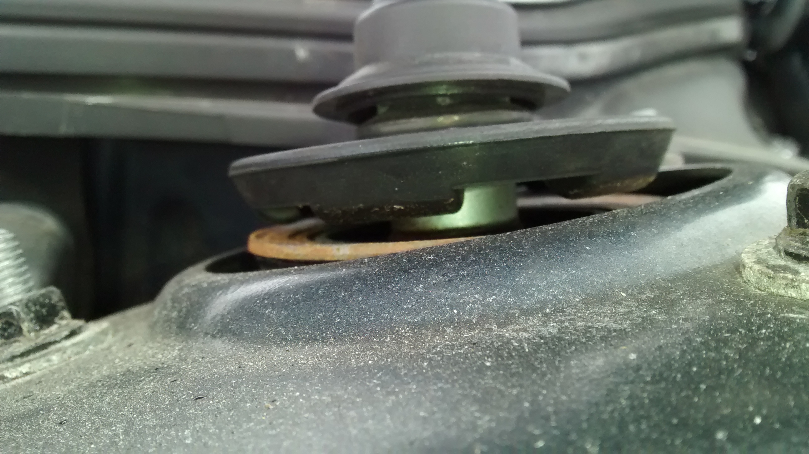

Finally got around to putting OE upper spring seats back on the car.
On smooth highway/good roads no noticable difference. However, on bumpy/poorly maintained county roads the difference is night and day.
Looking at the two and how it fits together what I notice: The aftermarket seats have a tapered/conical shape where they go through the mount/bearing (the OE seats are straight/cylindrical). Also on the aftermarket: top caps sit higher after installed/wheels on the ground. With the assembly off the car or wheels off the ground the OE seats' rubber flexes and the top cap rests on the top of the bearing. On the aftermarket ones the cap is positioned higher and the rubber does not appear to flex.
Clearly Volvo designed the seat to drop down through the bearing under certain driving conditions, with movement limited by the top cap. The aftermarket ones both allow more movement than originally designed, and the tapered/conical shape introduces caster/camber play during these conditions.
So I stand by my original assessment: don't use those aftermarket seats. The OE ones may not last as long but it's not really that difficult to change them (I did both sides in just over 2 hours). Stick with the Volvo OE spring seats.
