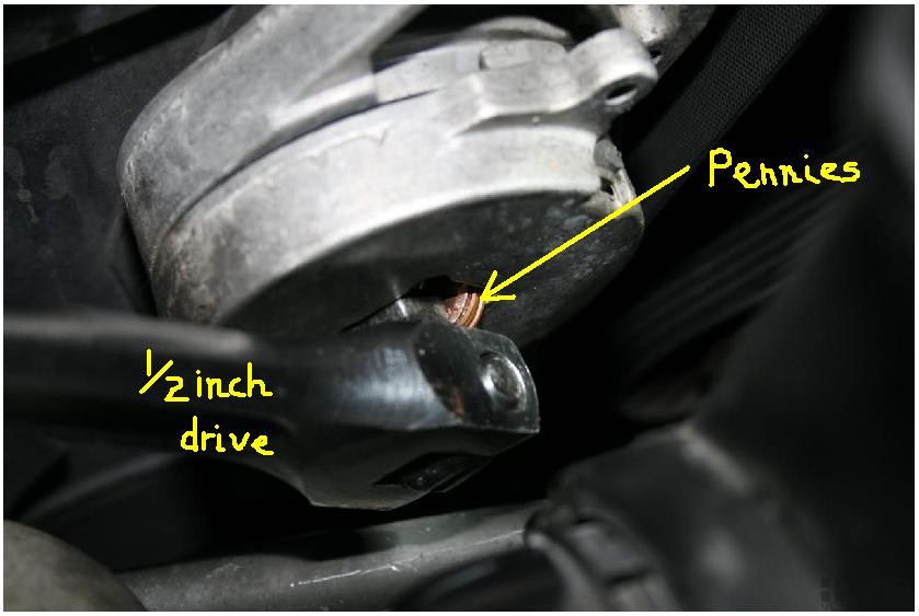

Im not confused about orientation, eld4au6 says that only a crescent is needed, Im saying that the crescent wrench in the picture is clearly attached to a (not stock on the rest of our cars) square that is inserted into the tensioner. We are not discussing what you use to torque the tensioner, but what actually inserts into the tensioner so that leverage can be applied. Quote "all you need is an open end wrench..no need for a tool" Yes need for a tool. The rest of our tensioners dont have a metal block sticking out of them to turn with a crescent. Every one else has manufactured some simple item to fit the tensioner, obviously this guy or his previous owner has built something and after using it probably couldnt get it out, now someone thinks that its part of the tensioner.eld4au6 wrote:You all do know you can use a open end wrench on the tensioner. No need for a tool.
its on the pulley below the shown wrench and tool.

osman,eld4au6 wrote:...Im talking about the square-ish end of the tensioner that the idler pulley is attached to, can remember what size it was but I used a open end wrench from the bottom of the car.
You focus in that square hole. "eld4au6" focuses on the square thingy lower down.
The quote above is what I referred to. I think "eld4au6" has his point.
I sketched in BLUE color above.
No need for any tool if you use an adjustable wrench from below!
Basically there is more than one way to skin a cat!

Now I get it. Your diagram makes it clear. I just wanted an explanation that the wrench in the pic is not the wrench he was writing about. Showing a picture of one method while writing about another was creating too much cognitive dissonance for my tastes. But I love the idea for its simplicity. Sorry for thread clogging.

Phew, have fun releasing the tension from the bottom and inserting a pin in the top to lock it down.

Yeah, after hauling out the floor jack and stands just to be able to access the tensioner from the bottom, it doesnt seem like a time saver. I try to avoid doing anything from the bottom that can be done from the topside.

The pennies work, but I end up mutilating one of them and costing me one cent every time.

+1 for pennies trick!
