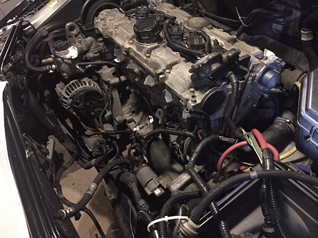

Wow, so much space... most protective electrical wire sleeves are now replaced and tapped.

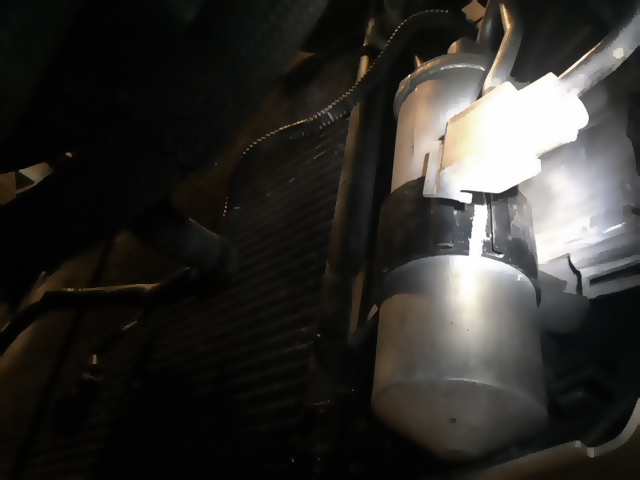

Now working on replacing rear exhaust camshaft seal as part of PCV project. Found cracked bracket for Receiver Drier at condenser: Is there a fix? The pipe coming down from the drier is unhinged at bracket.

I could replace IPD's charged air silicon coupler at turbo with Volvo's if build up continues after the PCV service.
The surface below rear exhaust seal and around BCS is layered with oil soaked grime. I'll add it to my clean up and watchlist.
Replaced the sealing ring at rear exhaust camshaft. Found two bites on the surface of the yellowish ring at 8 o'clock and a tiny one at 4 o'clock. Is it normal?

I'll be removing the intake manifold tomorrow to touch up on the PCV cleaning done by the previous owner earlier this year. I'm getting the ECM-121B from the intake manifold gasket leaking. The gasket appears new so they must of not cleaned the intake manifold nor header before re-installing.

It's easy to foul something like a metal bracket when you install the intake manifold. Not too tight on those bolts, I think they are only 10 ft lbs or so. Don't strip the block.

Comparing the new and old rear camshaft seals, both Volvo, old seal appeared fine but lost its outer treads -- flat. Came off gently with a pull at the screw.
I was able to separate fuel rail from the intake with relative ease. Brushed it clean of dust and let it sit overnight with few drops of WD40 using a syringe at injector fittings. The injector seal at the intake have lost roundness, plasticky and hardened at touch. Thinking about replacing seals. Any thoughts on how to?

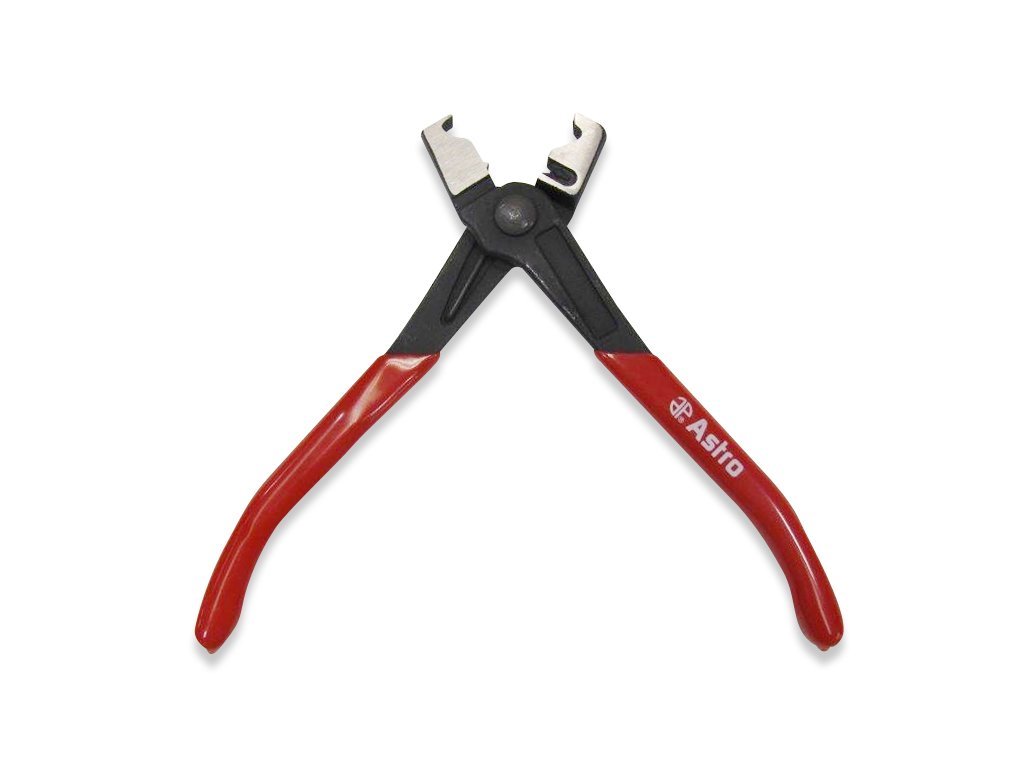

My new tool:
A timely reminder. Thank you!

My new tool:
