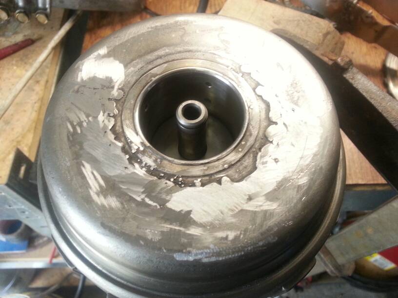

Ordered a mig welder online so I can finally learn how to weld and stitch up this cracked drum. I'm keen on getting this transmission re-installed in the next 2-3 weeks. I've refurbished the valve body with a Transgo kit.

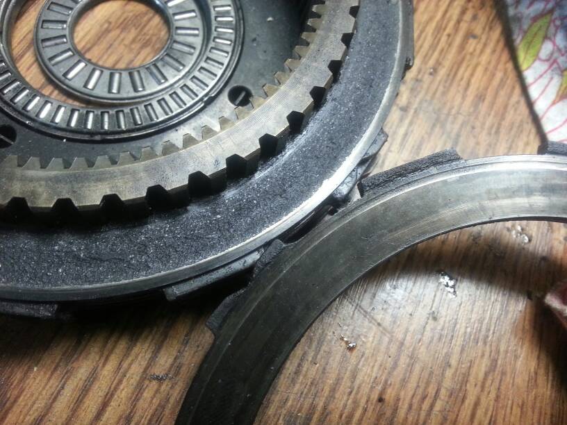

I have welded the cracked drum and closed up the hairline cracks.
Having burrs on the inside of this drum has caused the friction plates to be forced together instead of allowing fluid pressure to do the job.
As you can see on the friction plates there is no friction material and the result is metal on metal contact. This is what causes the lack of reverse due to 1st gear and reverse gear plates binding to each other.
Causes?? Lack of regular fluid replacement and metallic filings finding their way to places they shouldn't.
I'm hoping to order a friction set for this transmission soon as funds allow. I'll keep updating as progress occurs.
