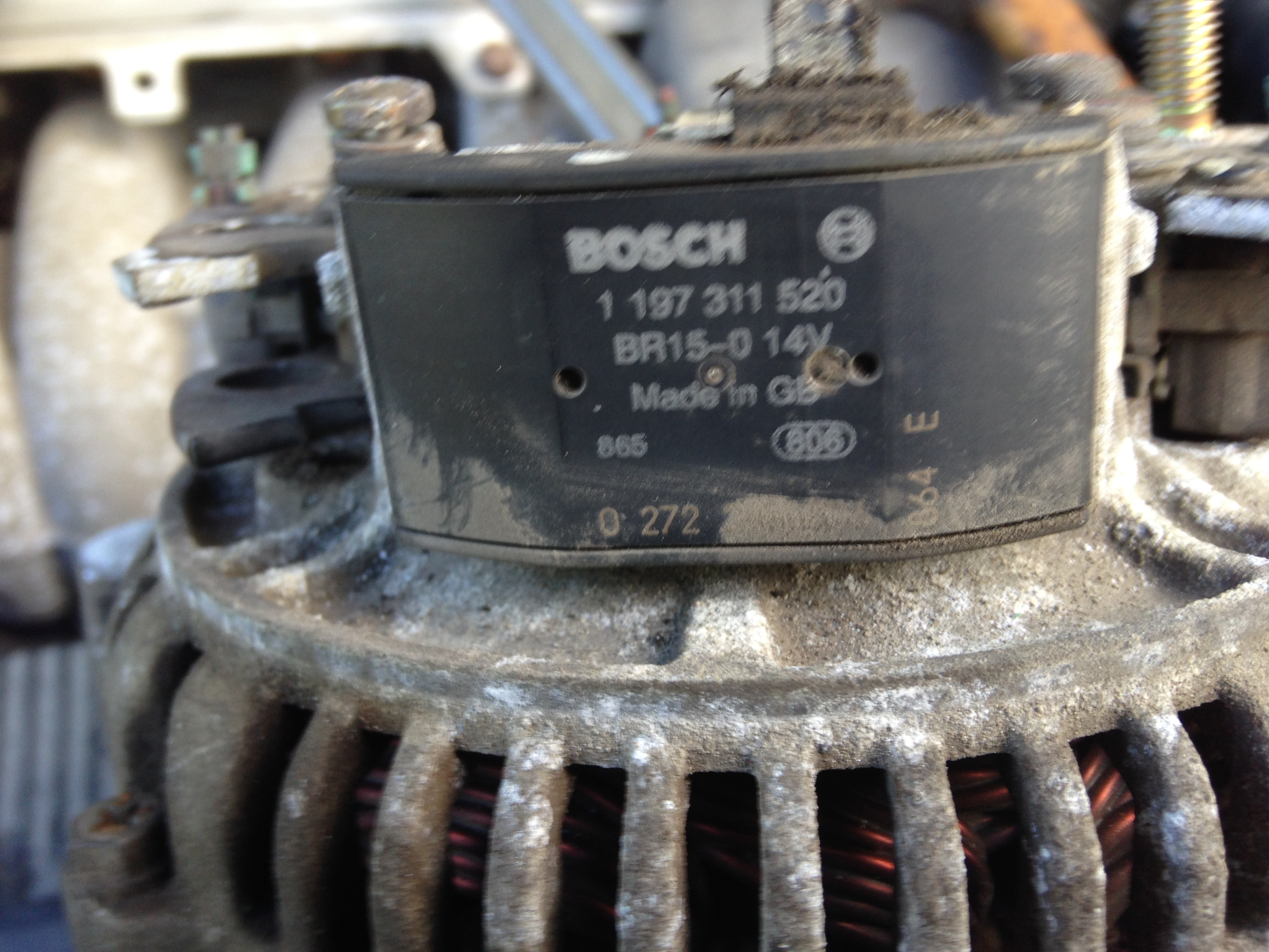

I found the BOSCH 1 197 311 520 for $25 at an Electric supply company in Dallas, TX

Kanabea wrote: 22 Jun 2020, 13:05 I found the BOSCH 1 197 311 520 for $25 at an Electric supply company in Dallas, TX
https://www.maniacelectricmotors.com/80 ... 1592850870
I just looked this over and am not convinced its Bosch. Reading the lines and looking at the picture, it looks like a knock-off
Update - Ive ordered one since all the brands are now outsourced remanfuacturered in various overseas countries
Will update my experience here.
