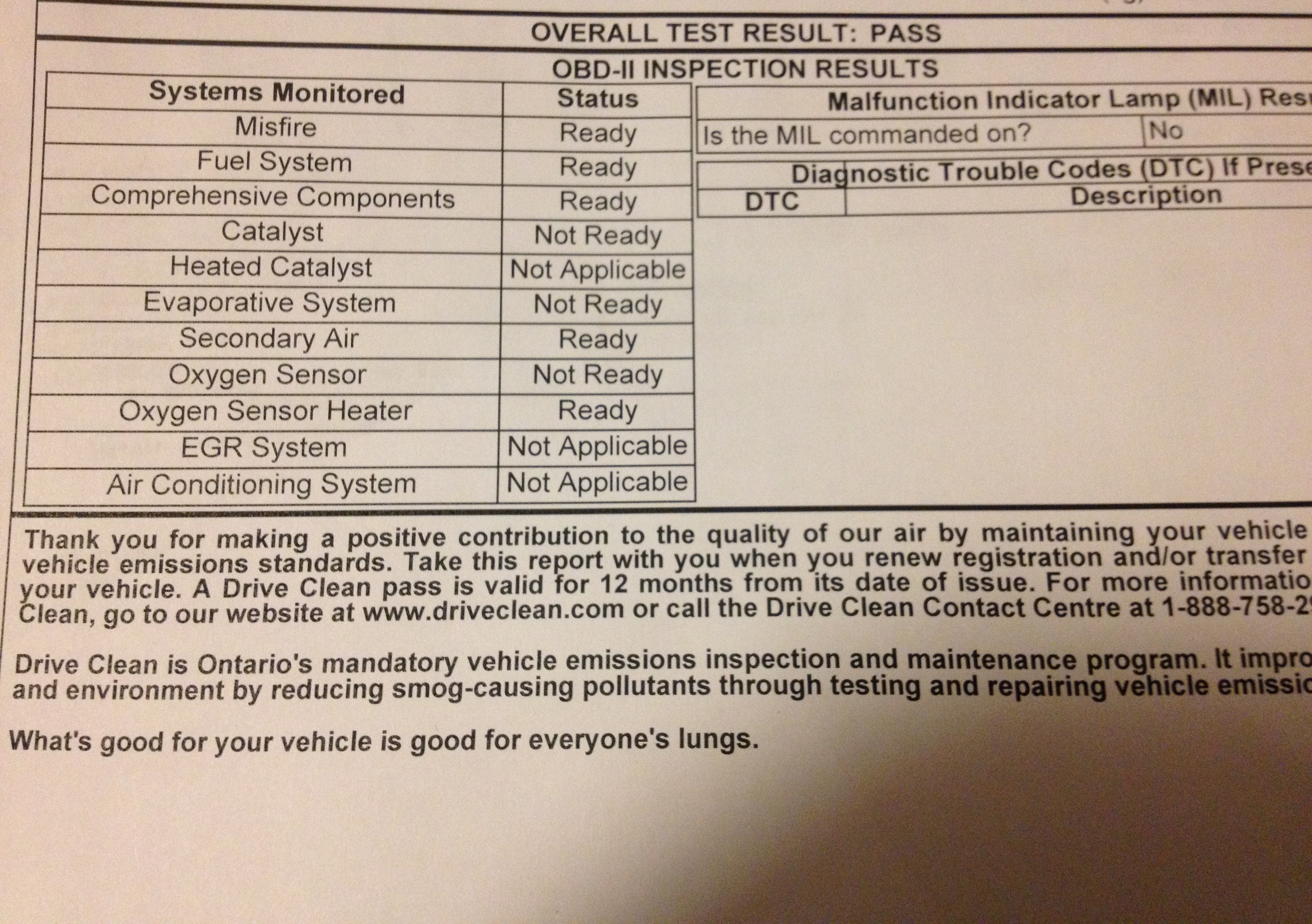

UPDATE: E-Test was successful. I ran two readiness tests, the first one I'm not sure the temp was right, I followed instructions from one site that said for temp to be below first line which is incorrect, you need to measure the coolant temp directly 29C to 49C. Which is probably why the 02 Sensor and EVAP was not "ready" but apparantly you are allowed a certain number of not ready indicators!
So will its not conculsive that I fixed all the codes, so far so good and I didn't change the O2 sensor. I cleaned the purge valve and ALL the vacuum lines and did a tune up. Hopefully the O2 sensor stays okay, it is pretty much welded into the bung. So before you change parts, do your research!

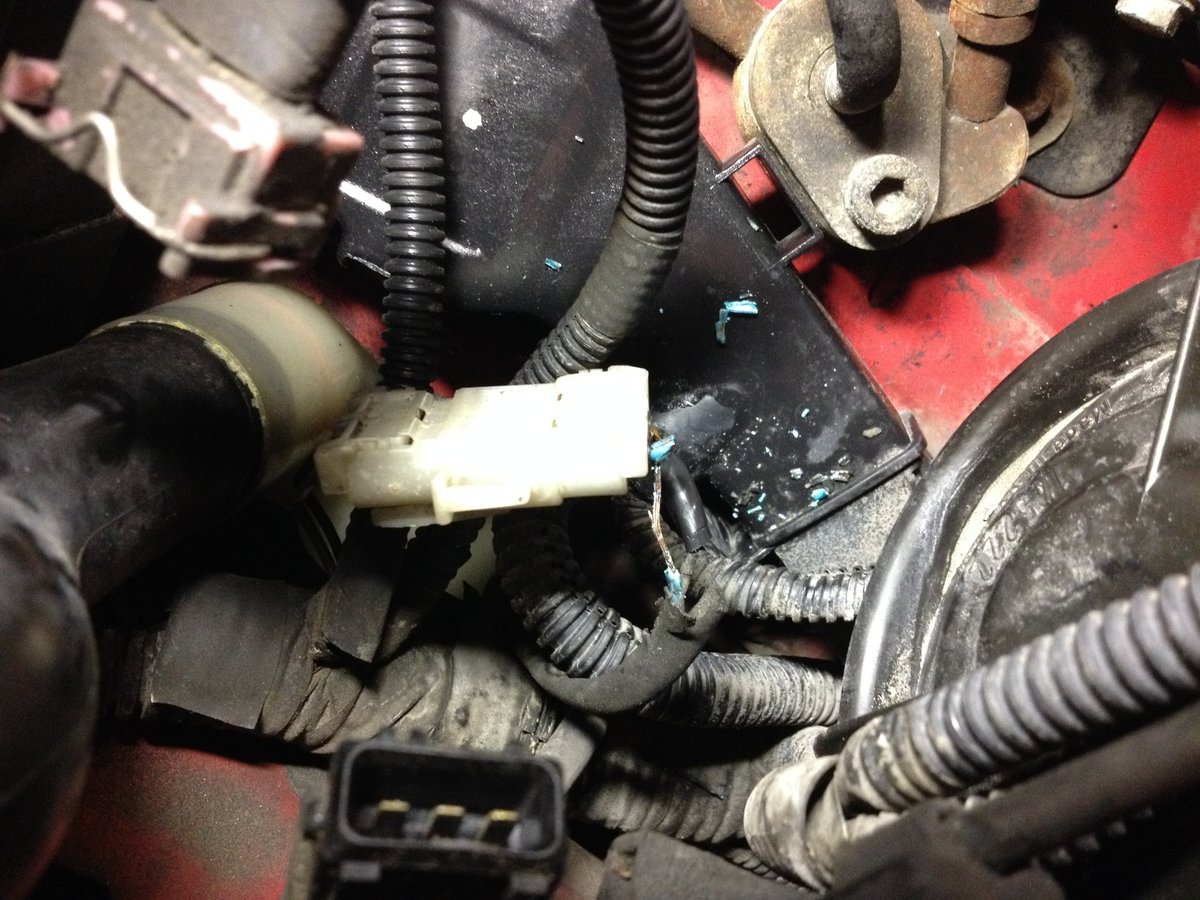

I noticed an electrical connected on the front passenger side of the engine bay: the insulation on the wiring was crumbling, I removed it and taped it. Does anybody know what this connector is for?
no insulation on wires!

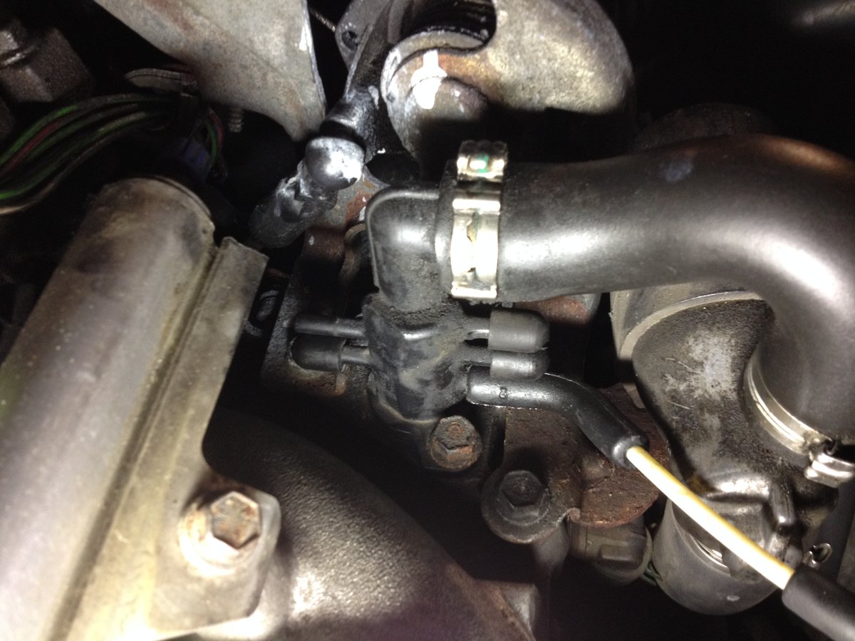

I accidently lost 1 of the 4 nipples that is used on the Idle Air Control valve, when I was cleaning the ports.... Oooops! I was so mad, hopefully the dealer sells it.
lost the nipple! like a baby w/o a nipple I was sad!

- I don't recognize the connector offhand, would have to look at a vehicle and follow the wire back.
- For the nipple, just go to any auto parts store, that needn't come from the dealer.
