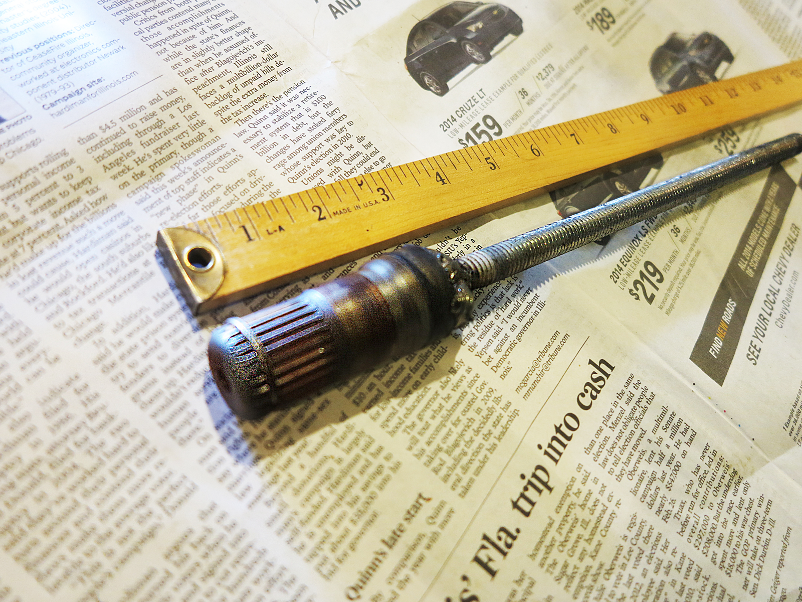

...a picture is worth a thousand words. JDS60R method!

Your suggestion of TEKTON slide hammer tool was timely. It provided clues. Thank you.kseyoum wrote:Congratulations! Thanks for the update and conclusion which I was looking forward to...
The original axles with 148,000 miles made noticeable clunk sound at first move, R or D. AFT replacements had mixed reviews.
I took it from cn90's post, then acquired a pair off of a 2007 with 53000 miles (seller claimed). Serviced the outer cv-joints, after installing the clunk has disappeared. Here is the post about axle service https://www.matthewsvolvosite.com/forums/viewtopic.php?f=9&t=62033.

A reminder to us DIYers that there is always a choice.chrism wrote:Good job!
Is it just coincidence that the extracted axle is laying on a newspaper ad for new cars? Hmmmmm. :wink:
Thank you ALL!

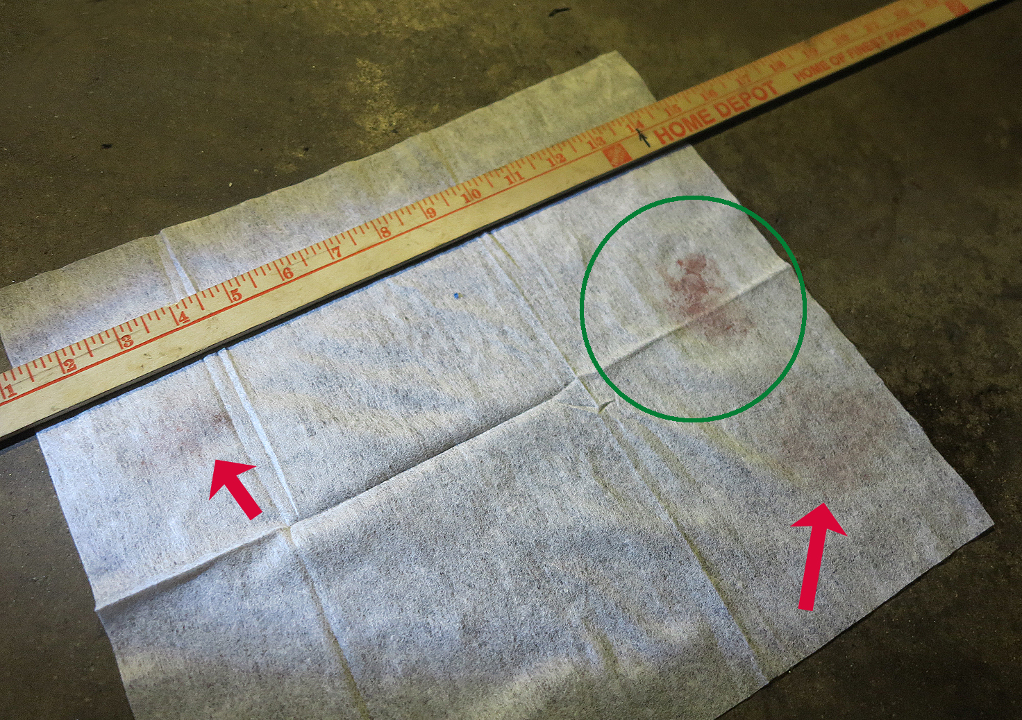

Added 2qts MOBIL 3309, and now keeping an eye on few drips on garage floor which is NOT consistent, not like each morning.
Here is a photo, red arrows point to older collections, mostly evaporated. New drive axle seal on at driver's side, or overfill?

A quick update...the drip was from ATF overfill little over 400ml.
