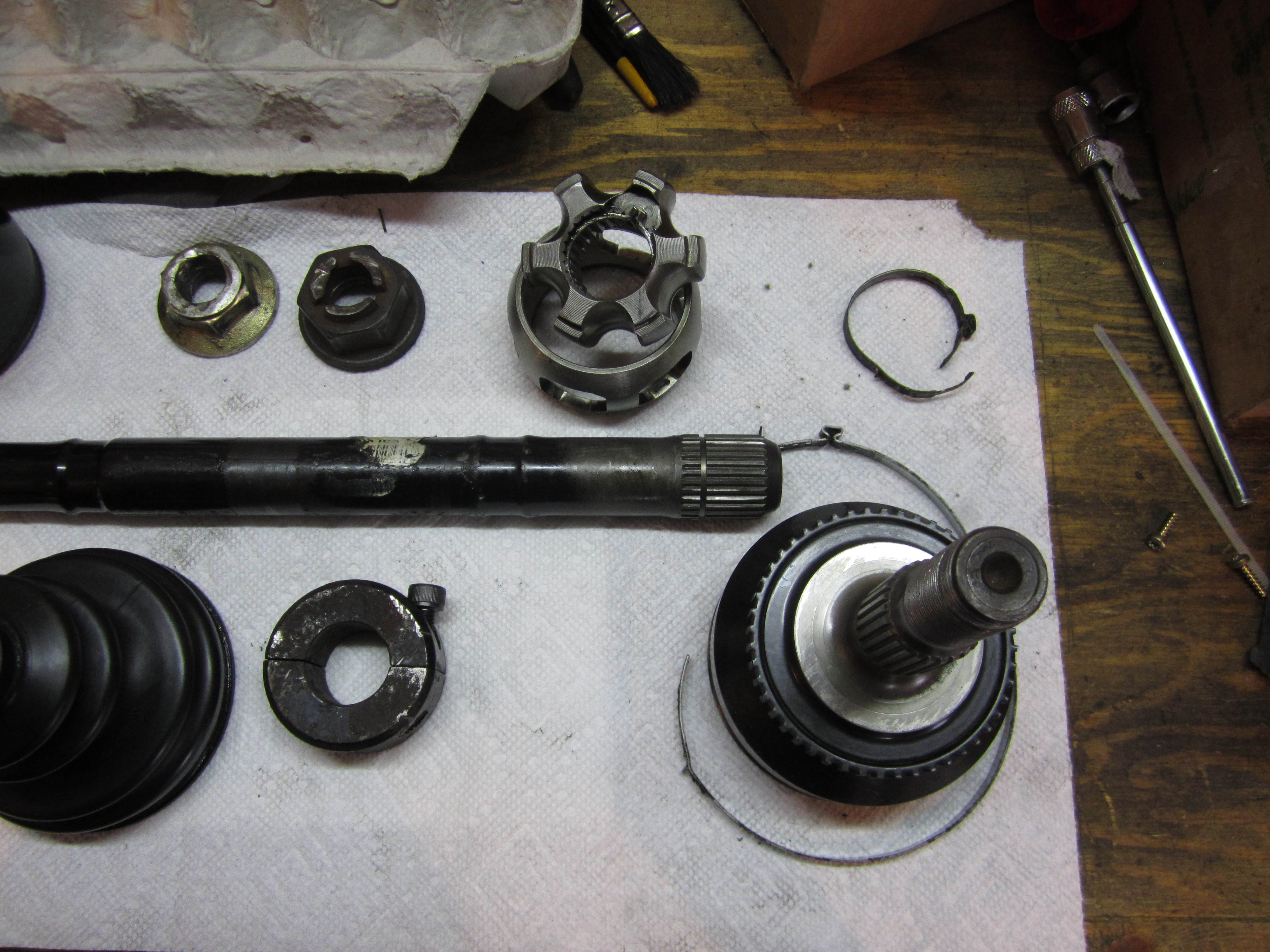

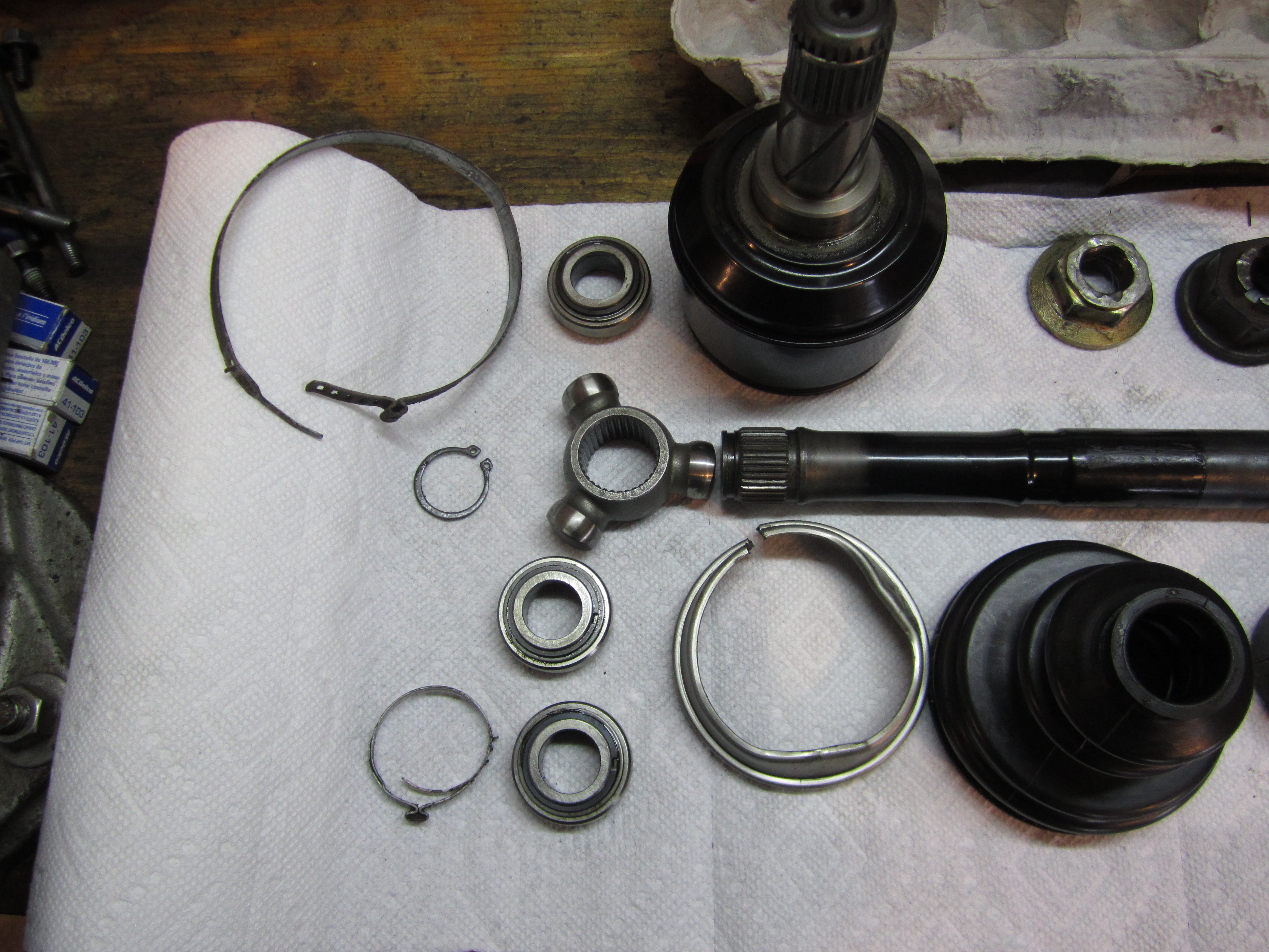

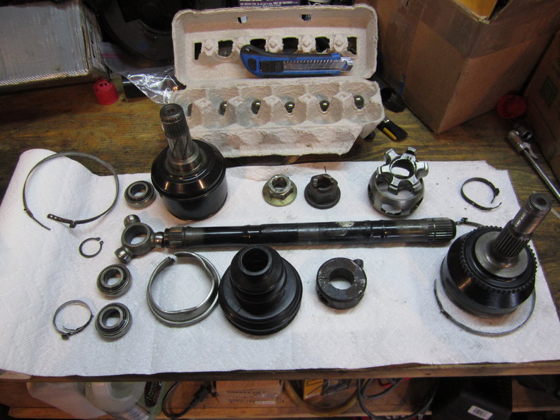

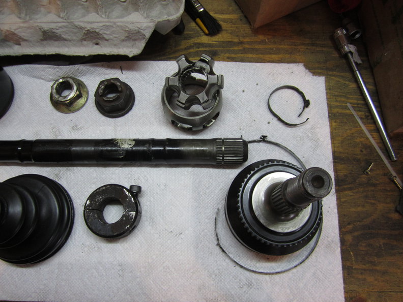

This picture shows all the parts of the LH front Axle except for the outer CV boot. Inner joint is to the LH end of the picture

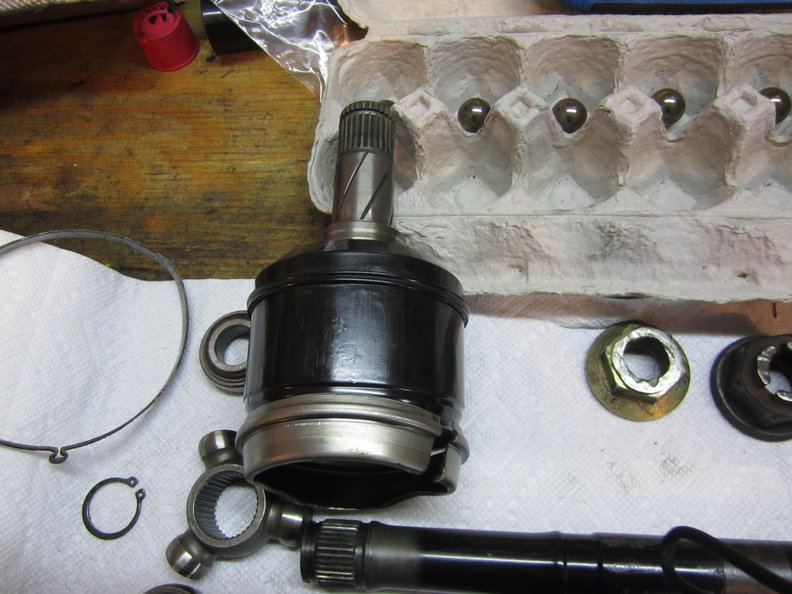

Inner joint parts. Note the damage bearing retaining collar with saw cut in it to remove. Any suggestions how to remove without damaging?

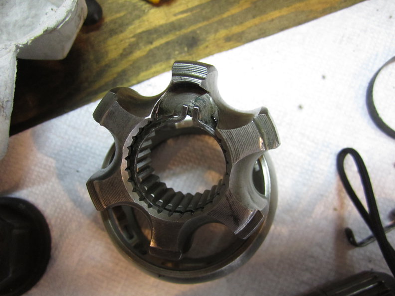

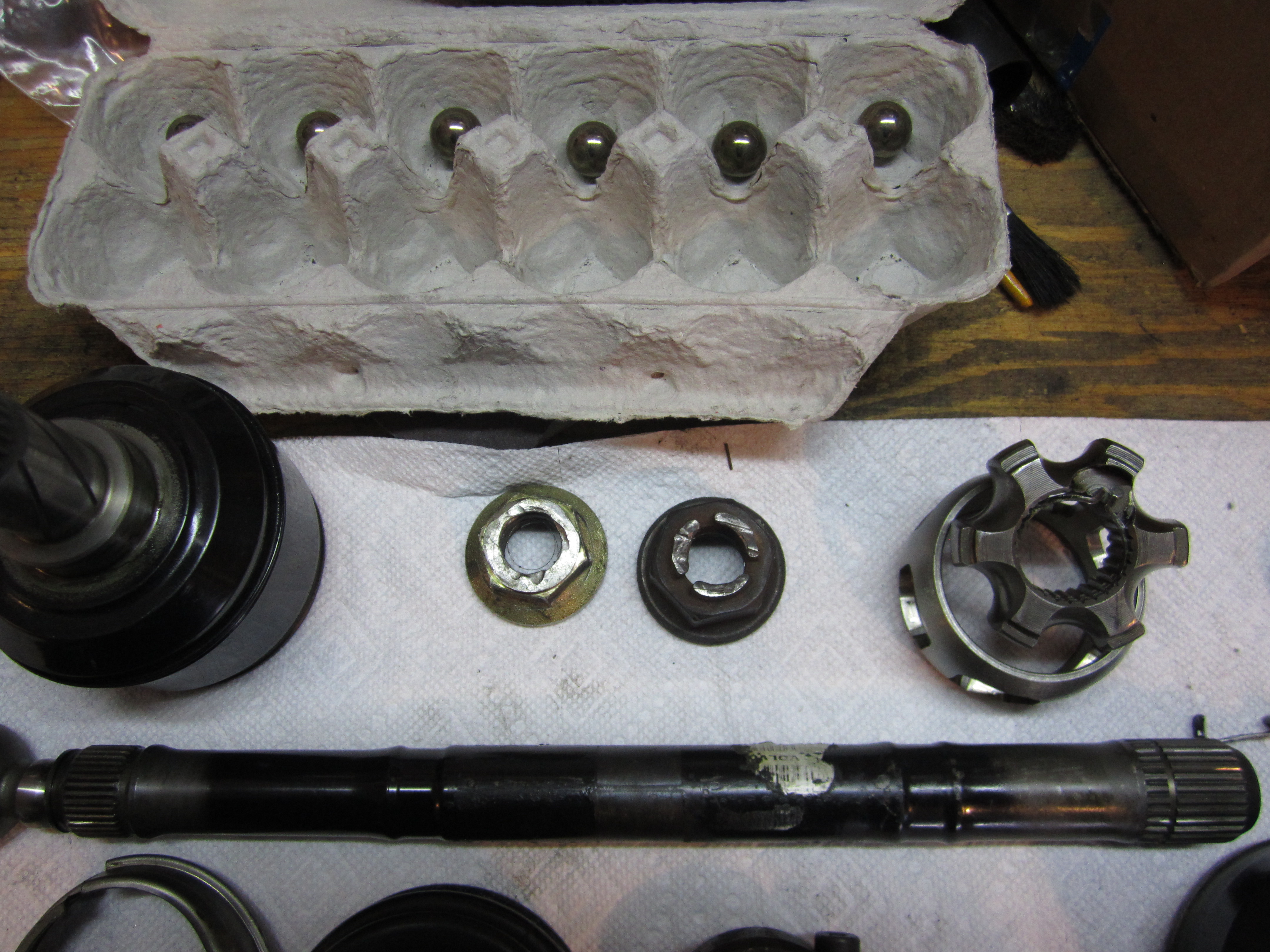

Outer CV joint parts less the 6 ball bearings.
Outer CV joint carrier and 6 ball bearings
Inner joint showing where the retaining collar should sit
Outer CV joint bearing collar. The upper part sits inside the lower part, and the ball bearings sit between the 2 parts. Not the retaining ring/collar. You cannot remove the outer bearing without expanding this ring using circlip pliers to EXPAND the ring as you hammer the inner collar to move it off the splines. You may have to use WD40 or some other cleaning compound to loosen the collar to allow it to expand sufficiently to remove the outer joint off the splines.

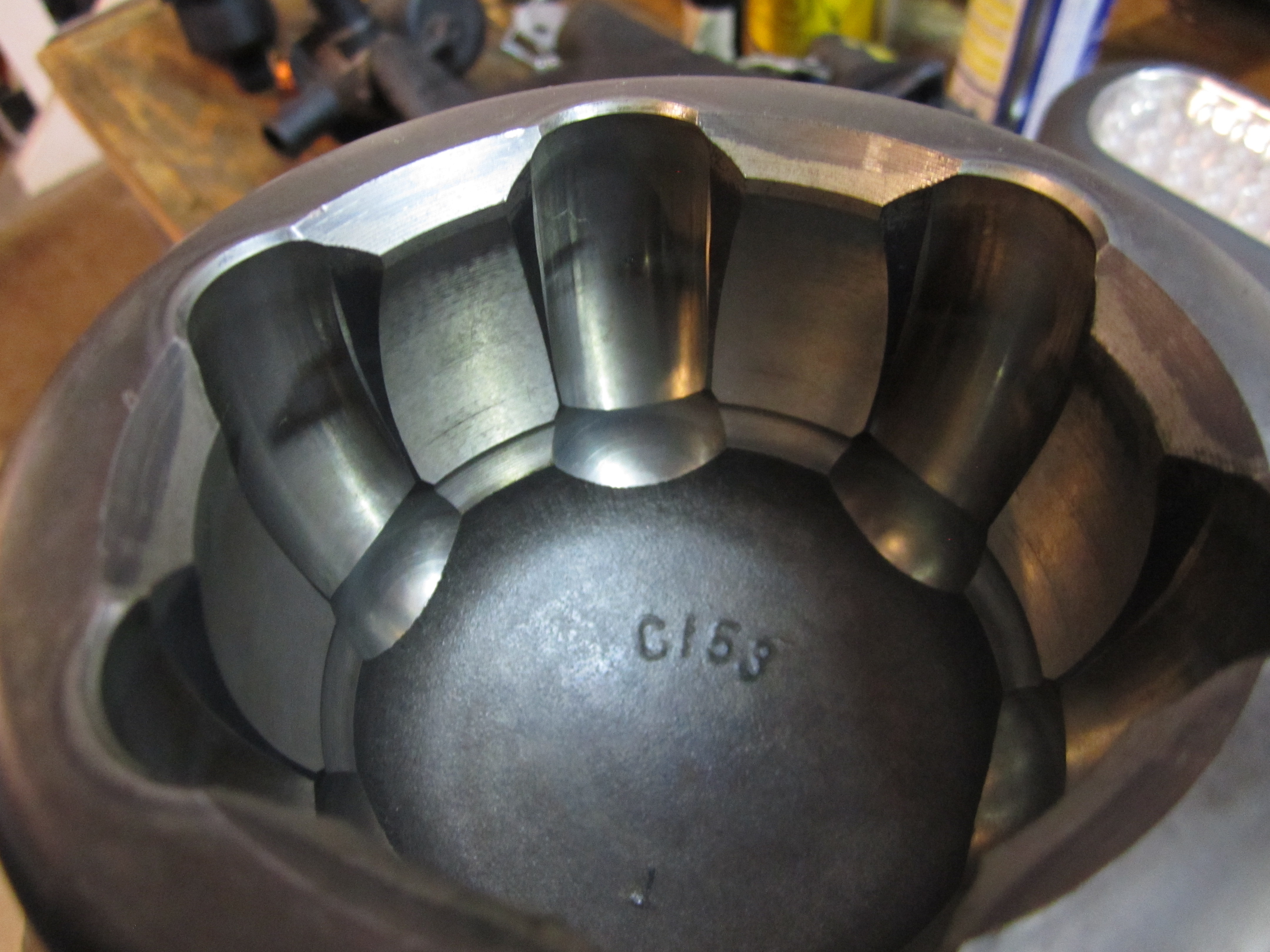

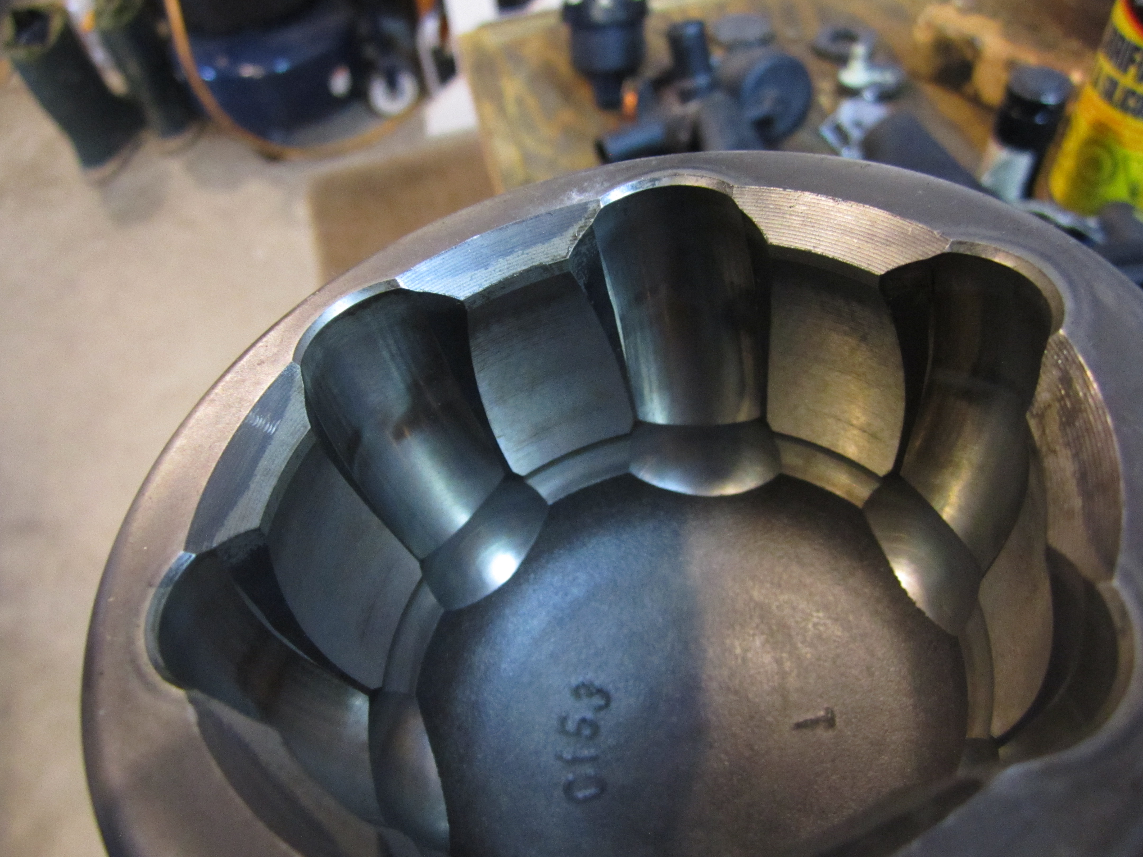

Wear/damage to outer CV joint. This is after 160,000 miles. Some may argue it could be re-used, but I have doubts if cost of parts v's a replacement unit makes sense. Any views?
2nd picture showing other half of the outer joint and wear.
One of the 6 baller bearings from the outer CV joint. It is dull and dis-colored which to me shows the outer chrome surface is worn.
Anyway, this is not really a how to, but more of a 'How it fits together and the parts it uses'.
Hope this may be of some use to others and feel free to add views or comments.
