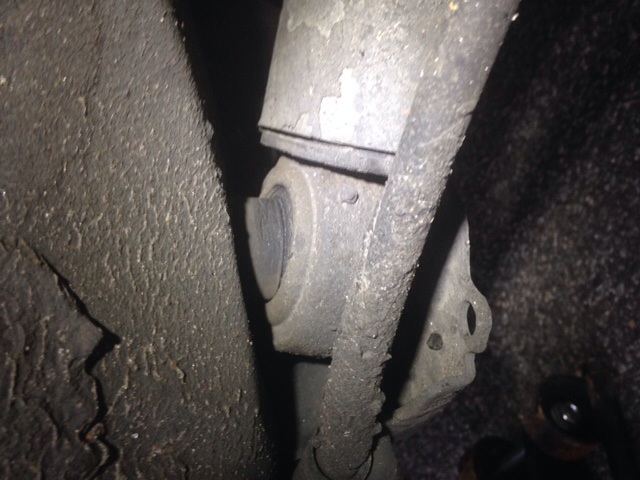

How does my delta link look for a 94' 850 w/ 260k+?
Driver Rear
Driver Rear
xHeart
Posts: 3321
Joined: 03 Dec 2011, 08:05
Year and Model: 2.0/3.2
Location: Great Lakes - USA
Has thanked: 116 times
Been thanked: 119 times
Post by xHeart »
Like new! (lol)
I would feel sensation each time taking a ramp, or exiting.
With load in the trunk or passengers in the back seat, it would drag.
Not sure, if I would replace it with that many miles.
