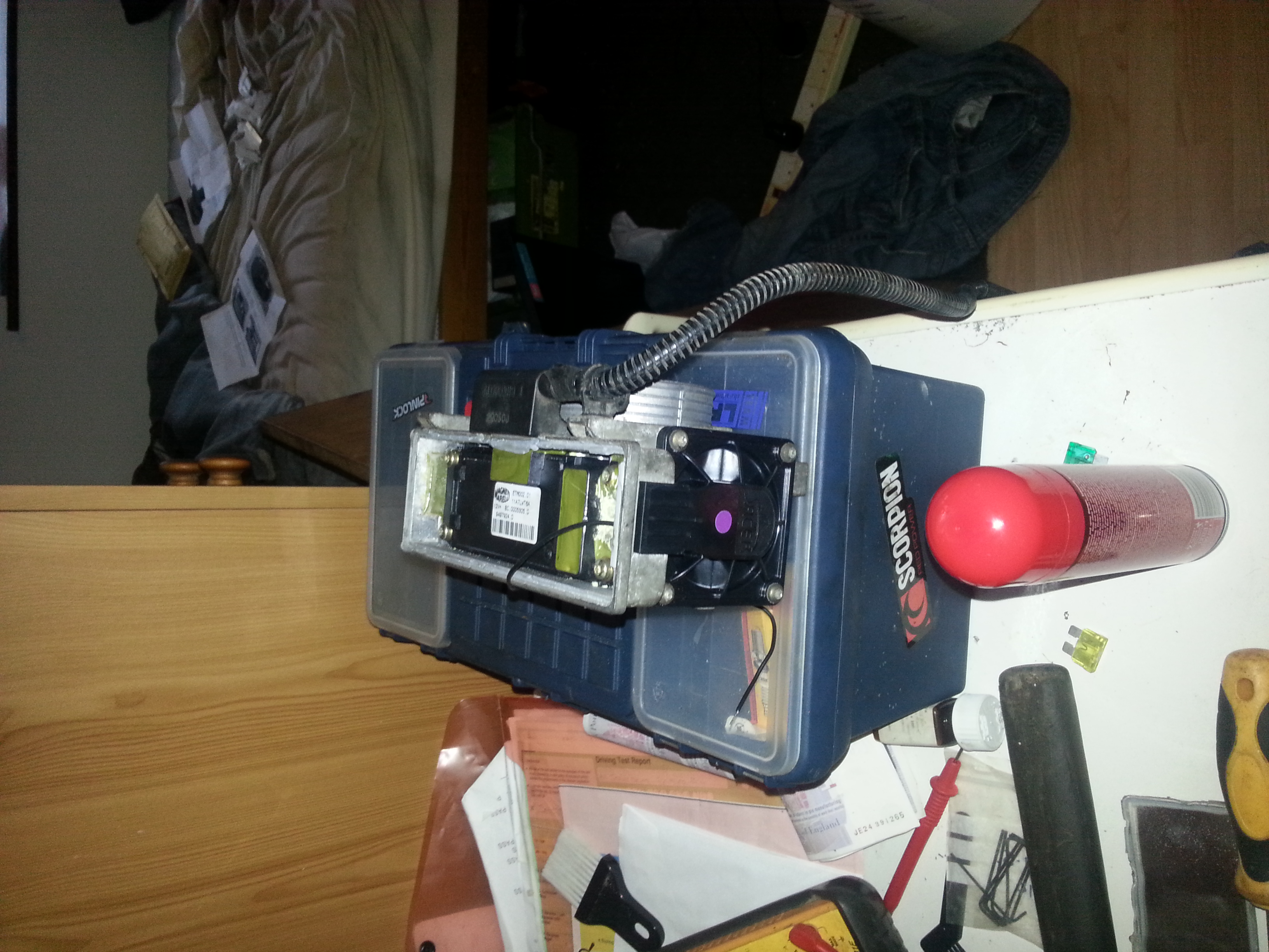

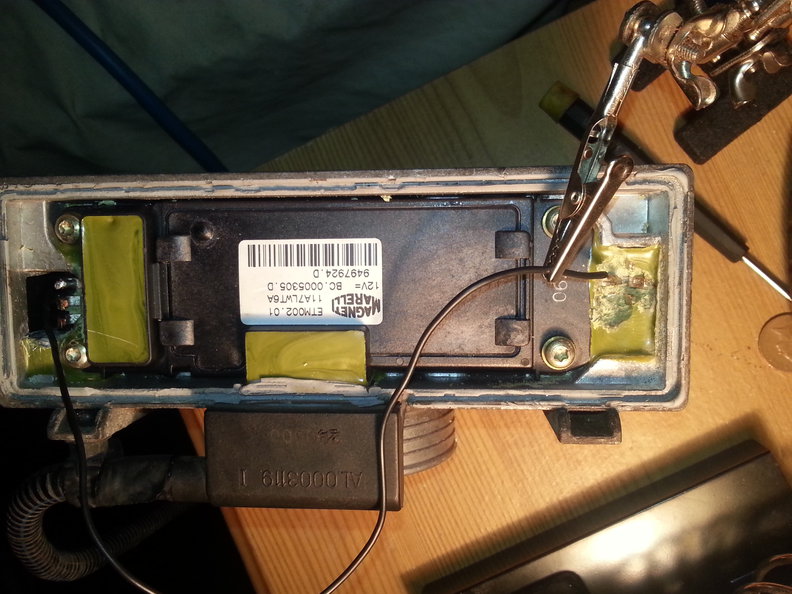

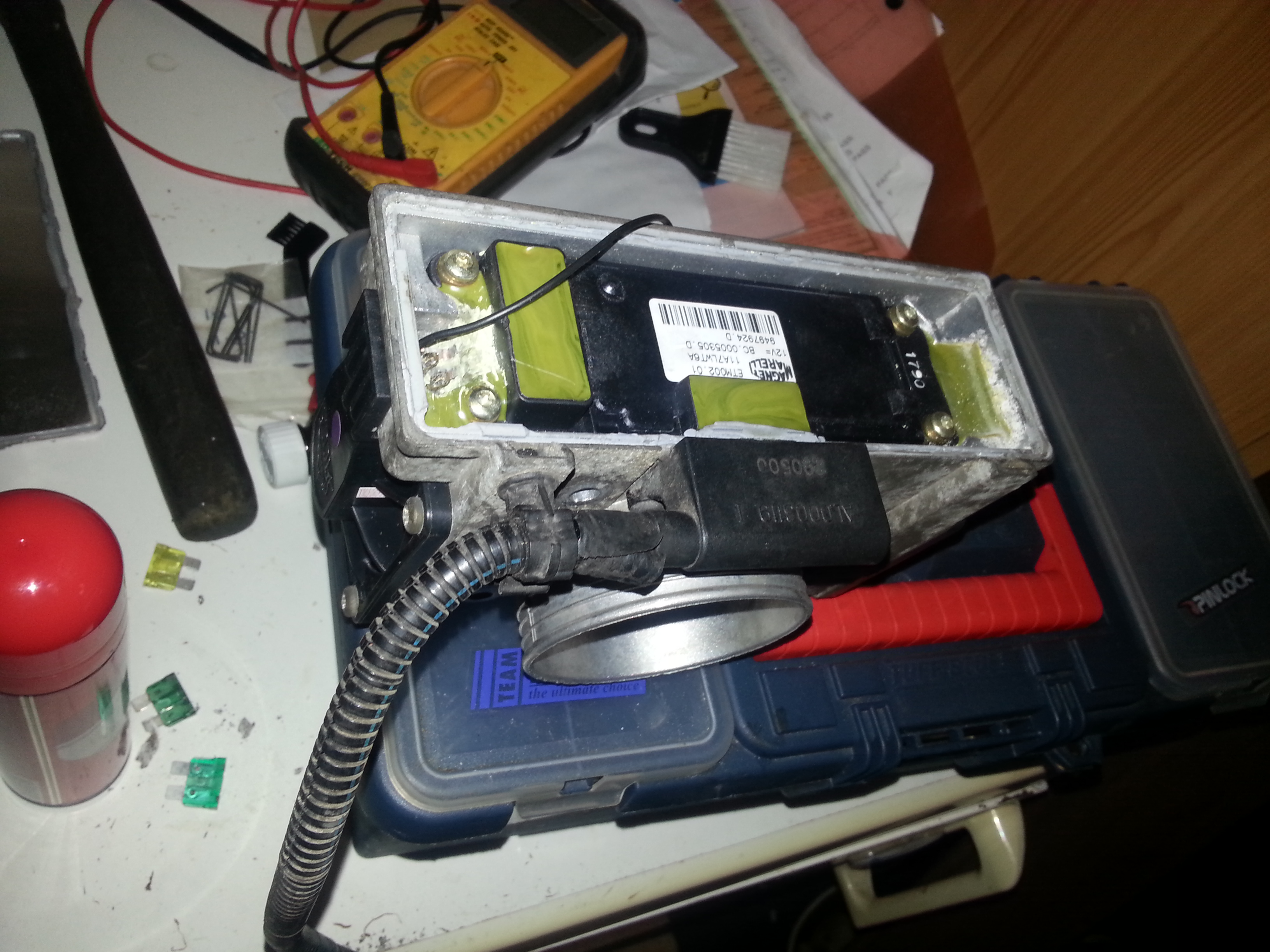

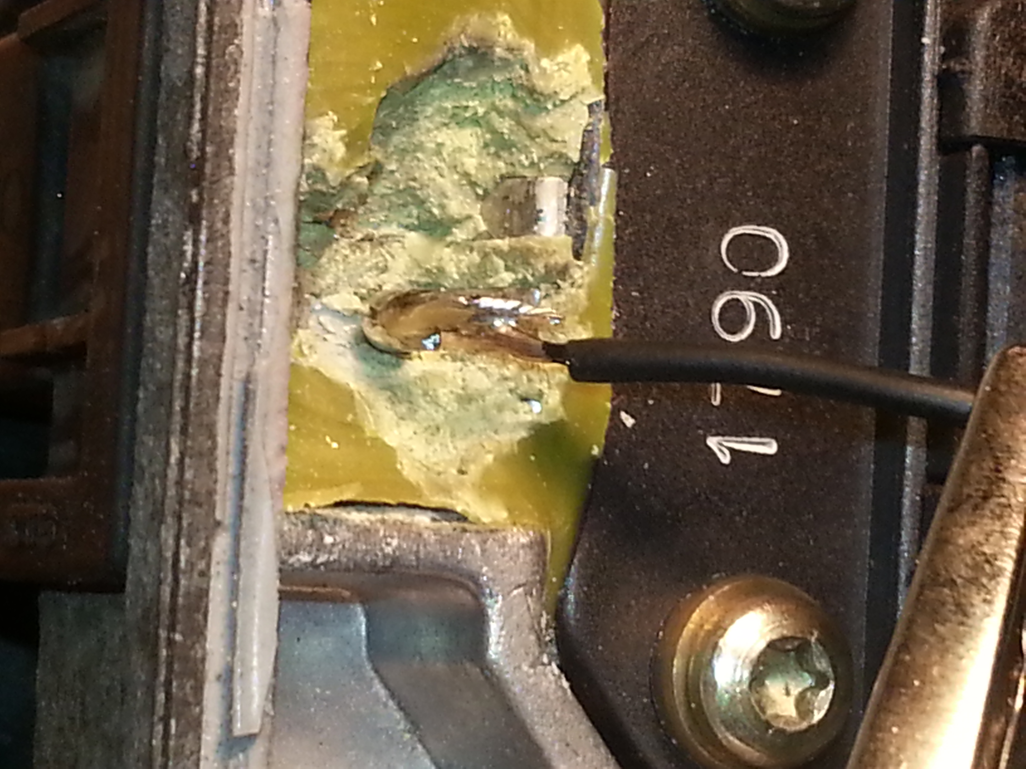

Well the problem is pretty much sorted, I nearly gave up thinking the problem was with the ecu but thankfully to this site and the top notch advise I have got I attempted fitting the contactless sensor to the etm.
results are amazing not once has it gone into limp mode since fitting and I've really tried to make it happen, also nice feeling what these cars have to give, though I feel its not all she has to give im thinking running it like it was for so long it probably just needs a really good service which is my next job.
some pictures of the install.
