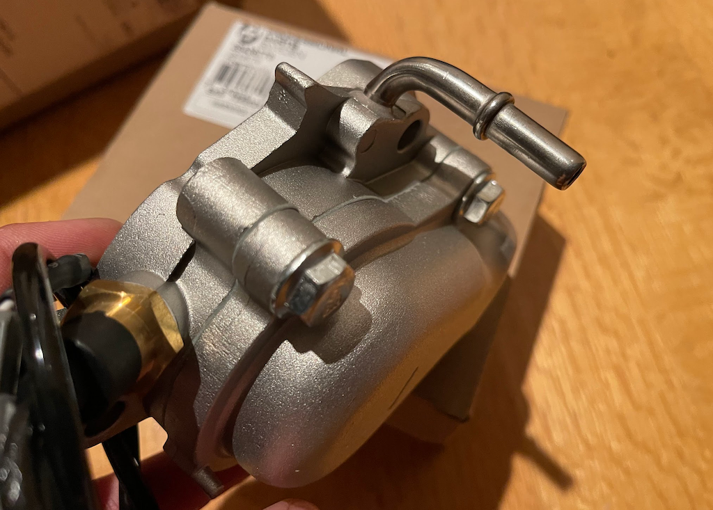

abscate wrote: 22 Apr 2020, 10:27 Are there good part numbers to which to index this thread??
I recently came across a Professional Parts Sweden Thermostat Housing which fixes the plastic breather breakage problem!
I ordered mine from PartsGeek for about $82.
2004 Volvo XC90 Thermostat Assembly
Brand Professional Parts Sweden
SKU W0133-166156
Thermo Housing with Metal breather.
ThermoHousing Top.png (1.15 MiB) Viewed 275 times
It looks to be the answer to that crazy OEM design.
My brass "permanent" fix started to weep lately. It's been many many years, but since this replacement exists now, I'm putting it in.
