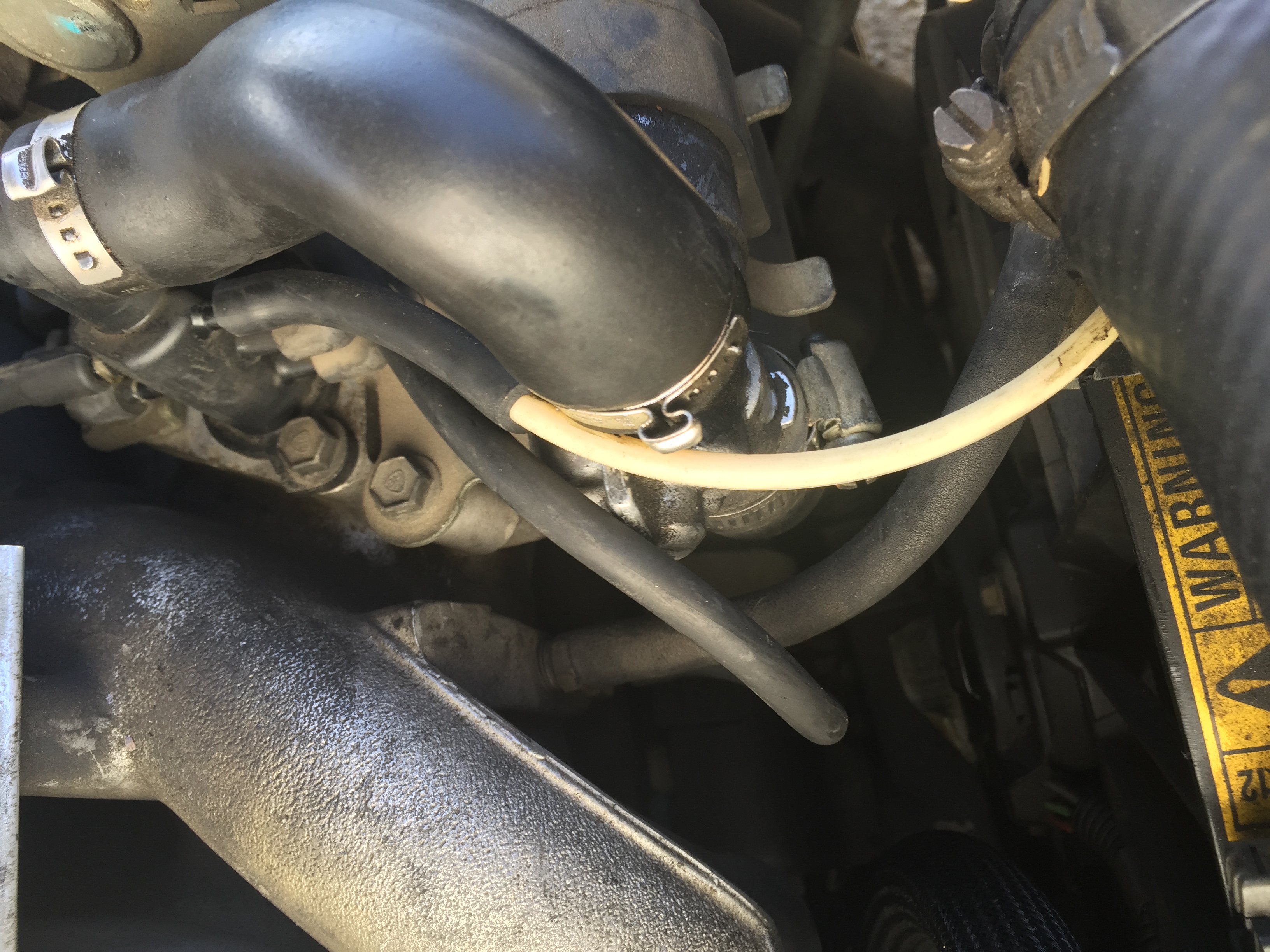

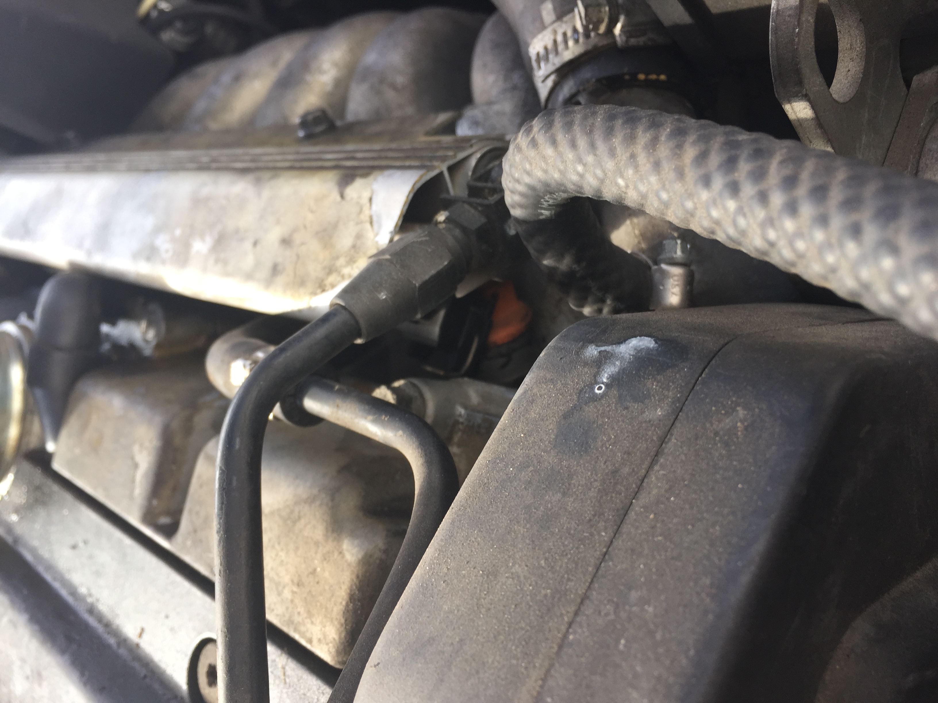

Where "here"?socalover wrote:Also when he sprayed cleaner here it made the idle climb.
Btw,you found a problem or at least one of them.
