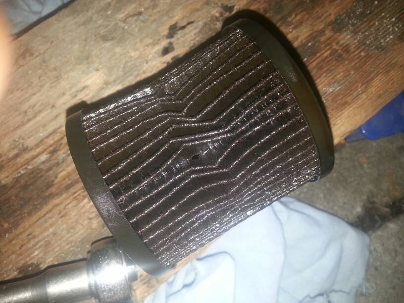

Just a cautuon about the WS series Bosch oil filters inserts they have collapsed on both of my cars meaning they may not seat properly against the housing or engine and the most recent one had 2 sizable holes in the filter media after 10,000kms. See my maintenance log entries.

Thanks again, Mike! I will look for some heat resistant conduit right now!!!precopster wrote:...That wiring under the spark plug cover will crack and perish before long if you don't restore the plastic conduit. ... the WS series Bosch oil filters inserts they have collapsed on both of my cars ...
Hoping your baby survived the leaked oil filter issue! Bosch spareparts have not so good reputation here, their standard spark plugs are not preferred by the local mechanics.

I had the same experience with the yellow box Bosch oil filter. I bought 5, used 2. The other 3 went in the garbage bin.precopster wrote:
Just a caution about the WS series Bosch oil filters inserts they have collapsed on both of my cars meaning they may not seat properly against the housing or engine and the most recent one had 2 sizable holes in the filter media after 10,000kms.

Yep exactly where they belong
