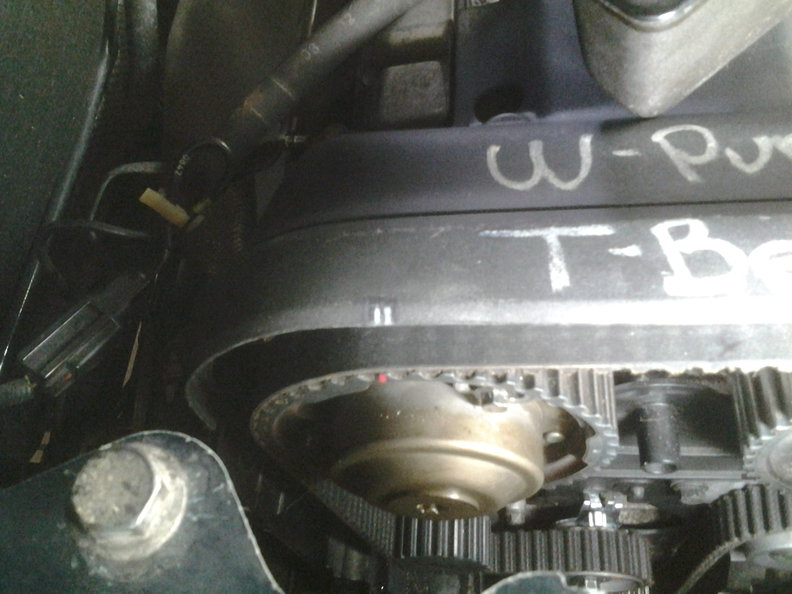

Ok so I tried both instructions , The bolts are in the center of the sprocket.
And the hub is at the limit to the left and the mark is a half a tooth on the left...
Intake is fine... going to rotate it a few times and see what happens...
be patient old crippled guy here.....

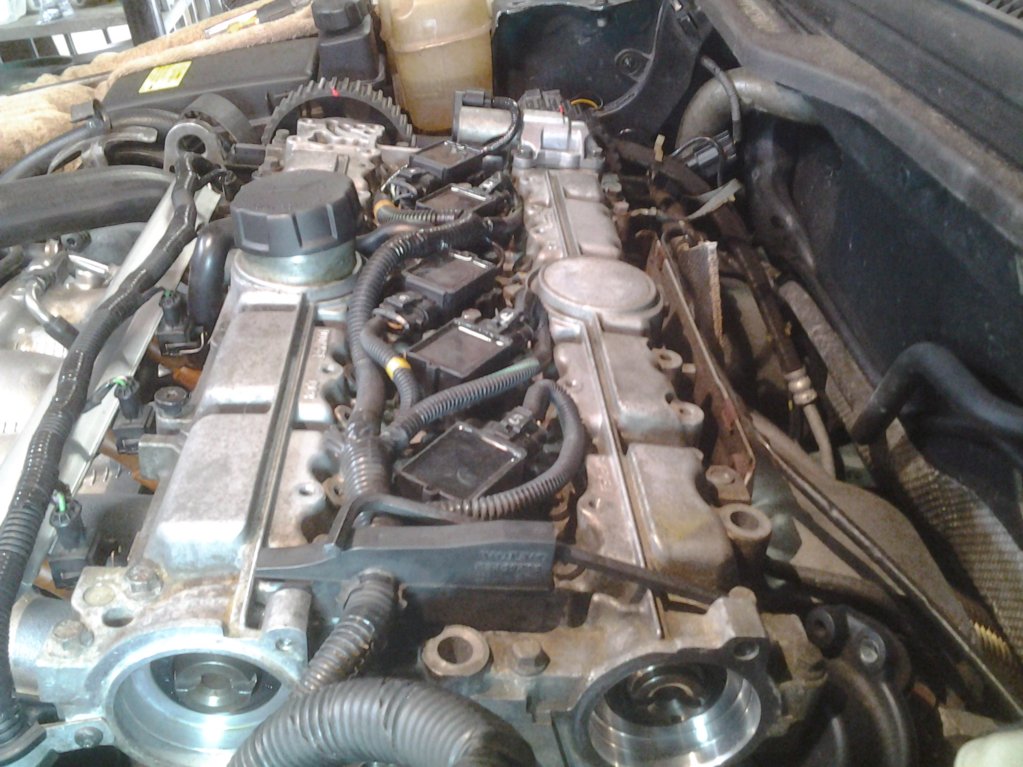

Can you post pics of front and rear marks, for rear if intake is horizontal just post exhaust and get camera or phone in front of it?

Best I can tell it looks like exhaust has a slight angle which is good. The front is pretty close too. Can you just take belt off and rotate exhaust cw one tooth to see if they line up? One note on the vvt hub: if you loosened the 3 screws and changed position of hub need to make sure when back cams are locked the exhaust sproket is to the left of cover mark and it can only turn by hand cw until lines up to cover notch. It should not go past cover notch.
