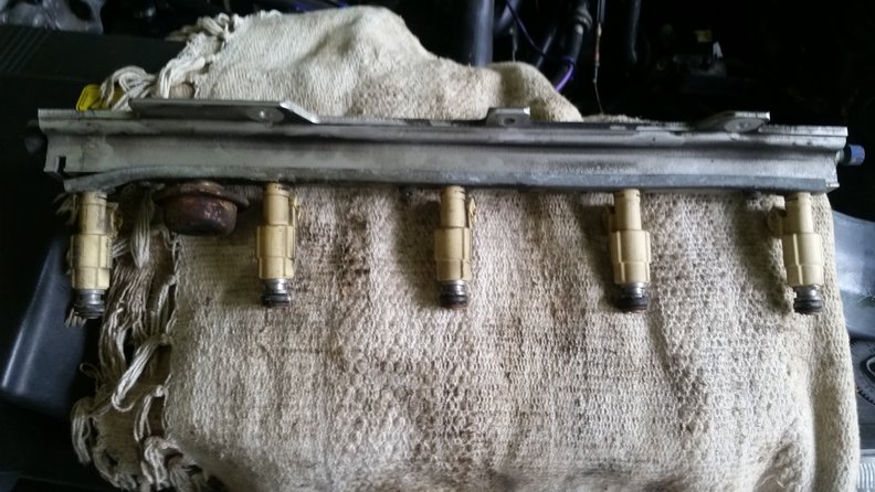

Ok, here is what I have. White injectors and a ecu out of a s70, T5 1998. Starting to come together.
I now have to figure out how to flash this ecu or get someone to do it for me......hint.....hint. I'm going to start cleaning everything up, replacing all vacuum lines that look even remotely bad. I also still need the gaskets to install the 15g turbo. I wonder if I should have it checked out. all seems fine but I'm no turbo expert so, I try to find a place to look at it.

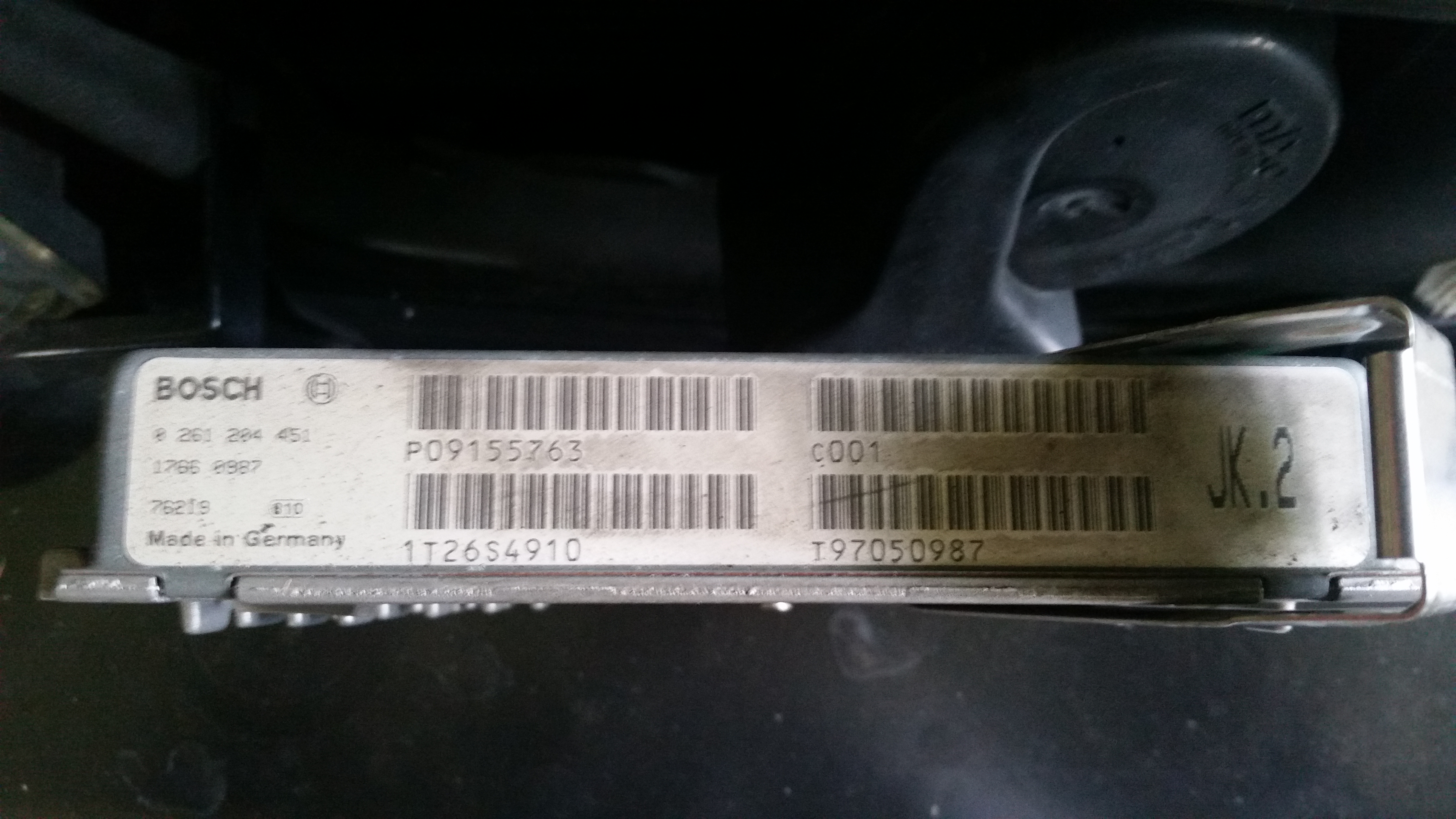

Missed your earlier post about the ECU: that's a good one, a 451 ECU. And those are the matching white injectors, yep.

Well, I'm getting there! I appricate all your help and knowledge. I will be sending you the ecu shortly. I'm also going to get the cord so I can play around with the tuning after i get it running again. I don't know how much I'm going to get done this weekend, Its a holiday after allerikv11 wrote:Missed your earlier post about the ECU: that's a good one, a 451 ECU. And those are the matching white injectors, yep.

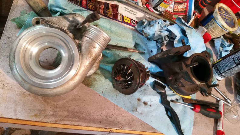

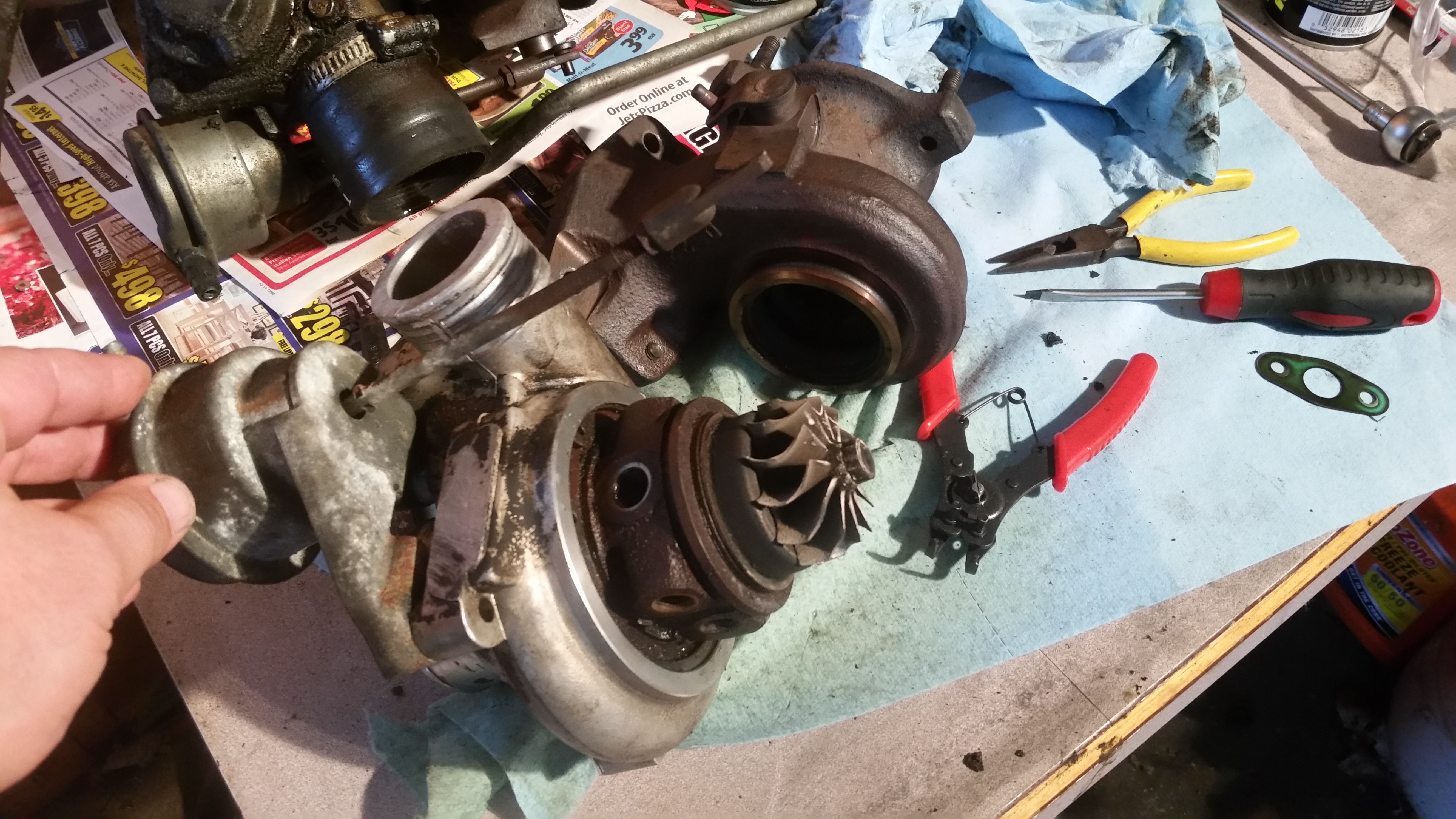

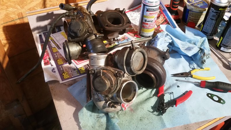

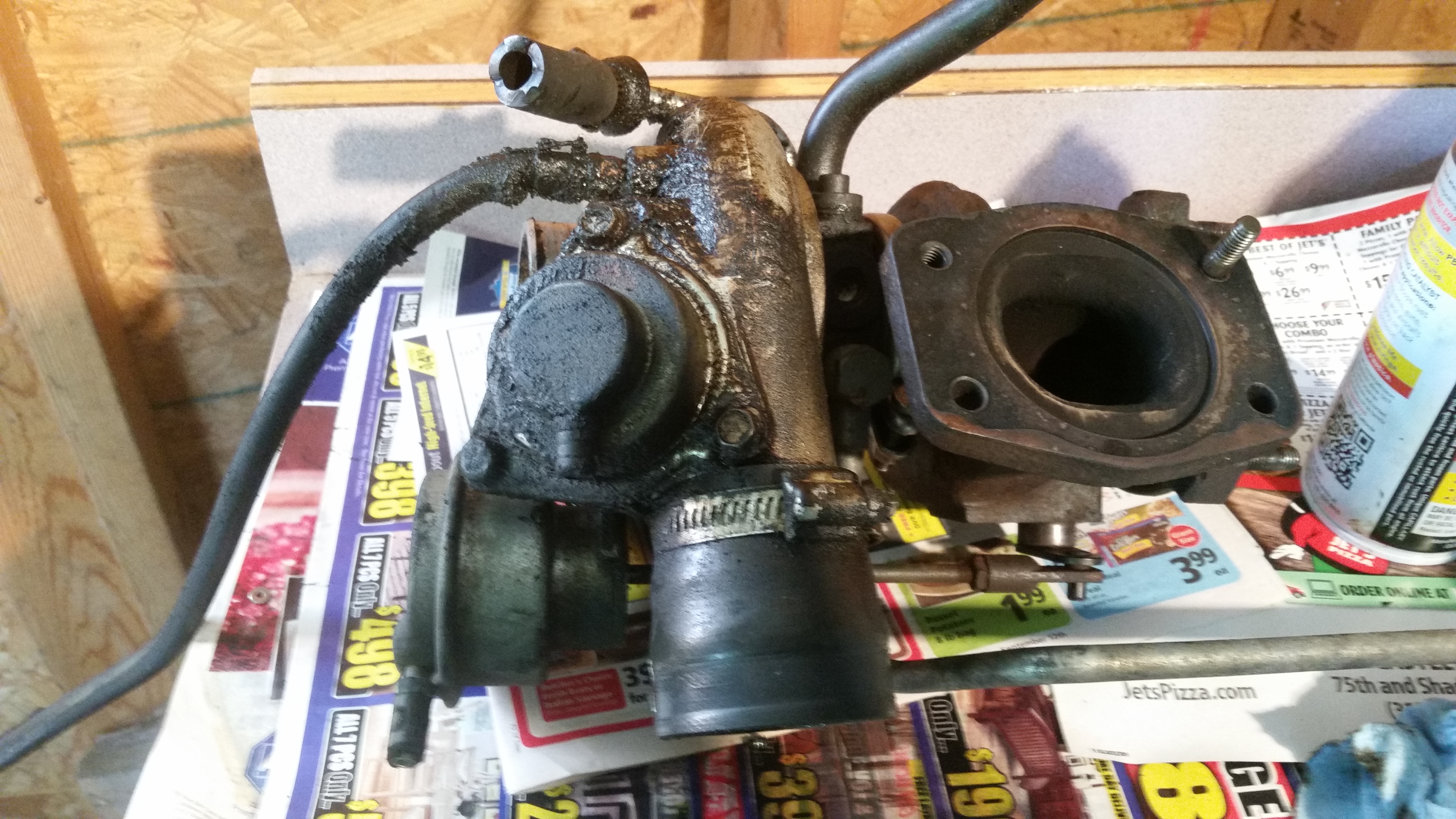

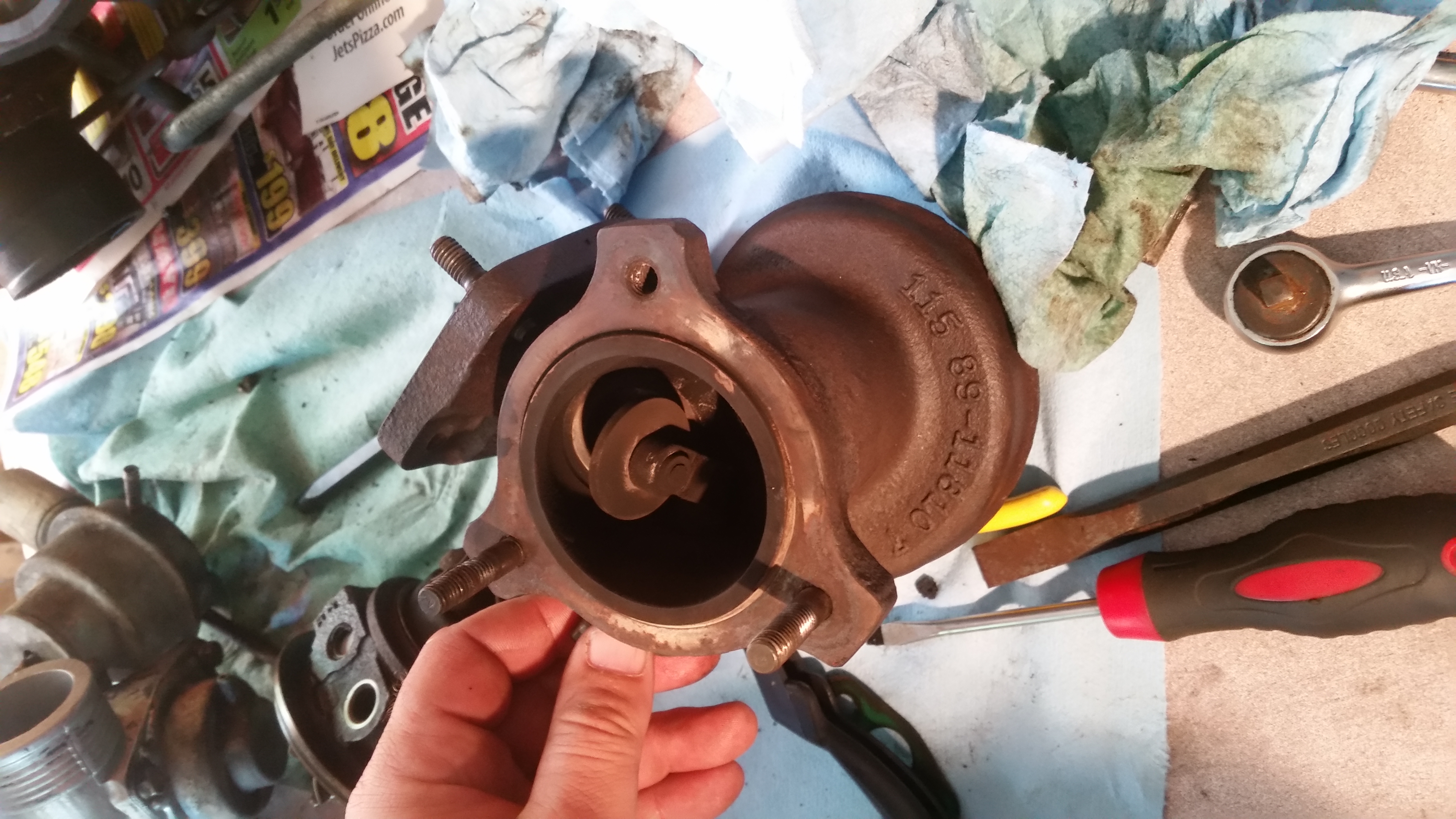

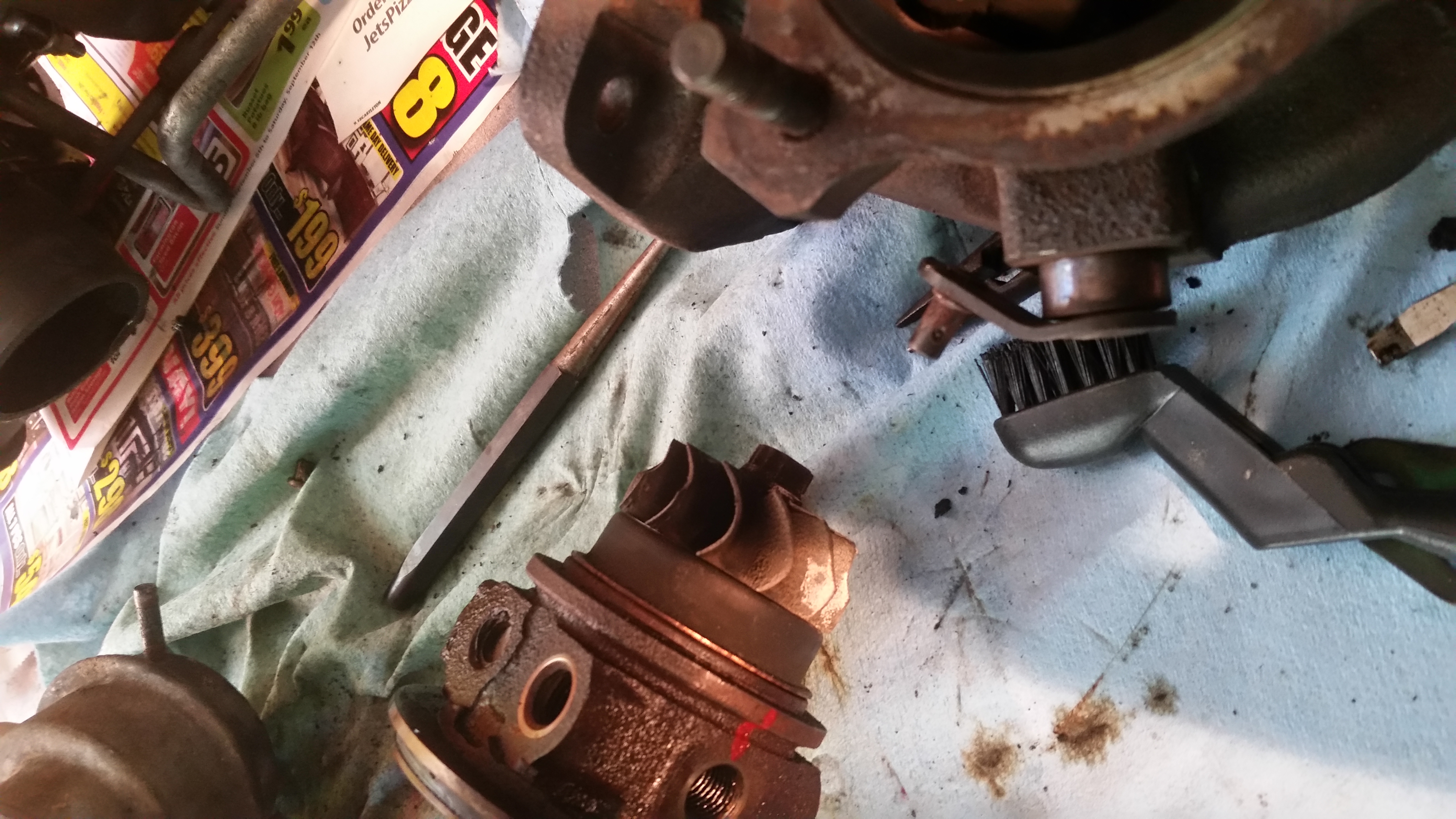

So here were I'm at with the turbo, and yes its getting a rebalance. This car is going too....
Im waiting n my rebuild kits and a manual boost controller this week, I can't wait. No cracks in the waste gate.
