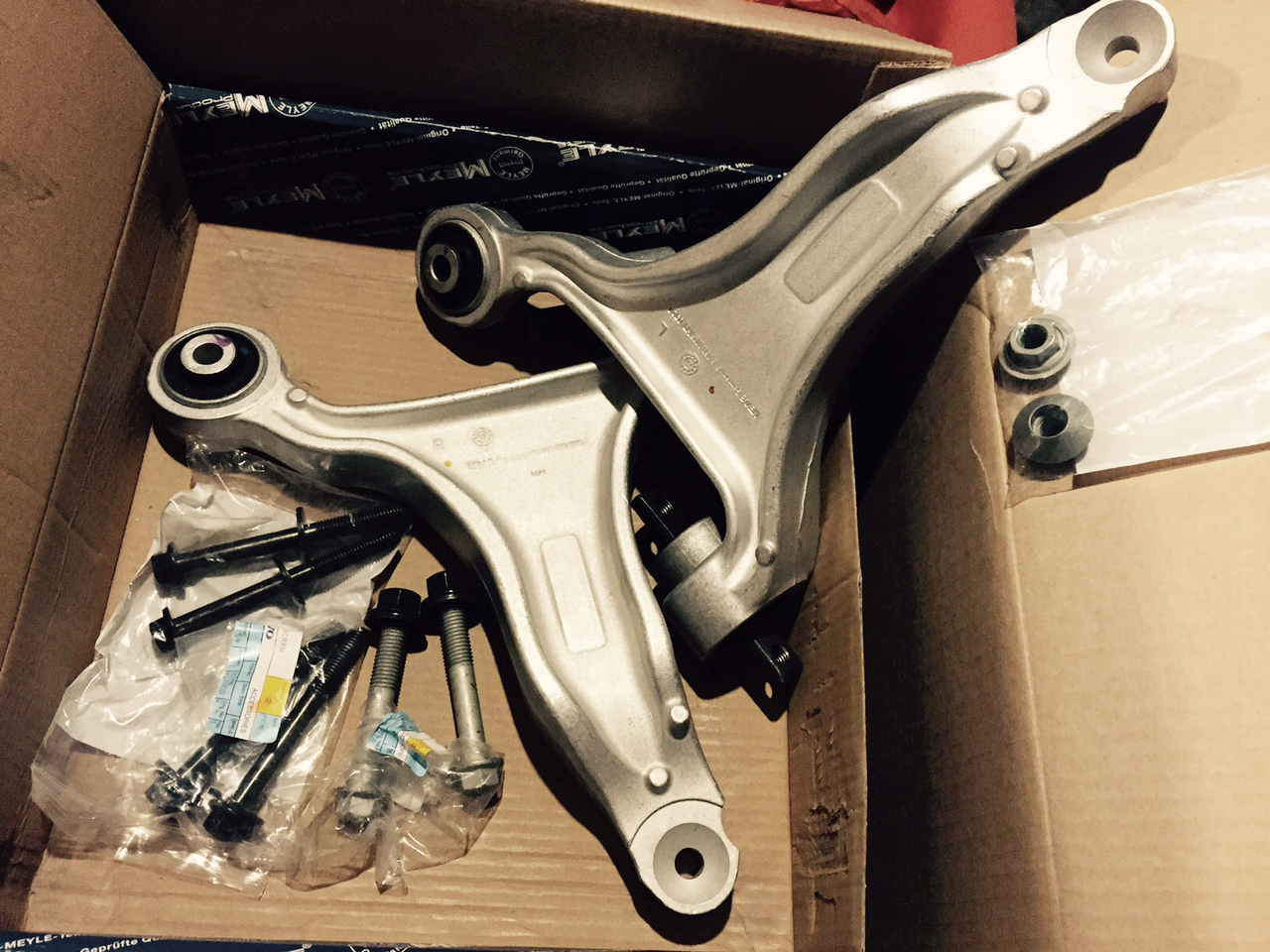

oragex wrote:They are stretch type. Interestingly, the ones on drivers side are shorter than the two on the passenger side. The bolts are cheap, about $15 for all four.
Thanks!
LCA will be installed with all new fasteners.
VIDA says to use new Sems nut on ball-joint too.
All ordered for $30
985226 Flange Screw x2 $5.22
985660 Flange Lock Nut x2 $5.60
987455 Sems Screw x2 $4.16
987456 Sems Screw x2 $5.22
31201020 Sems Nut x2 $8.10

After considering Volvo's and Lemforder, giving IPD/MeyleHD another chance to live up to what it sells.
Purchased new set of Meyle-HD from IPD to avoid down-time. I will return the failed ones for a tentative promise from IPD for defective part covered under 4-Year Warranty, i.e., get my money back.
Fasteners from local Volvo.
LCA - MeyleHD
LCA - MeyleHD

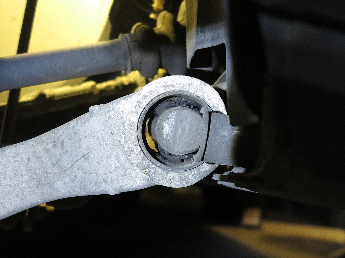

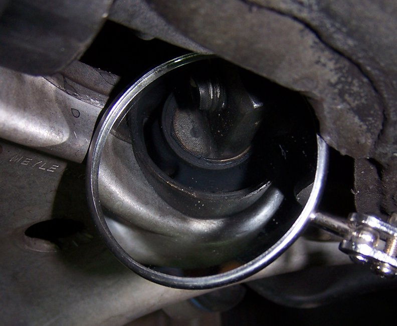

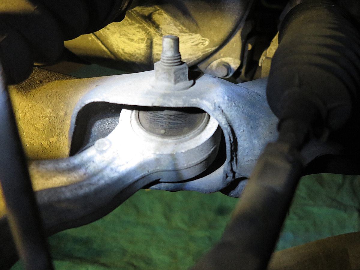

Few photos of failed bushings:
Rear Bushing
Rear Bushing
Front Bushing
Front Bushing
vtl
Posts: 4724
Joined: 16 August 2012
Year and Model: 2005 XC70
Location: Boston
Has thanked: 114 times
Been thanked: 604 times
Post by vtl »
Do you think that the rear bushing has failed? I replaced 12-yo OE bushing in same condition with Meyle, it got similar tears just in a few weeks.
Front bushing is dead for sure.

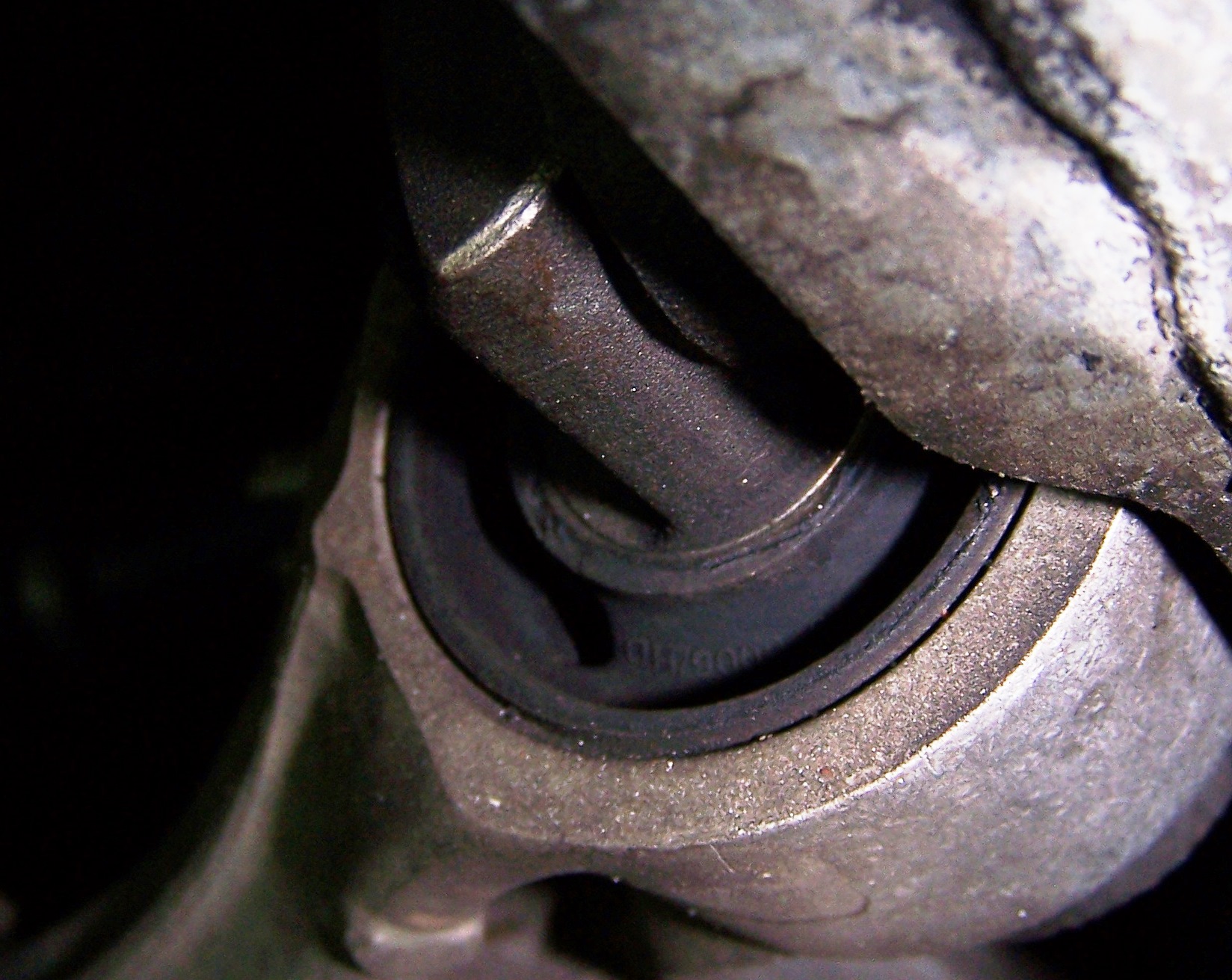

Here is the driver's side rear, vtl - the tear is much deeper. The car is on jack-stand, and wheels removed.
Rear Bushing - Drivers' side
oragex
Posts: 5347
Joined: 24 May 2013
Year and Model: S60 2003
Location: Canada
Has thanked: 102 times
Been thanked: 352 times
Post by oragex »
These bushings are kaput
xHeart
Posts: 3306
Joined: 3 December 2011
Year and Model: 2.0/3.2
Location: Great Lakes - USA
Has thanked: 113 times
Been thanked: 115 times
Post by xHeart »
A more accurate description would be like steering sway side-to-side when going over manhole -- rattled each time.
Excessive LCA deterioration would result in ball-joint failure at end-link, knuckle, and tie-rod.
I am looking at replacing outer tie-rod next. Perhaps overhaul the rack itself.
Costly if not detected and fixed.

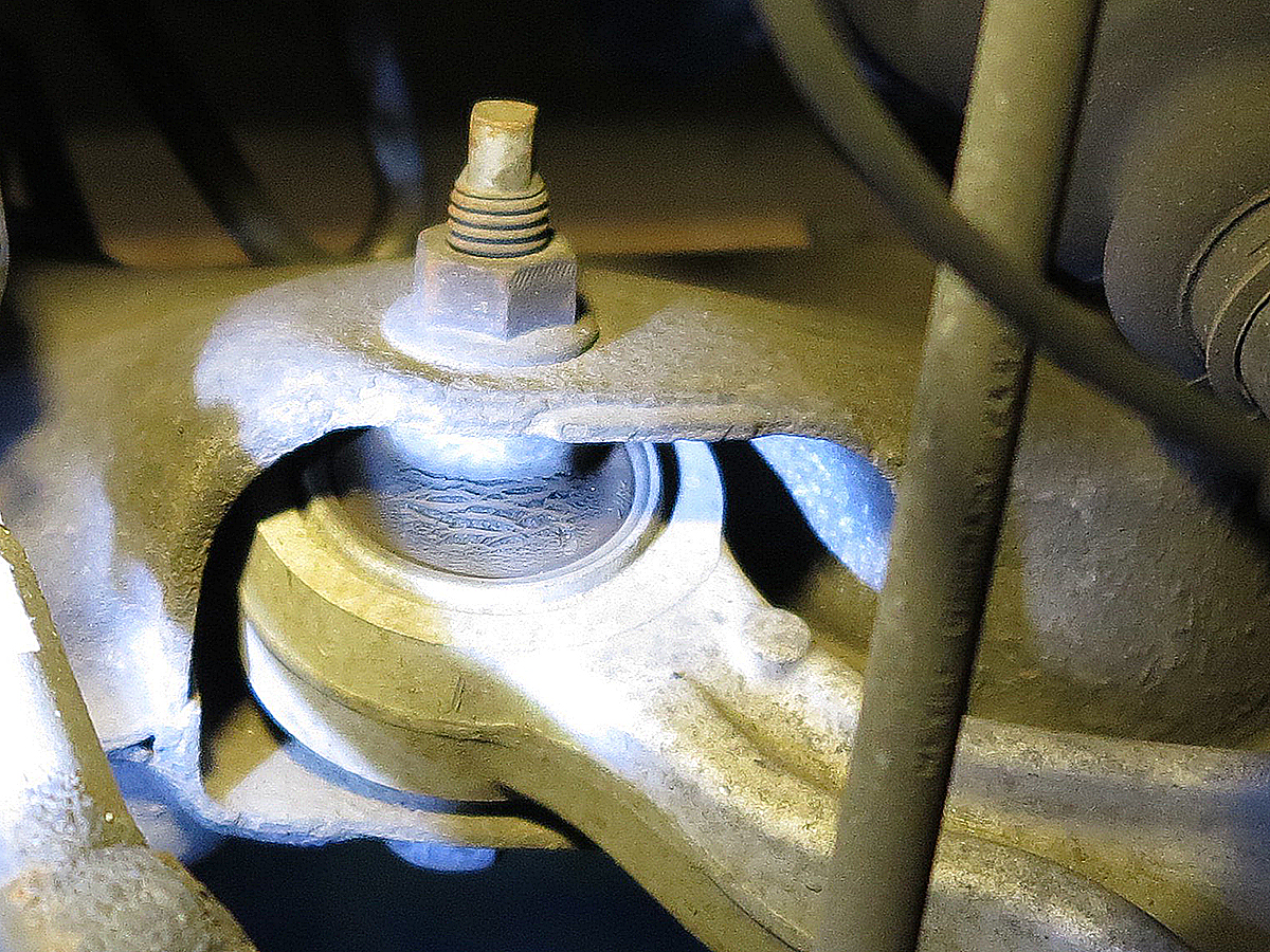

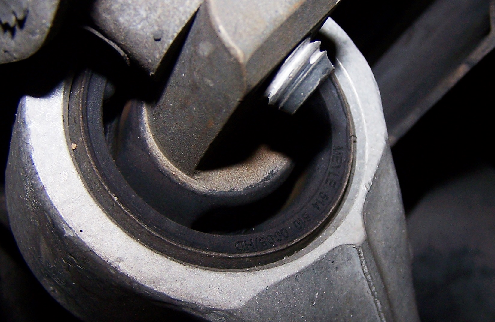

Post by regent »

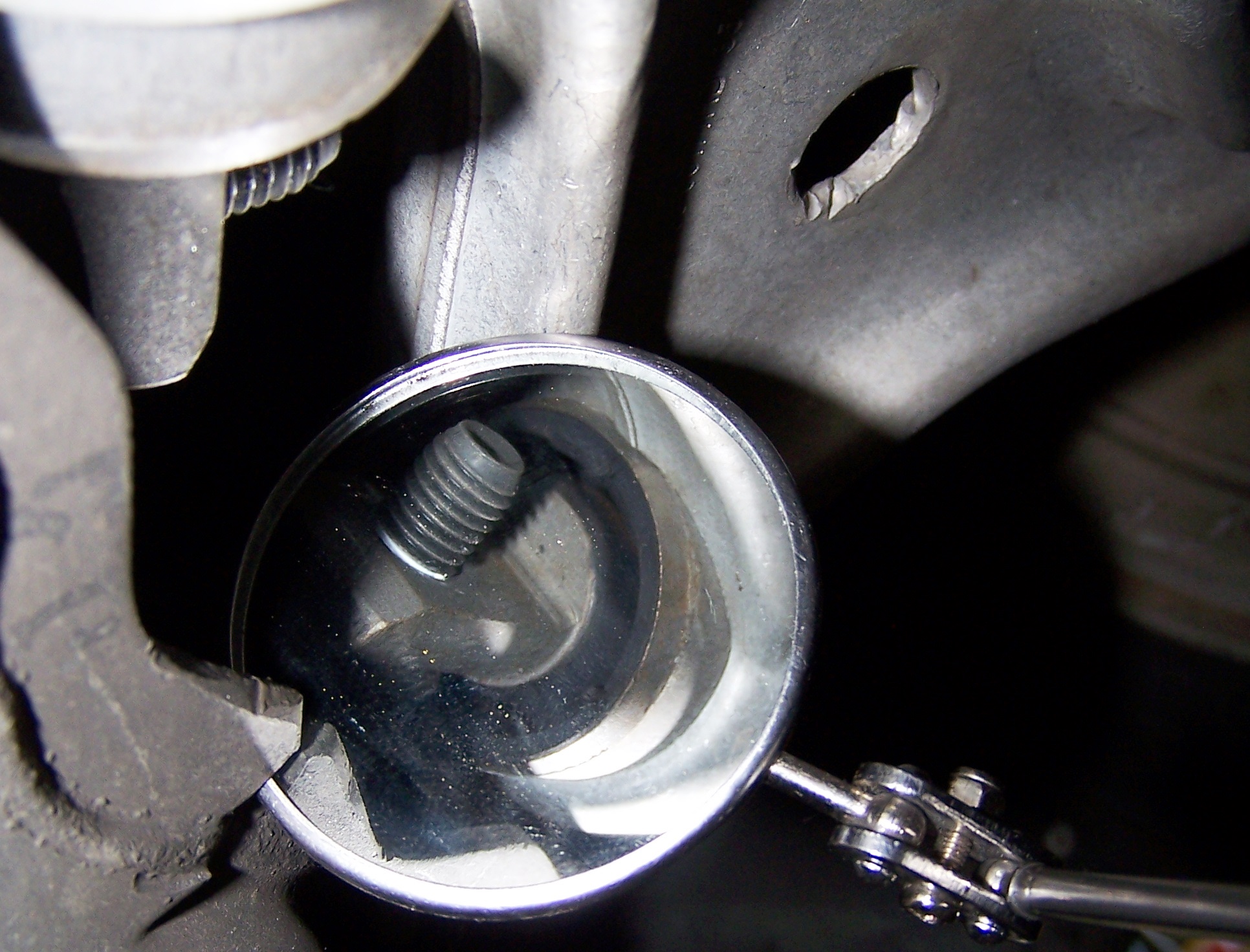

OK,
We did see something good. All bushings seem fine to me on visual; the 'fantastic new car' feel is still present. Overall: Happy camper :D
Pictures of the front bushings on the CTRL Arms only (as much as I could shove my old garage camera in). The ones I took on the rear bushings did not come out clear enough to post. Sorry...
I hope I'll take better pics when I get to drop the wheels for the brake hose replacement next weekend or so
Driver Side Front Bushing # 1
Driver Side Front Bushing # 2
Passenger Side Front Bushing # 2
Passenger Side Front Bushing # 1
