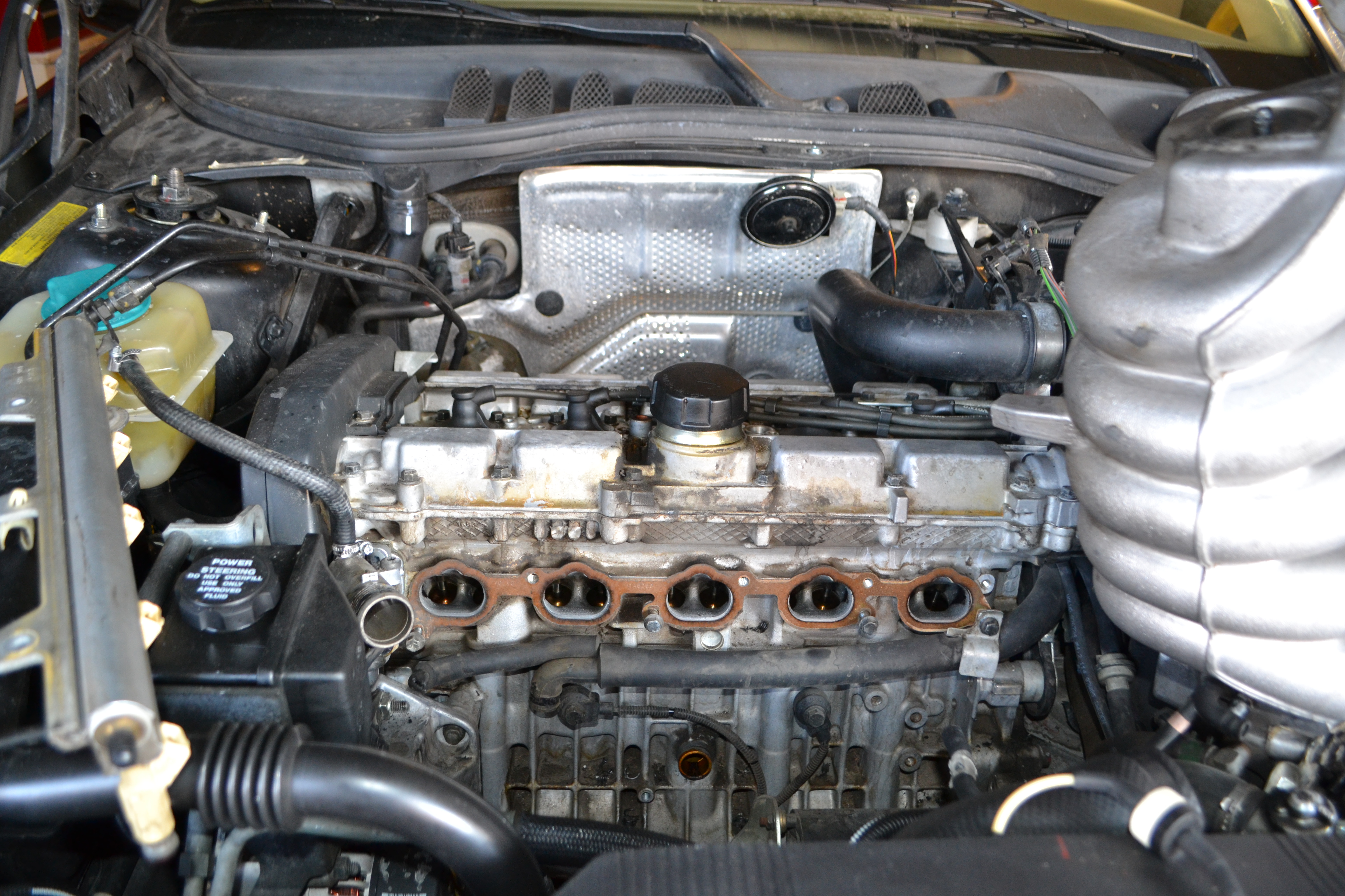

I had a similar issue with my 98 v70 t5 after doing the pcv. My problem was I didn't get the bracket that holds one of the hoses in the pcv system in place on right. The bracket was on driver side and is behind the intake manifold. If you mess this up the IM will pinch the hose and won't seal. I got a gas smell and the car wouldn't idle at all. I could see the pinched hose if I looked right at it, but would have had a hard time taking a picture of it. RSPI helped me find the issue and he has a warning about this problem in his DIY video on YouTube.
I'm pretty sure that this is what Erik is talking about. If this isn't your issue my guess is that IM isn't sealed in some other way.

Here is a picture of the hose and bracket I am talking about. This picture was taken before I took the old PCV out. When I put this back together I got the bracket that is holding the PCV hose on the right (driver) side pinched between the block and the IM. I had exactly the same symptoms as you. I took everything apart, got that hose and bracket installed properly, put it back together, and the car ran smooth as silk after that.

Kudos to Charles for a much better description and an image to boot, that is the bracket I was referring to. They come in a couple different shapes but all can get in the way.

I was so excited to try that, but when I looked, my car doesn't appear to have that bracket at the right-hand (driver) side of the manifold holding the hoses down. From what I could tell, the PCV hose moves OK and doesn't seem to be pinched by the manifold, at least on that side.charleskennedy23 wrote:Here is a picture of the hose and bracket I am talking about. This picture was taken before I took the old PCV out. When I put this back together I got the bracket that is holding the PCV hose on the right (driver) side pinched between the block and the IM. I had exactly the same symptoms as you. I took everything apart, got that hose and bracket installed properly, put it back together, and the car ran smooth as silk after that.
Guess the manifold is going to have to come off again. ...
