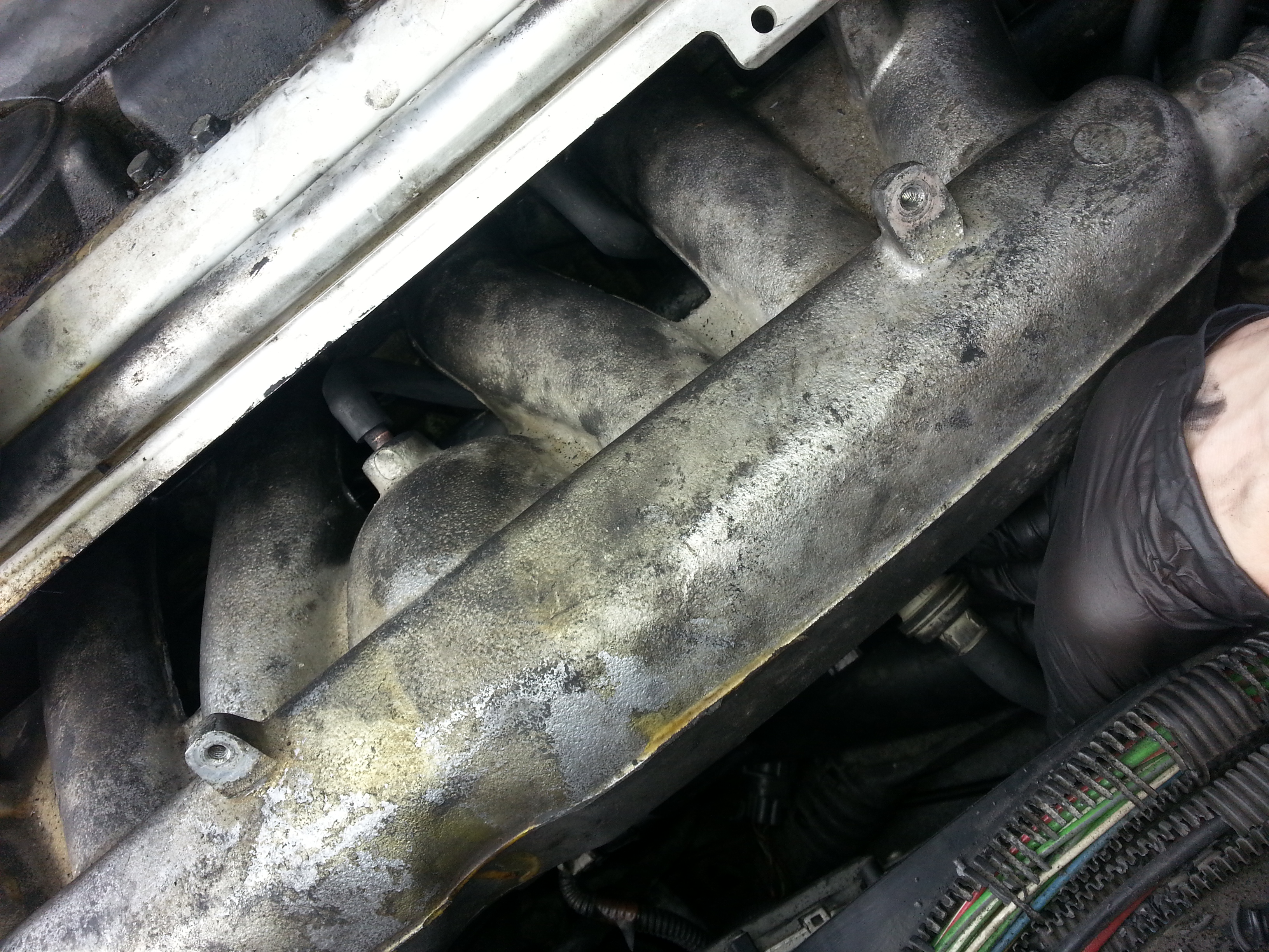

Thank you for the reply,
I did not remove the ETM from the intake manifold, although the intake manifold and ETM was cleaned with carb and choke cleaner, B-12 chemtool to be exact, which was a NAPA suggestion.
Could the issue be that the gasket was not changed or that the intake manifold was rather well sprayed with Carb cleaner? the buddy I had helping did the cleaning and did so garden hose style...

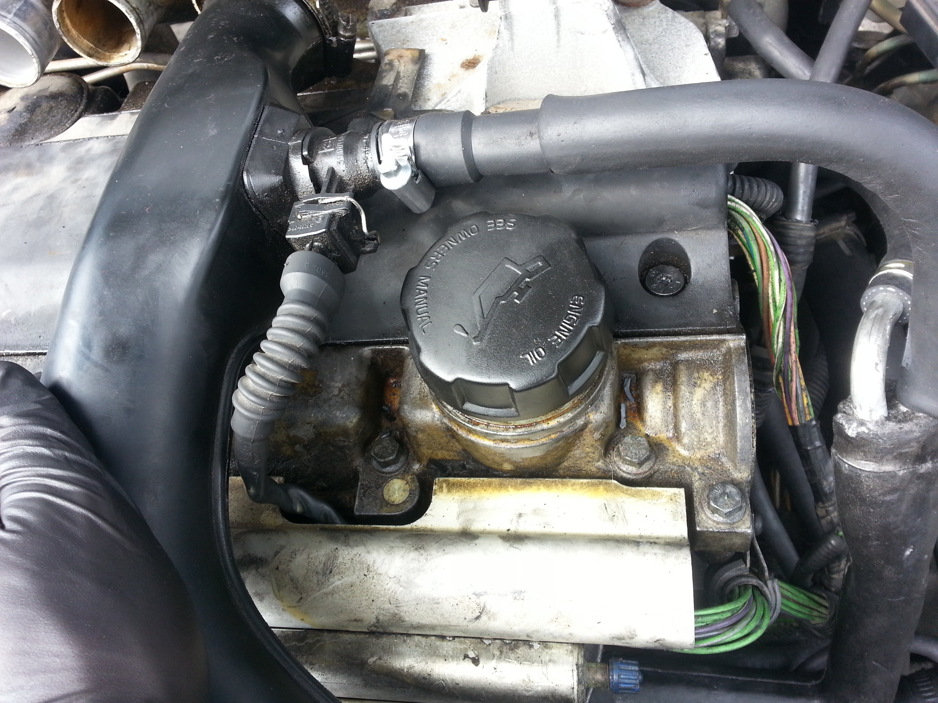

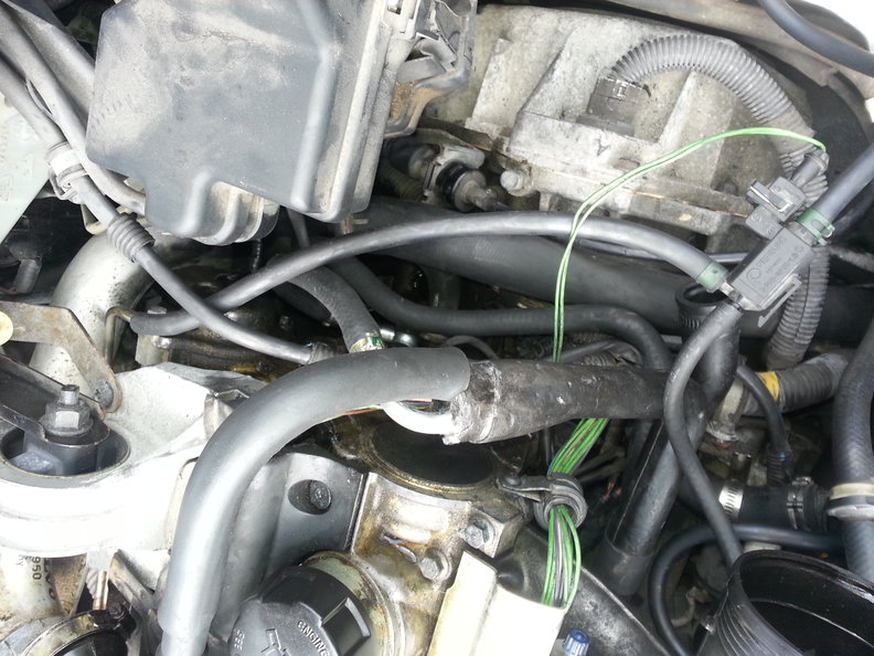

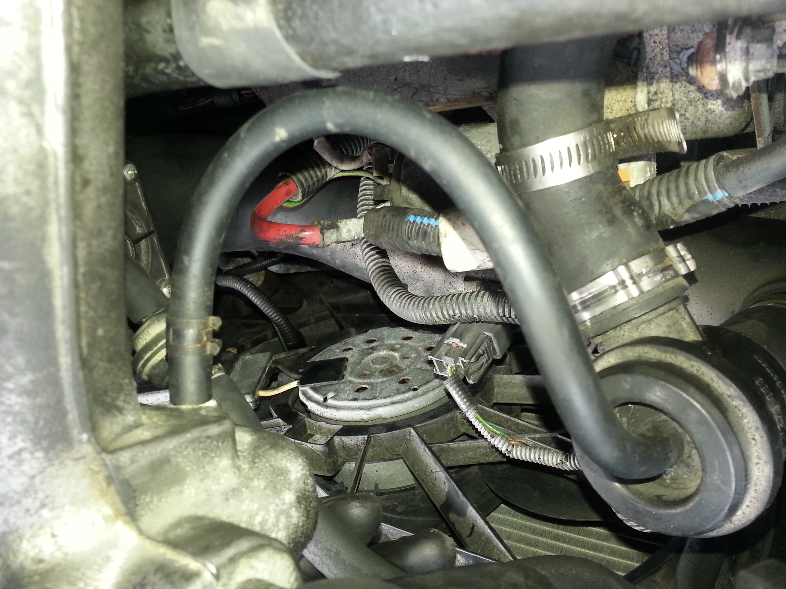

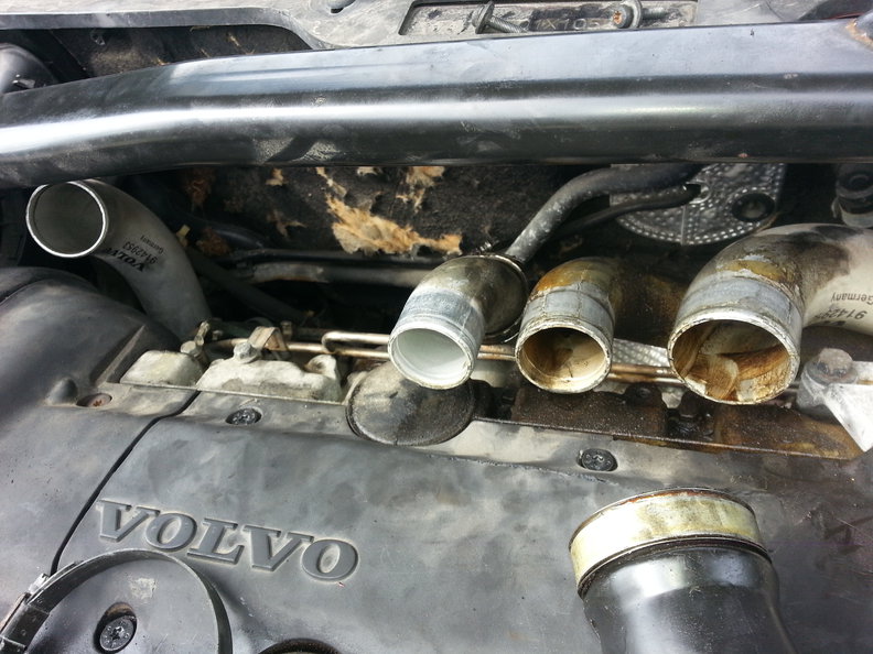

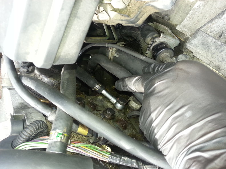

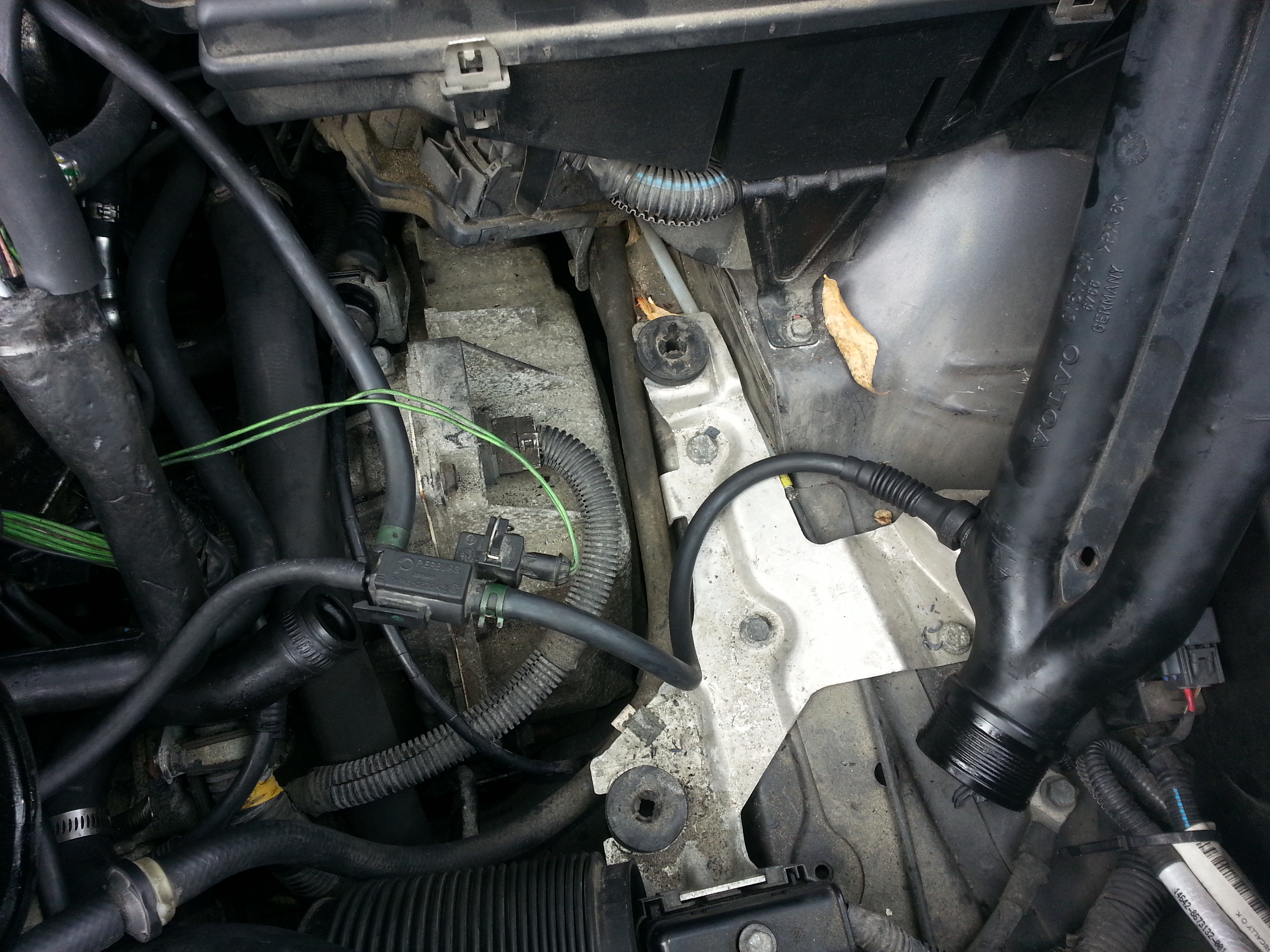

Also I will be posting pictures of the vac lines and such that I had to disconnect and reconnect to make sure that I got all of those reattached properly.
Thank you again for helping.

The ETM is likely contaminated from all the overspray and excess cleaner. They can have entrance points to fluid at the block connector which then seeps to the contact strips.
Several DIYers have killed their ETM by flooding it with cleaner.
Check that the ETM initializes upon ignition turn on. It has a distinct click and whine which lasts for around 8 seconds.

Sure, post some pics and I'm sure there will be many that can check the routing for you.
