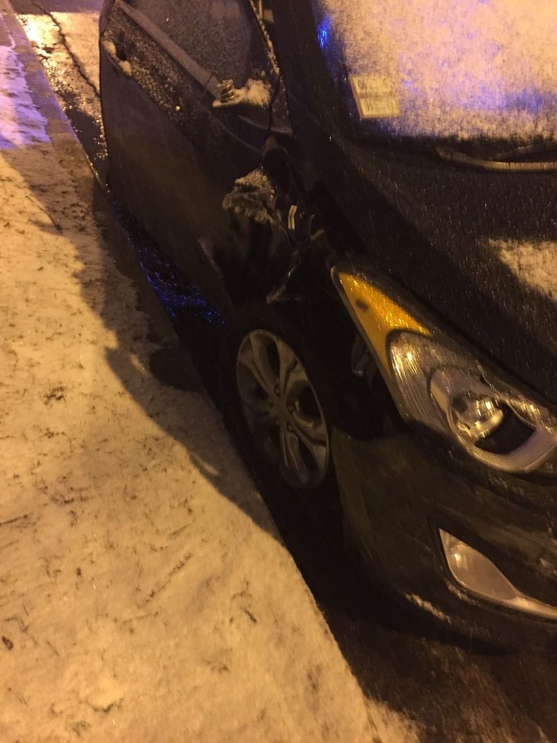

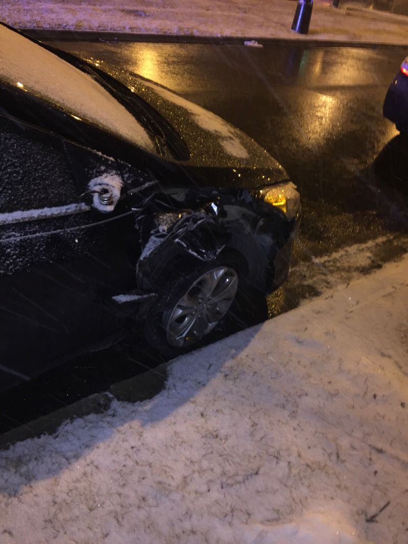

No huzzaba. My car parked. The other car was moving. He hit a anther car before hitting my car. After that, he tried to leave the scene but his passenger front axle was bent.
Here a few photos i took of his vehicle.

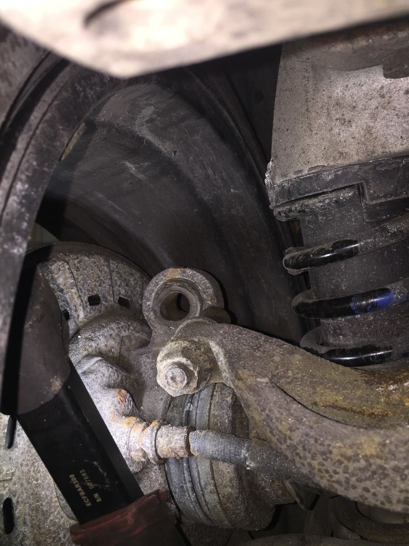

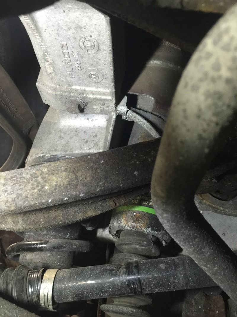

Don't bother trying to rebuild it, there is just to much damage. The subframe is cracked which to me indicates possible damage to the chassis leg / frame. At minimum the cars measurements would have to be checked on something like a frame straightener.
Upper control arm has torn the mounting bolt through the bushing on the knuckle, so the knuckle would have to be replaced as its a cast metal part. Forward trailing has damaged the bushings and is likely damaged itself, axle has been streched as the mounting clamp for the boot has come loose, stay arm is probably bent, list just goes on.
